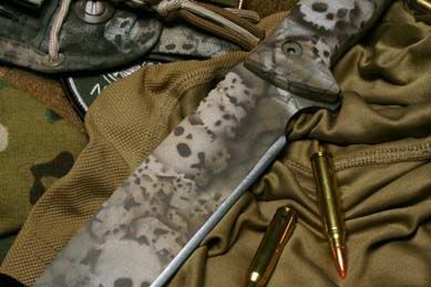

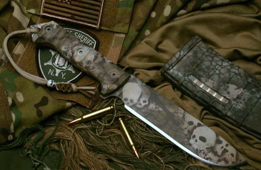

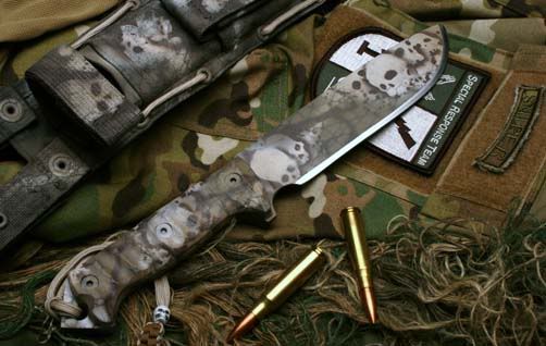

I took the plunge and now I'm hooked.
Here is Up-Armored Knives #1
Steel -1095CV 3/16" thick
Grind - Flat Saber
HT - By Peters Heat Treating 58-60RC
Blade length 6.5"
TOL - 12"
Handle - Laminated Birch (gun stock material)
Handle Connectors - Stand offs with machine screws
Edge - Convex

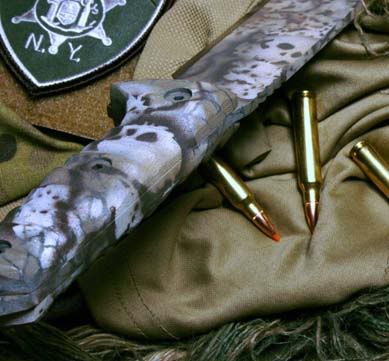

Finish - Duracoat in my Desert Skull Pattern

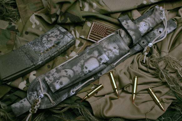

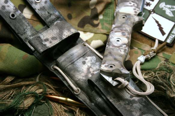

Sheath - Spec-Ops (also in Desert Skull)
What do you think?
All comments welcome
