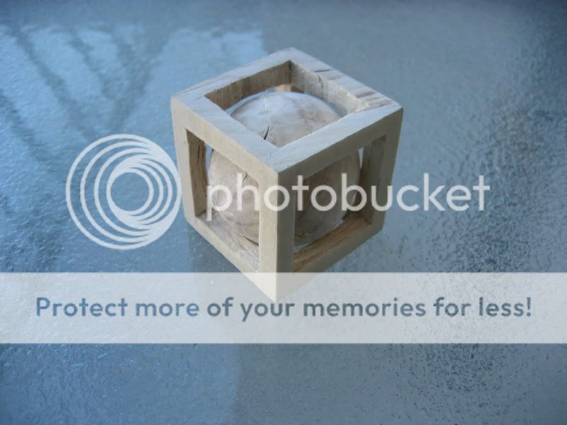

I have been really getting into traditional knives lately. I love the functionality and beauty of traditional knives. After seeing a few threads on whittling I have been wanting to have a go at it.
Here is my first attempt.
That's very, very good for a first whittling project. You have made your Case peanut proud. Looks like you two are a good team. - Ed
Thanks Ed. The peanut makes a nice detail knife. I used a Case sway back jack to score and cut the borders out when I penciled out the pattern. CV works pretty well on Basswood.
Maybe I'll try a chain next.

So, I have seen several of these types of art; can anyone describe briefly how you go about carving a captive ball like that?
I certainly have the knives to do it, just lacking the know-how and likely the talent, but willing to try....

Thanks for the kind words.
The wood I used was a 1 3/4" x 1 3/4" x 36 Basswood square dowel from Home Depot.
When I first began thinking of whittling I tried to sample carve a treated 4x4. The 4x4 proved to be too hard and grainy. The basswood was like butter compared to the 4x4.
Most ball in cages I'd seen were always rectangular and never knew why. I thought that a nice cube would be kind of neat and symmetrical. I quickly found out why most caged balls are rectangular. The reason is that it makes carving easier, you want to try and minimize as much cross grain cutting as possible (on flats especially). Most caged balls I've seen always leave the two cross grain ends closed, making for easier craving and truth be told, a stronger design.
Below are two links I found useful.
http://www4.gvsu.edu/triert/cache/articles/t2/bic.htm
http://www.littleshavers.com/Whimseys.html
