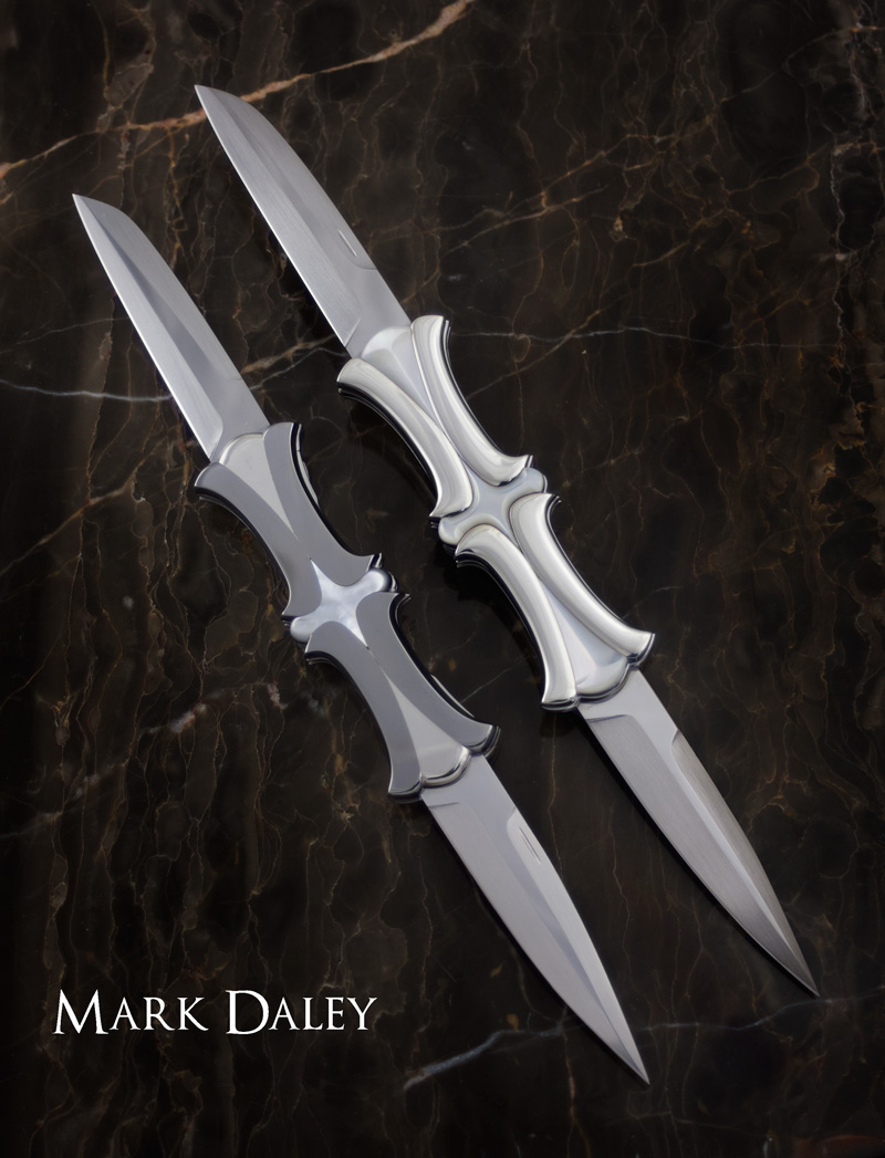

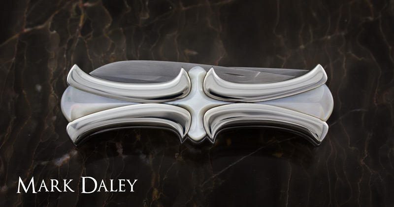

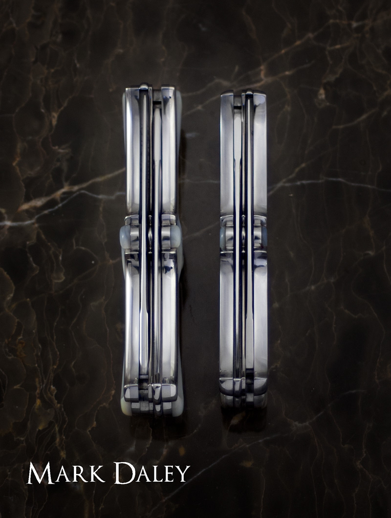

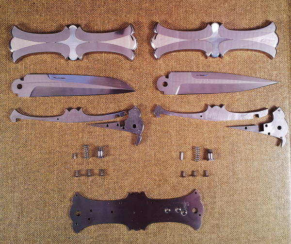

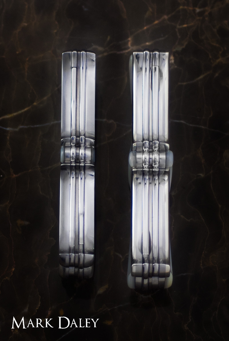

Here are two knives I have recently finished. In the early stages I had a mix up in printing the pattern and ended up with the liners shaped and drilled one size and the blades and backsprings slightly larger. After much cursing and investigating I think I must have said ok to the printer resizing the image. At least I wont do that again. So as to not let any of my work go to waste I made two knives.
The larger has sterling silver and mother of pearl scales. The rest of the knife is ATS 34 except the center liner which is titanium. 2 7/8″ blades and is 9 1/4″ overall open and 3 1/2″ closed
The smaller has sterling silver, mother of pearl, and mild steel scales. The rest of the knife is ATS 34 except the center liner which is titanium. 2 3/4″ blades is 9″ open and 3 3/8″ closed.
Both knives are lockback.
