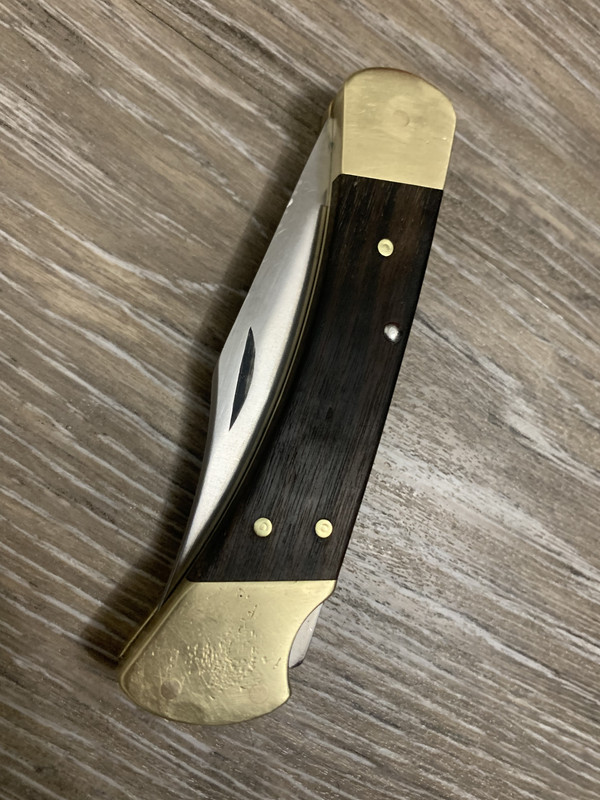

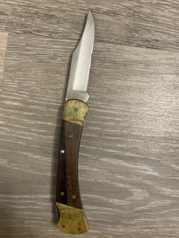

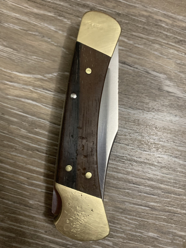

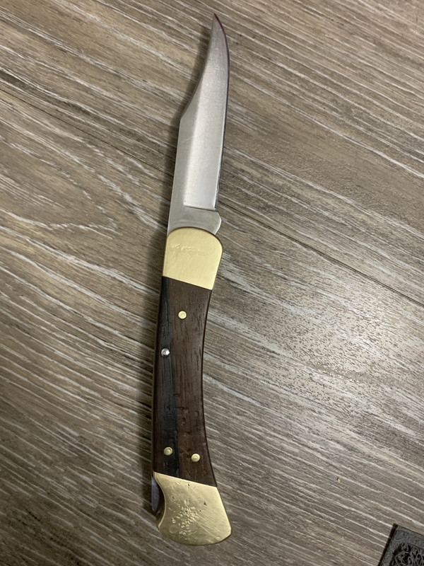

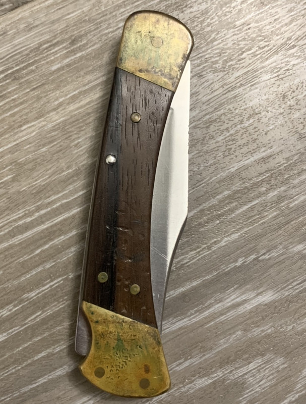

I saw an old 2 dot for a decent price and pulled the trigger. I sharpened the 440C 20 degrees per side and used Brasso to clean the brass. I just wanted to share the results.
The seller said his father bought it back in the late seventies. I’m assuming it’s a version 5 variation 9 made between 1977-1980. What do you think?
Here’s the two dot (left) with Macassar Ebony handles and a current 2023 110 (right) with Gaboon Ebony. I think I prefer the Gaboon but they are both equally gorgeous.
great work removing the tarnish while keeping the knife's history.
I agree on the handle scales, most of the current ebony is just dark and bland compared to the Gabon ebony and even the diamondwood.
Every time I see the ebony 110's I bought my dad cousin and brother I like it more and more, but then I see my 110 with much more character in it's diamondwood scales.
I like the current ebony a lot when it's not being directly compared to something else with more character.

Sweet find. Good looking knives.

Fifth version, variation 7(doesn't go to 9) so don't know what to tell you.
Edit, OK I see your labeling it from the page 'The 110 Folding Hunter'
Looks great tidied up, I prefer the lighter scales, the colour variation in them is very appealing.
Good job great recovery.My favorite era..

By the way, it sharpened differently than all my other knives. I noticed that a lot of metal flakes would come off as I sharpened. A lot! I was wiping metal flakes off the edge after every 20 passes or so. The edge looks polished and razor sharp, but upon closer inspection, it seems a little toothy.

As for the blade flaking, 440C is known to have larger carbides sometimes leading to edge chipping. That's one of the reasons (warranty returns) Buck went to 425, then 420HC, if you watch the video C.J. did recently with Larrin Thomas, inventor of Magnacut. Or maybe the owner sharpened it with a grinder, overheating the edge, and you removed all that. But your photos don't really show it.

I just buffed them with a lightly damp rag with soap and hot water to clean them. I want to put something on them but I’m not sure what to use yet.
