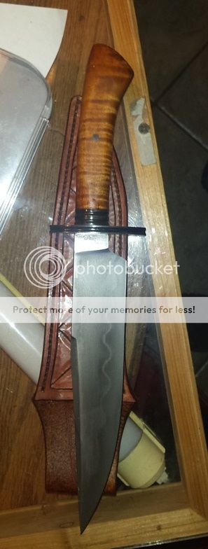

Bowie, some of Aldo's 1084 with a hamon. Developing a process to get a hamon in 1084 has been challenging. 1/4" blade that's been hand rubbed to 1000x before etching. Blade is 8" long with an overall length of 14". The clip isn't fully sharpened but if you wipe it a few times with a stone it'll sharpen right up
Fittings are finished to 800x and blued. Handle is curly maple, 7 coats of tru-oil.

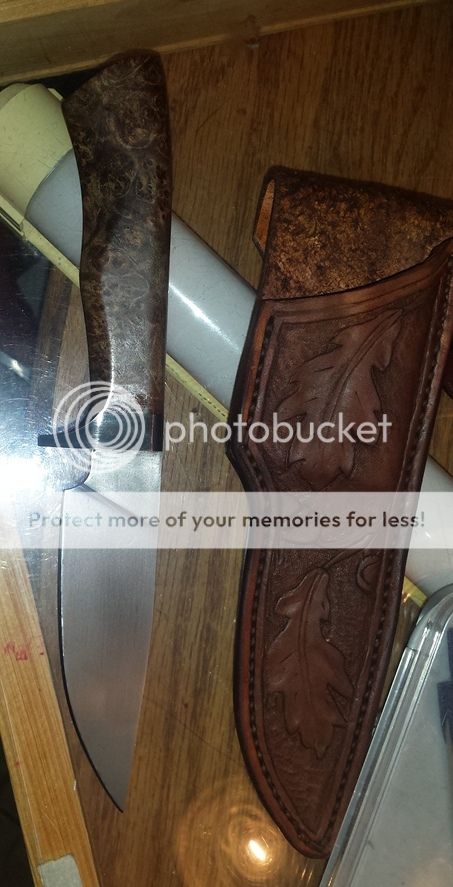

Hunter, Aldo's 1095 with a hamon. 3/16" blade, hand rubbed to 400x before etching, I like this finish for a using knife. Blade is 4" about 9" overall. Fittings are blued with stabilized maple burl handle. Fat, wet finger print at the guard... grrrrr
