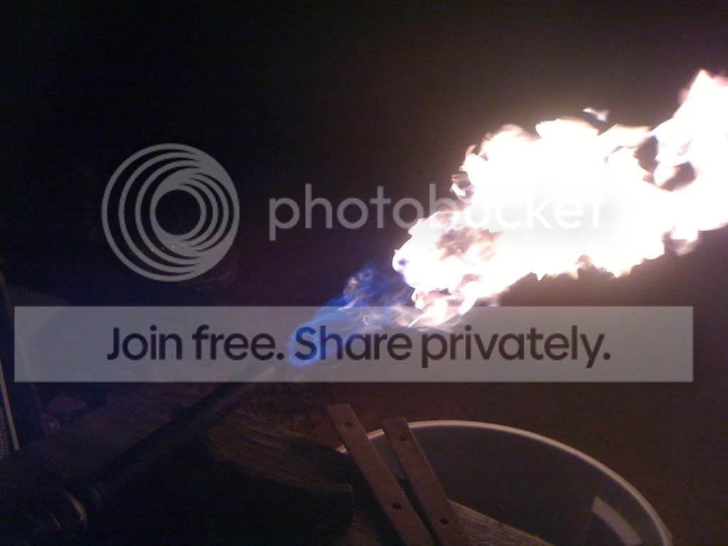

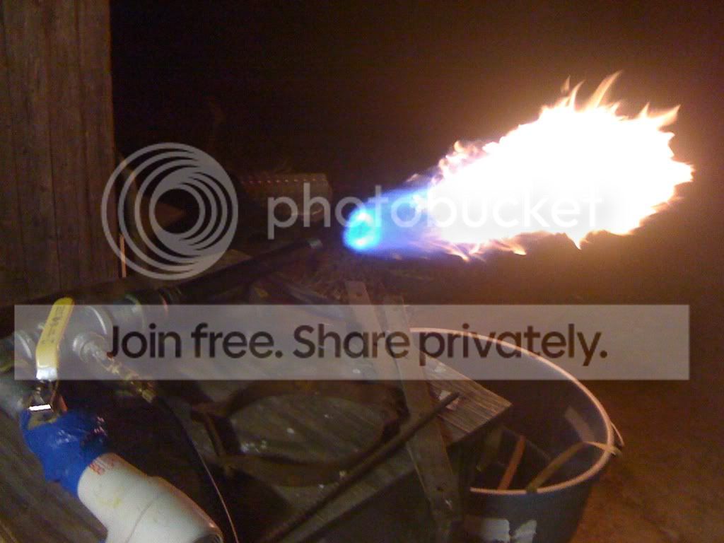

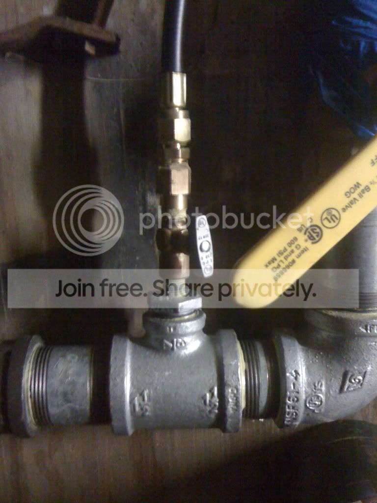

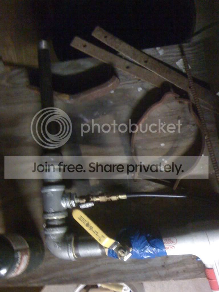

I do have a gate valve to limit the air. The needle valve is 1/4" and goes directly into a 1 1/2" tee. I can get the fire to stay lit but the flame is mostly yellow/orange. I'll post pics when I get to my pc
Mostly yellow/orange may indicate a fuel rich environment. I would think the needle valve would give you sufficient control to balance the flame, however. Pics will be good, I'm probably missing something in the larger picture. Maybe it's a forge design related issue or something.
Any chance you have a stronger blower around somewhere, like a shop vac maybe, that you could temporarily hook up to the burner? Most hair dryers I've seen don't put out a lot of air when compared to forge blowers.
How long is your burner tube? Where does the fuel come in? Maybe it's not mixing well.
A hair dryer does not usually provide enough air flow for a 1" burner. Try a blower fan, and you will see a HUGE difference. You really need 30-50 CFM or more. A large burner running at full flame can require a 100CFM blower. A mid size squirrel cage blower and a fan controller pot will make a good enough blower.
