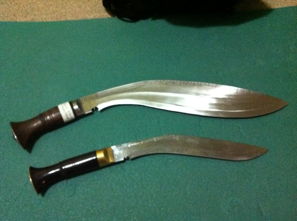

I've handled enough khukuris to get a good feel of what I like and what I want in one. Being 5 foot 7 tall and 130 pounds (175 cm, 60 kg), it is fair to say that I am a fairly small person, so using khukuris above 30 ounces for a decent amount of time is usually out of the question. The TGK was listed as 21 inches overall length, at 27 ounces, and thus seemed to fit the bill for me.

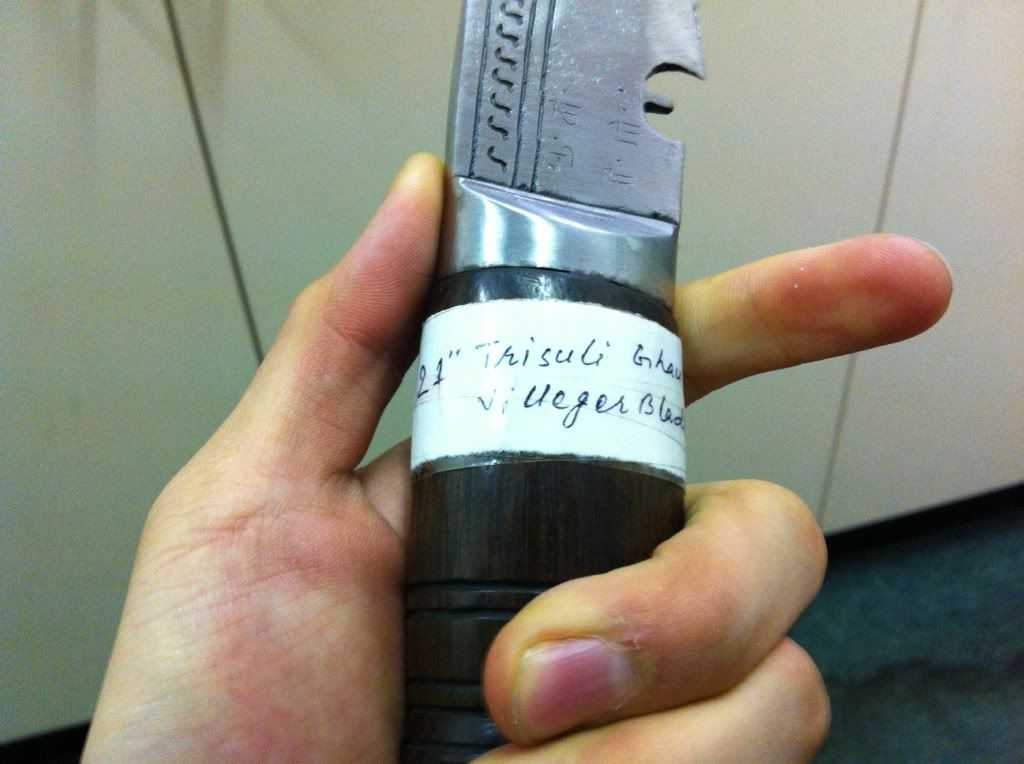

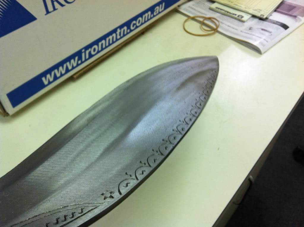

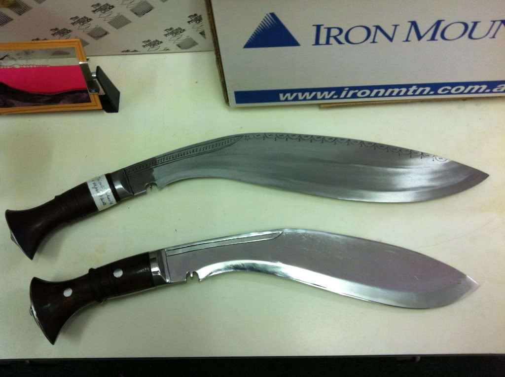

Looking at the design of the TGK, it reminds me very much of a Foxy Folly (a personal favourite). Both have the curved spine; both have the dui chirra (two fullers), making a broad leaf-shaped blade. The TGK just seems to have more embellishments up near the spine, which are intricately carved. It is villager finished, just the way I like it: lovely satin finish on the blades, with a toothy edge. The satisal wood handles are beautiful, as usual. This particular one was made by Rajkumar Kami.
Now, onto the important part, the way it handles.
The handle is sized for smaller hands, and fits mine like Goldilocks. Not too big, not too small, just right. Sometimes longer handles do provide additional benefits in usage, as I have found with my Parang, but aesthetically, it does look nicer to have a well sized handle (as opposed to an enlarged one), especially on a khukuri as long as this one.

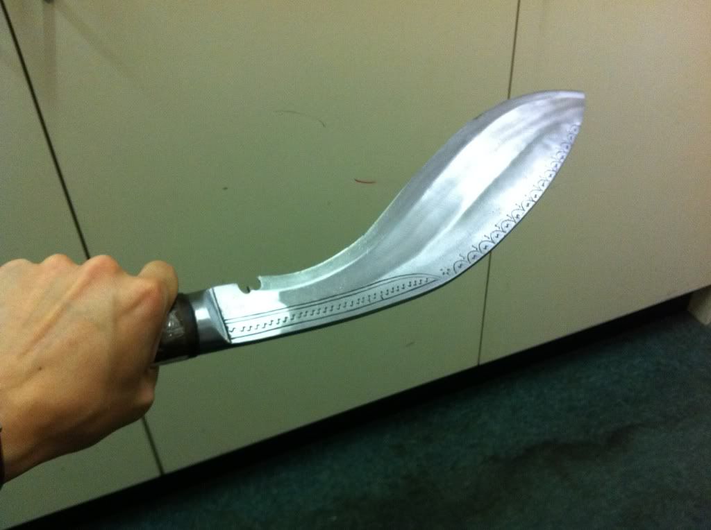

The fact that the TGK is a stick tang, and not a chiruwa, is in my opinion a plus. I know others may not agree; we'll chalk this up to personal preference. This means that the knife is more forward heavy, as there is less metal in the handle to balance out the khukuri. However, the blade handles like a dream. The balance point lies just on the star engraving, higher than usual. The TGK is still very agile for its size, definitely more of a fighter than a chopper.

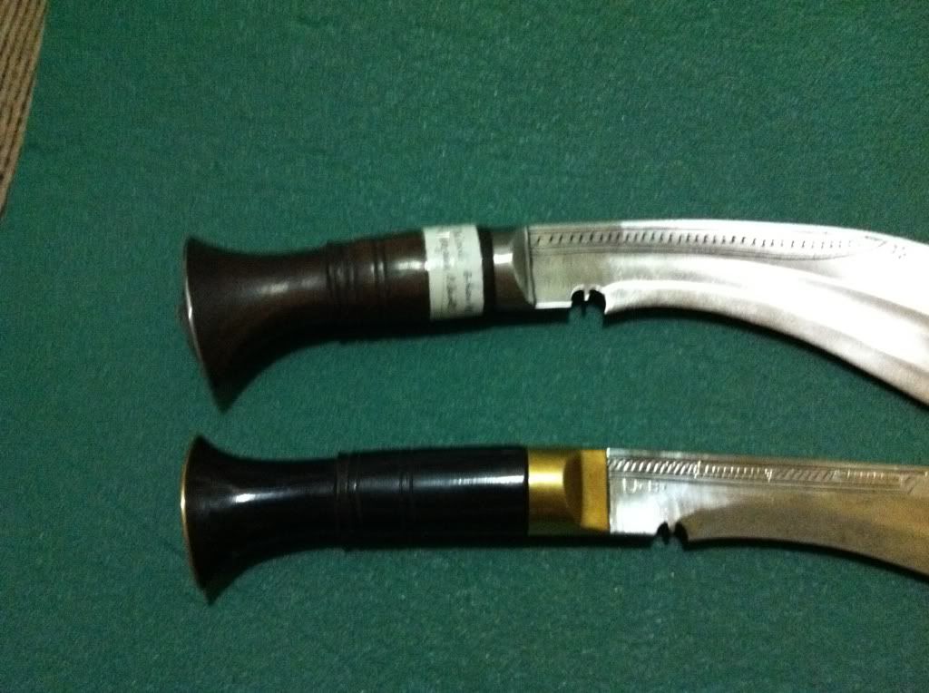

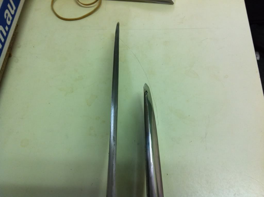

I'll let the pictures do the talking. The comparison khuk is a Bonecutter, 34 ounces at 18 inches.

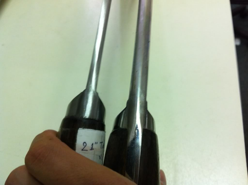

The spine shot in particular will speak volumes; it is clear that the Bonecutter is built to withstand much more punishment. Generally speaking though, one will definitely fatigue quicker using the BC rather than the TGK. All a matter of balance. Not bad, just different.

Thanks for the informative writeup and pics. To my eye, that's one of the nicest new offerings from HI.:thumbup:
Looking at the pics, I'd add two more positive features - no habaki bolster, and no cho creep.:)
The blade looks a lot like a GAK (Goorkha Army Kukri) minus the blade carvings. I bet that TGK is fast and nimble in hand! Nice score!
Is the spine tapered?

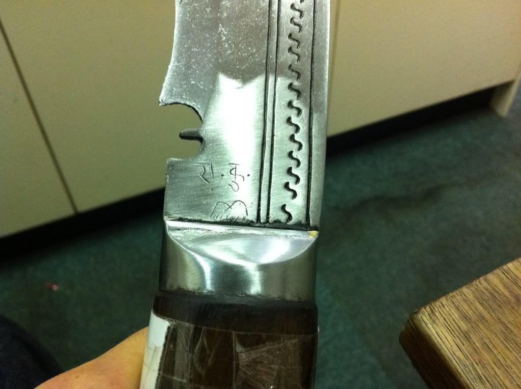

Berkley, I am somewhat ashamed to admit that after all this time collecting khukuris, I still never understood what habaki bolsters and cho creep really meant. That is, until your comment, where I looked up the terms. Can't believe I never noticed the difference until now. Here's a comparison between the TGK and a Bura-made sirupate.
The size of the bolster on the siru is clearly much larger than the TGK, and thus its blade length is reduced and handle size enlarged. I still count myself lucky enough to own a blade by the Royal Kami, but I agree that implementing this larger Habaki bolster is not preferable.
Bill, the spine does not taper. It is pretty much the same thickness throughout, up until the tip where the bevel is sharpened. Not sure whether this is a good or bad thing.

Thanks for the review! That is a very beautiful khuk. I was pretty excited to see it. IMHO, and limited experience, I think a tapered spine would be an improvement on almost all khuks. I've never understood why we never see it on HI khuks. As a matter of fact, on mine it seems the spine thickens at the shoulder. This can only add weight toward the blade tip. This makes sense for a dedicated chopper, but I would rather have improved balance on most models. I would also love to see Rajkumar tackle the Mk. II dilemma. Thanks again and keep us posted if you decide to use it;)

Really sleek and powerful looking knife! As a totally ignorant person, what is the purpose of the little C shaped notch near the handle? Is it basically a ricasso? Just can't figure out what the little protrusion's purpose is in the middle of the notch? Thanks!
http://www.himalayan-imports.com/Construction.html
It was originally thought that it was there for religious significance only, recent findings show that it may actually be a vibration and stress reliever for the blade. It is not, i repeat NOT a notch to catch an opponents blade.
Thank you Karda, I appreciate the explanation. I really love these knoves and need to get one.....soon! maybe for my B-day I'll get my wife to let me splurge!
