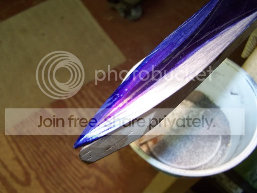

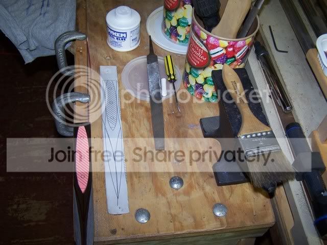

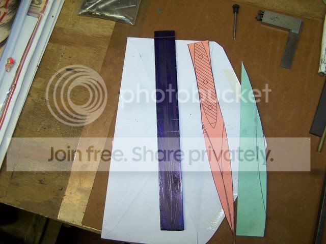

So I figured I'd take a shot at #2. This is some 1084 The Geek sent me, it should be interesting to see where it ends up. Along with the steel this fine young man included 2 beautiful pieces of maple that I may use on this one maybe not. The maple is gorgeous, I'll probably use it if this one comes out the way Im thinking. This is just the first side I'd figured I'll rough it in then turn it over, rough and semi finish the second side and turn and semi finish, heat treat and finish. I have some copper for my liners. I'm still really undecided on the handle.
I think maybe rather than relieve the handle I might go full width of the tang, very thin with copper bolster of sorts. I'm thinking. Makes my brain hurt but its sure fun.
I like that you're using a file to make the knife. I see in you a kindred spirit. :)
Very cool knife. just to let you know, the maple is scales. however, I don't think they are bookmatched. free is a great price, though ;)
I really like the dagger, very unique design.
And kudos to you on the file work... I only did a couple of tiny <5 inch knives before I decided I needed a grinder.

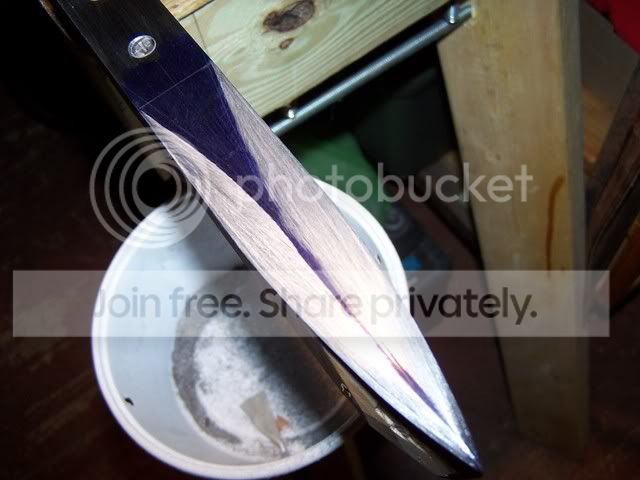

I started draw filing quite a while back when I started slow rust bluing firearms. A lot of restoration is on guns that have heavy pitting and its the only good way to do a barrel and keep it round and concentric to the bore. Ive actually never attempted to do anything flat before. Smaller gun parts I would rub out on a plate with what ever grit it took to get them to about 600 grit and cleaned up and then blue them. I'm thinking I'll slow rust this knife and polish out the bevels to finish it off.
Hey Geek you got that right about the price;) I may split one of the scales for a real thin set of bookmatched. I think it would look really good. Still thinking.
I think that's an awesome design, especialy for #2
If you do gunwork those skills will help a lot in knifemaking.

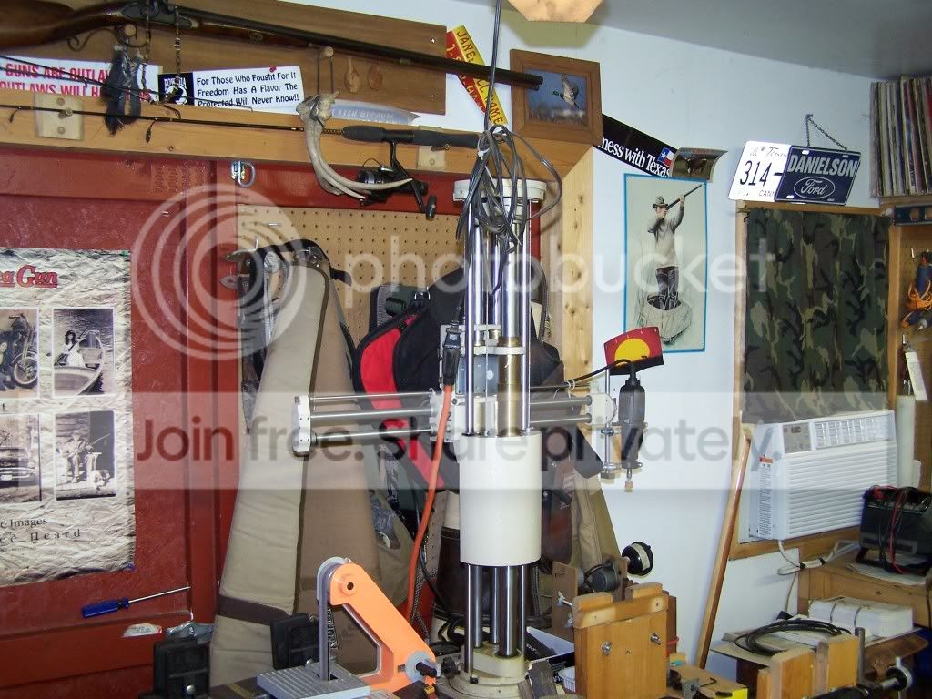

I have an second piece of 1084 I was going to use to get feel for it. I've got a feeling there's more to it than first meets the eye. That is a good site I was there for a while last night. I have whats called a CMM or a 3 axis coordinate measuring machine that I have adapeted a dremel to and could mill my groove and it could be the way I go but I'd like to cut the goove by hand. May be a little too ambitious for now.

That CMM with the dremal is an awesome idea. Very creative.
The company I worked for for years was throwing it into the dumpster to get it off the assets list. It has a digital read out, touch trigger probe and its a fully functional CMM. I measured for years with many different systems and this one happen to fall in my lap and its a mitutoyo about 20 years old. Ive used it a lot for measuring and just happened to come up with the dremel idea a while back.

You would be much better off using a milling machine for a fuller (blood groove.)

I'll use my dremel set up and cut the groove.
