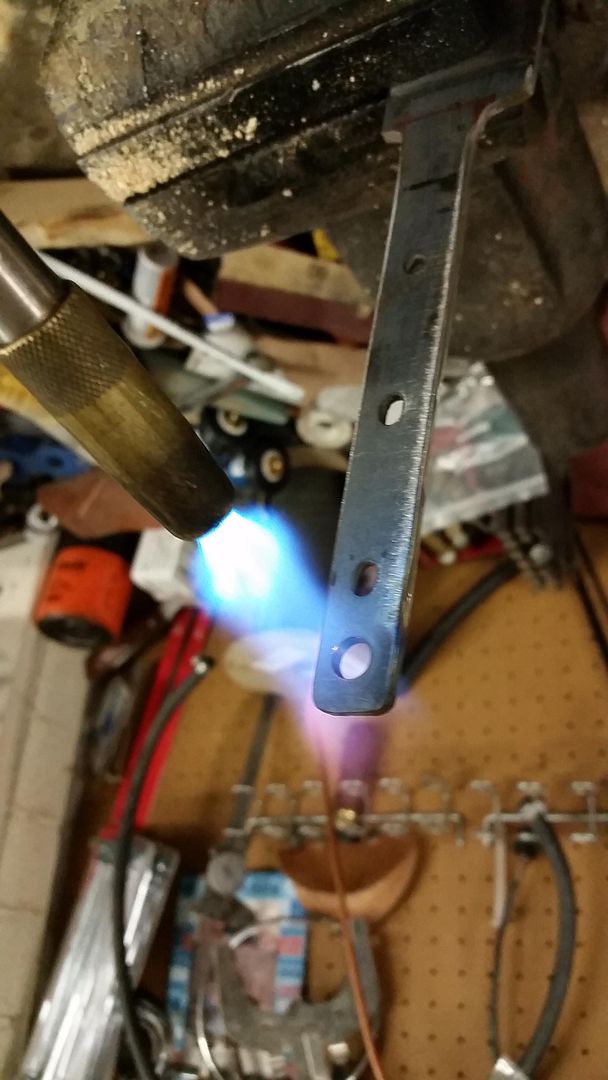

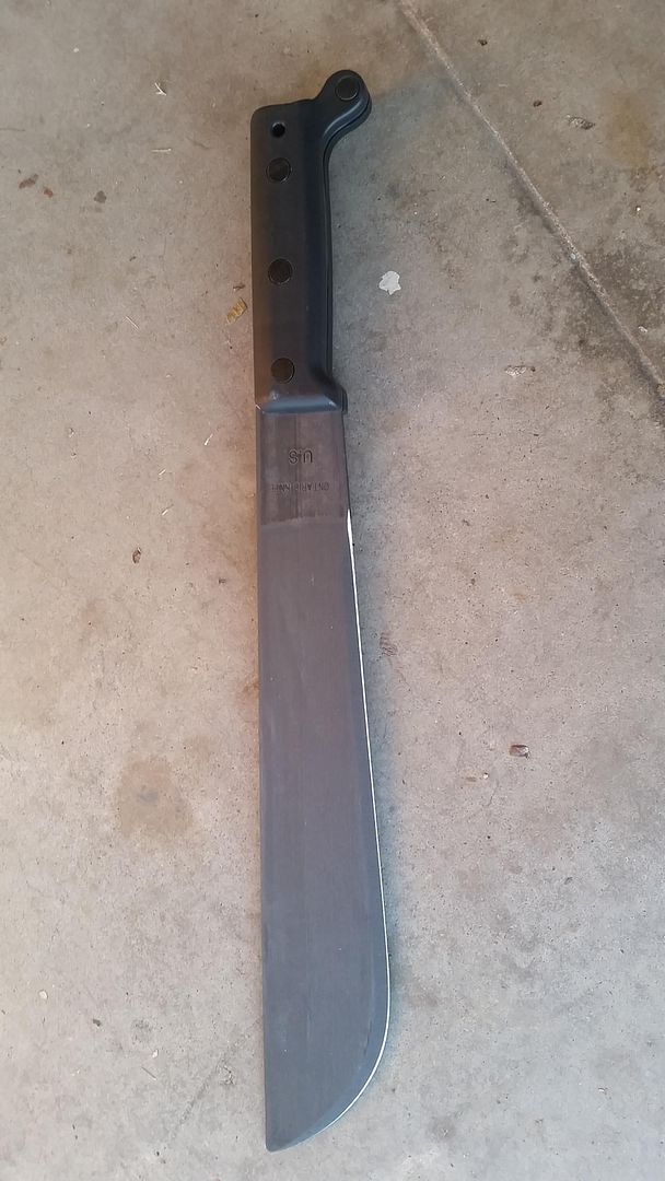

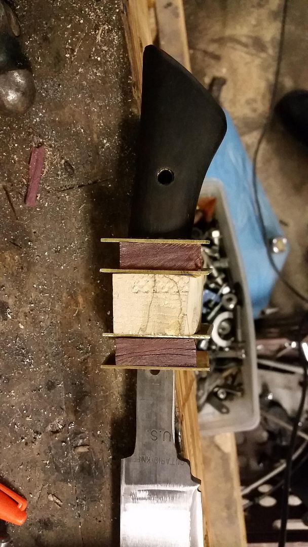

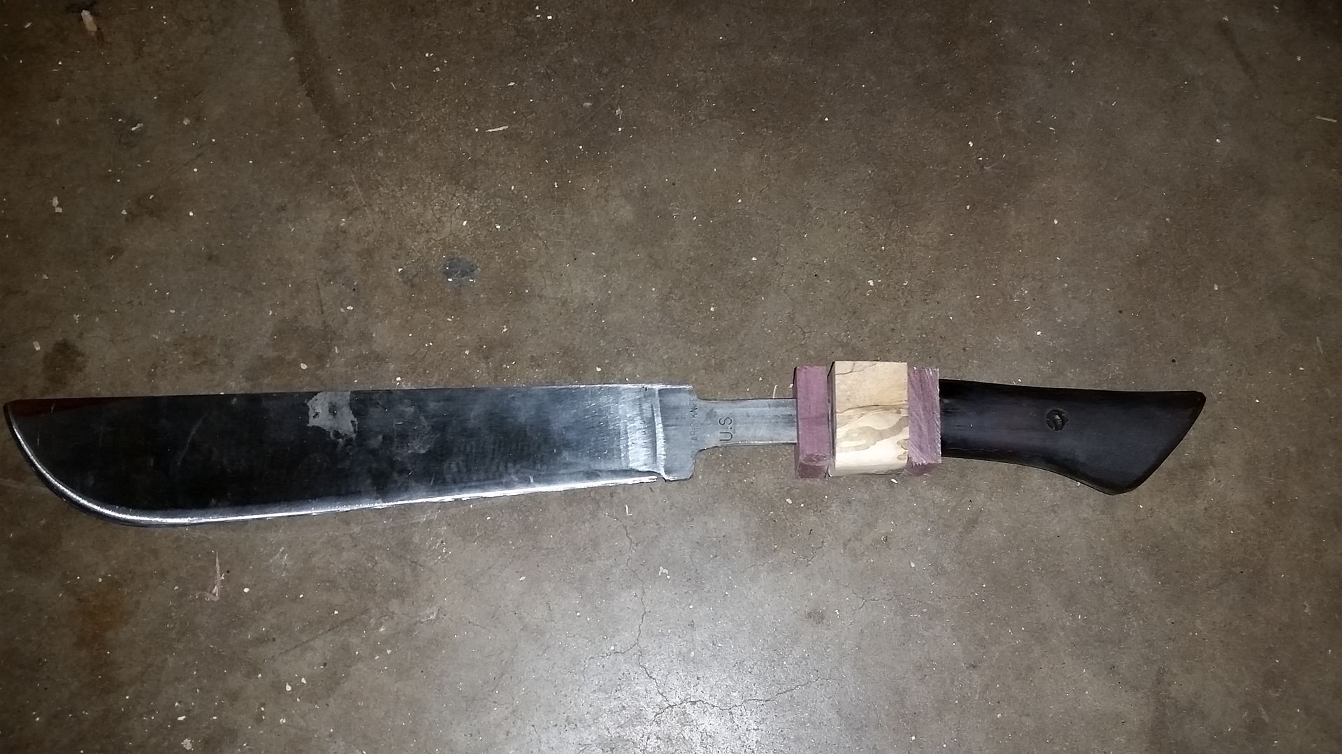

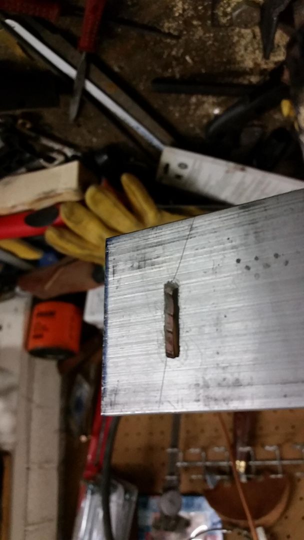

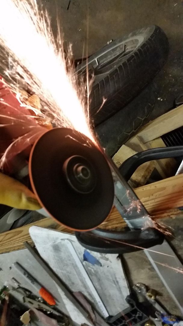

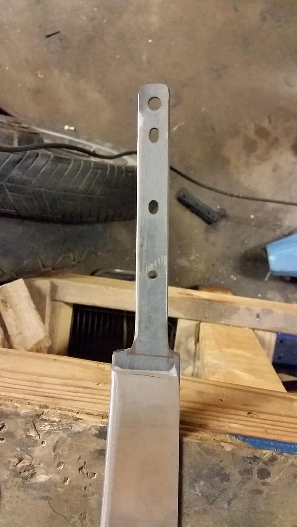

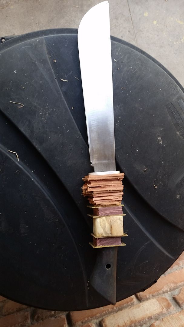

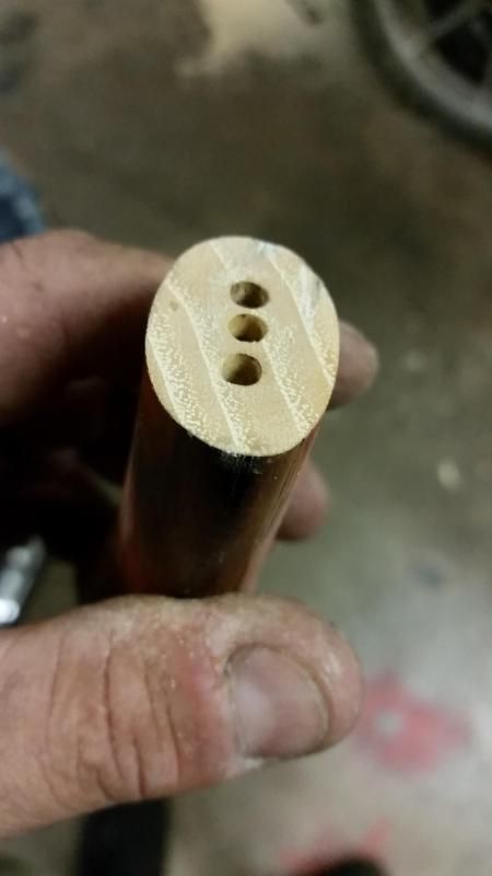

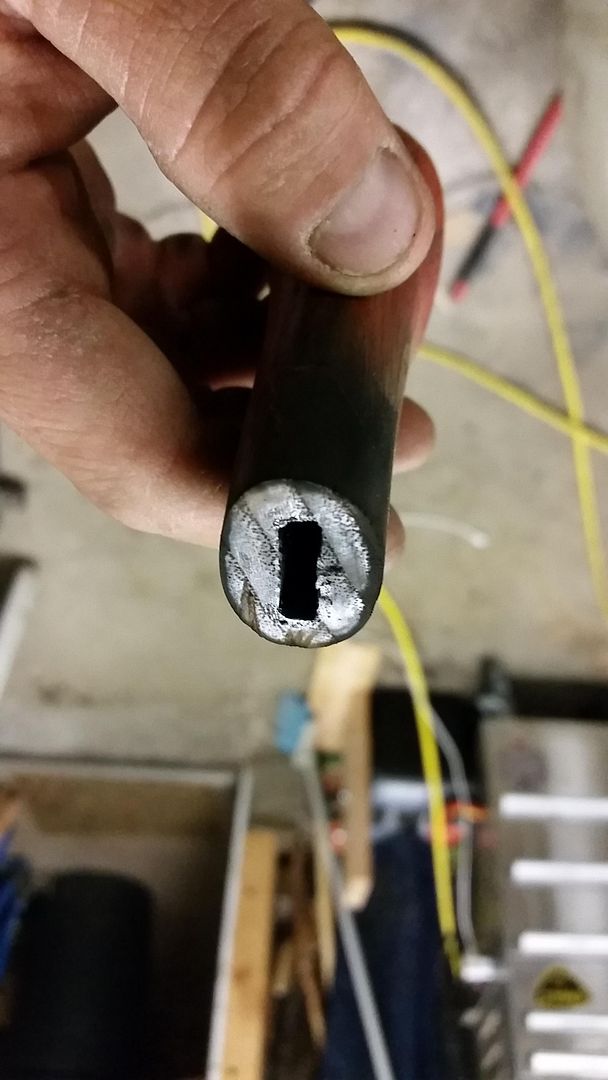

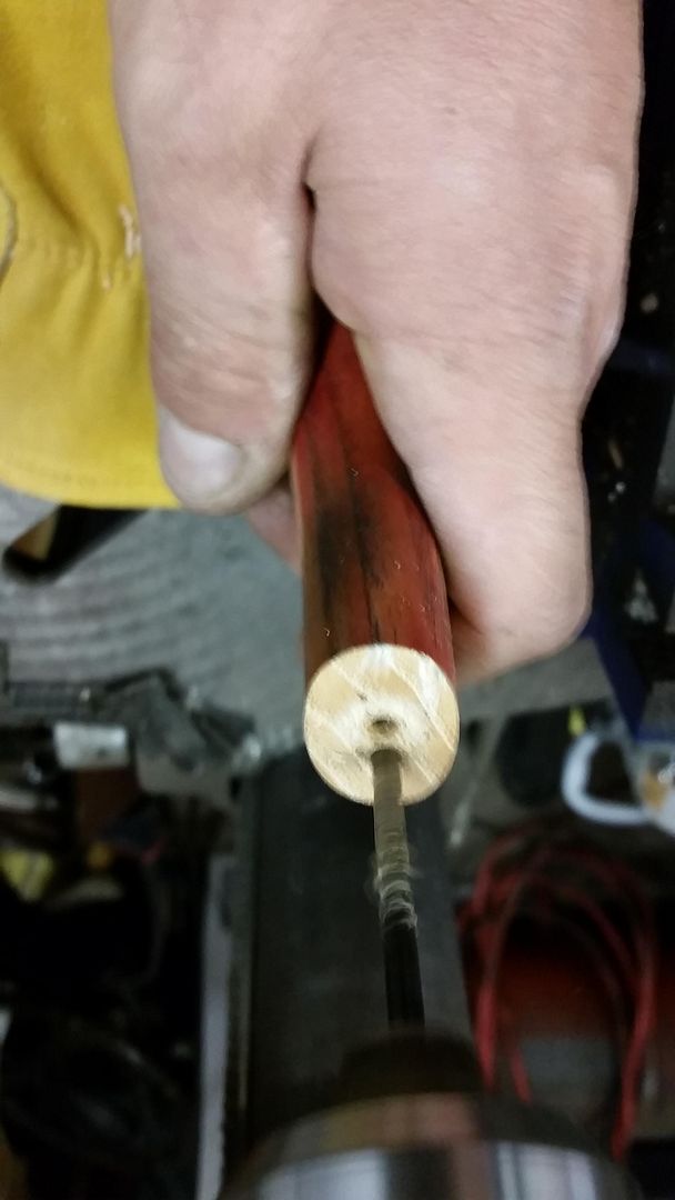

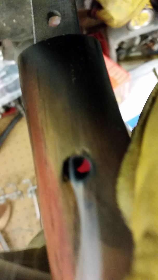

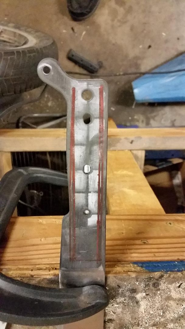

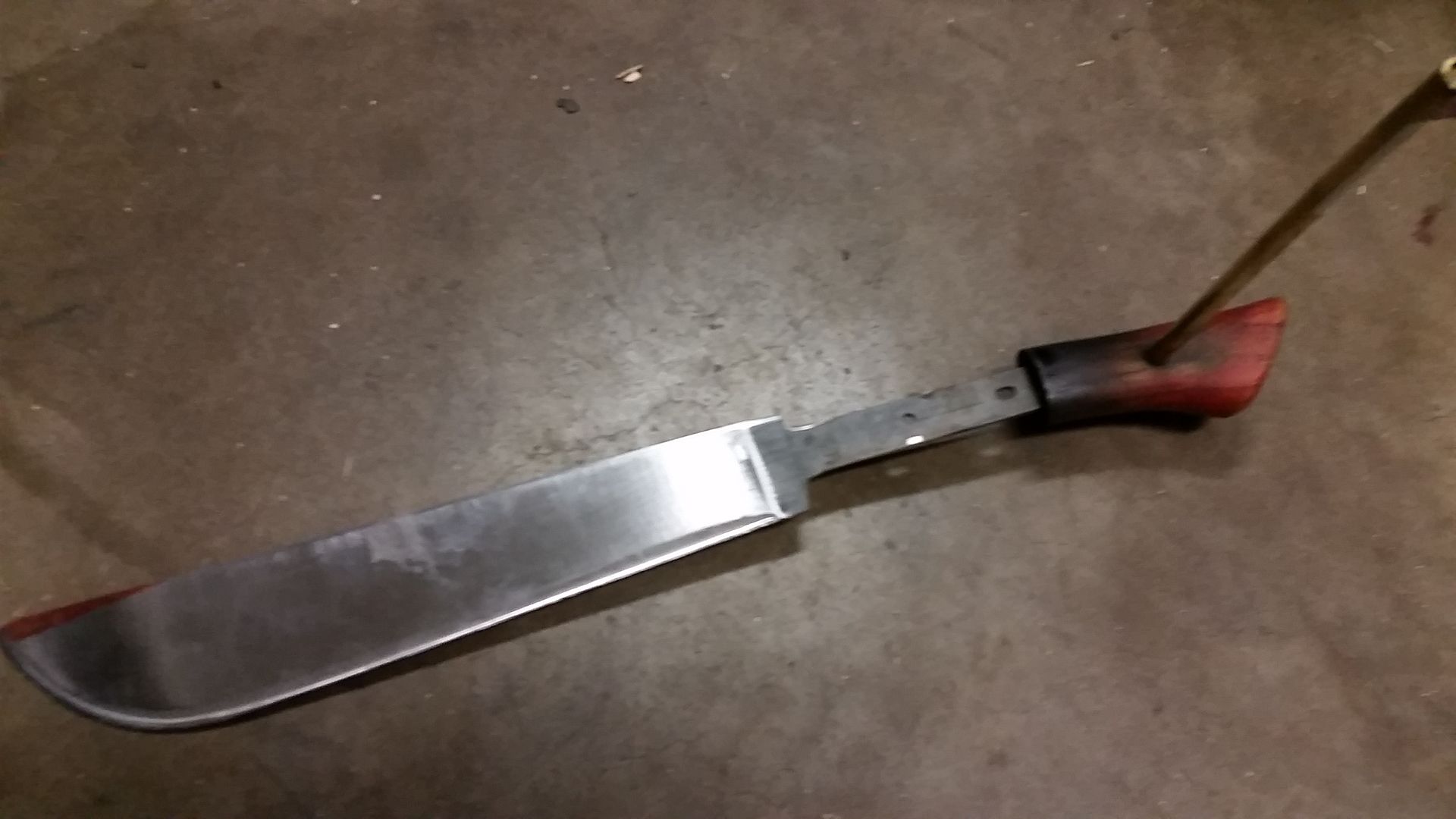

Alright a friend of mine commissioned me to build another machete for his brothers birthday. He told me to do whatever I wanted with it. So its going to have a long, wide stick tang, aluminum bolster, stacked leather washers, brass, purple heart and spalted maple spacers and a hickory hatchet fawns foot with a brass lanyard tube. Here are some progress pictures in order. I think the pictures speak for themselves. Sorry for the poor quality of pics. Im using a cell phone in a garage lit by flourescents, not the best combo.
Thats where I am at so far, should have more in a few days.

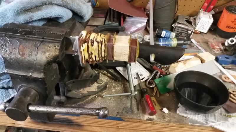

Here are all the washers/spacers
Then glued together
Roughing down almost at final shape

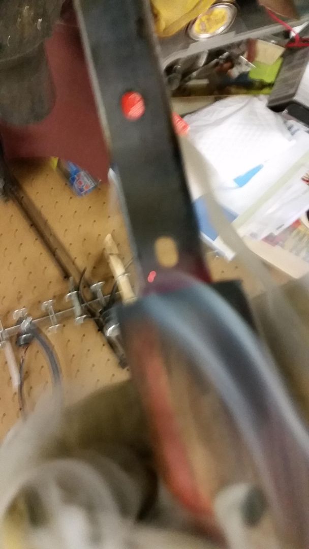

That stepped down portion between the purpleheart is going to get a jute twine wrap coated in epoxy. When it is sanded down it will look like the twine is encased in glass.
Here are some better pictures(I hope). I will hopefully be doing the twine epoxy wrap tonight on the stepped down portion.
Thanks guys,
epoxy/twine done last night. Oiled the handle and its looking good so far! Going to patina the blade and make a sheath next.
