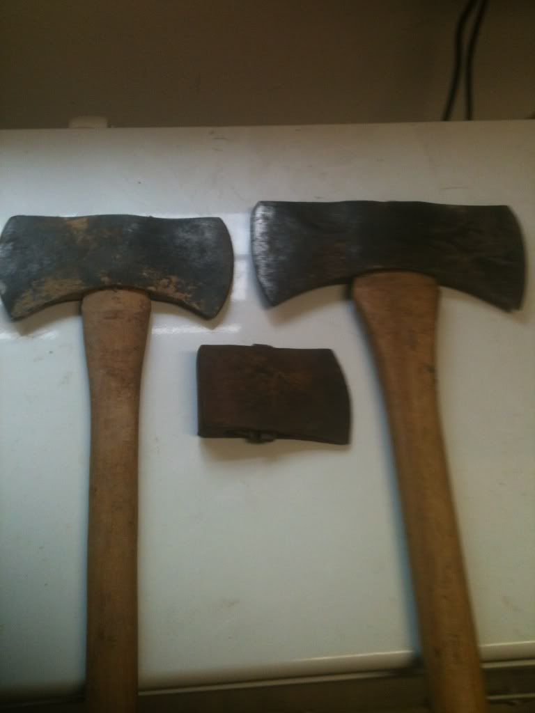

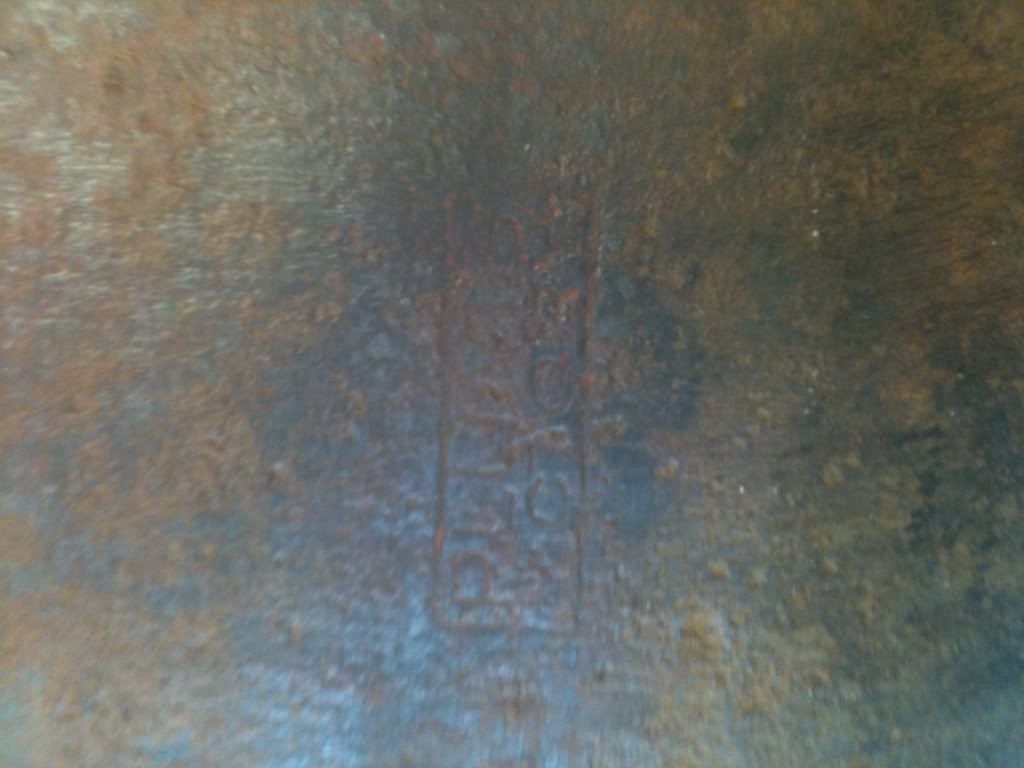

Here are three axes I'm going to clean up. The larger double bit is a true temper, the single bit is plumb, and, I haven't found a mark in the smaller double bit yet.
Nice group. Cool score on the cruiser size double. I've been looking for one of these but never find any. You'll have to update us with pics of the finished prodcuts.
It has a great feel to it. I've gotten some rust and dirt off but still can't find any markings.

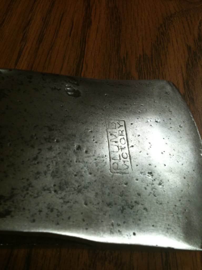

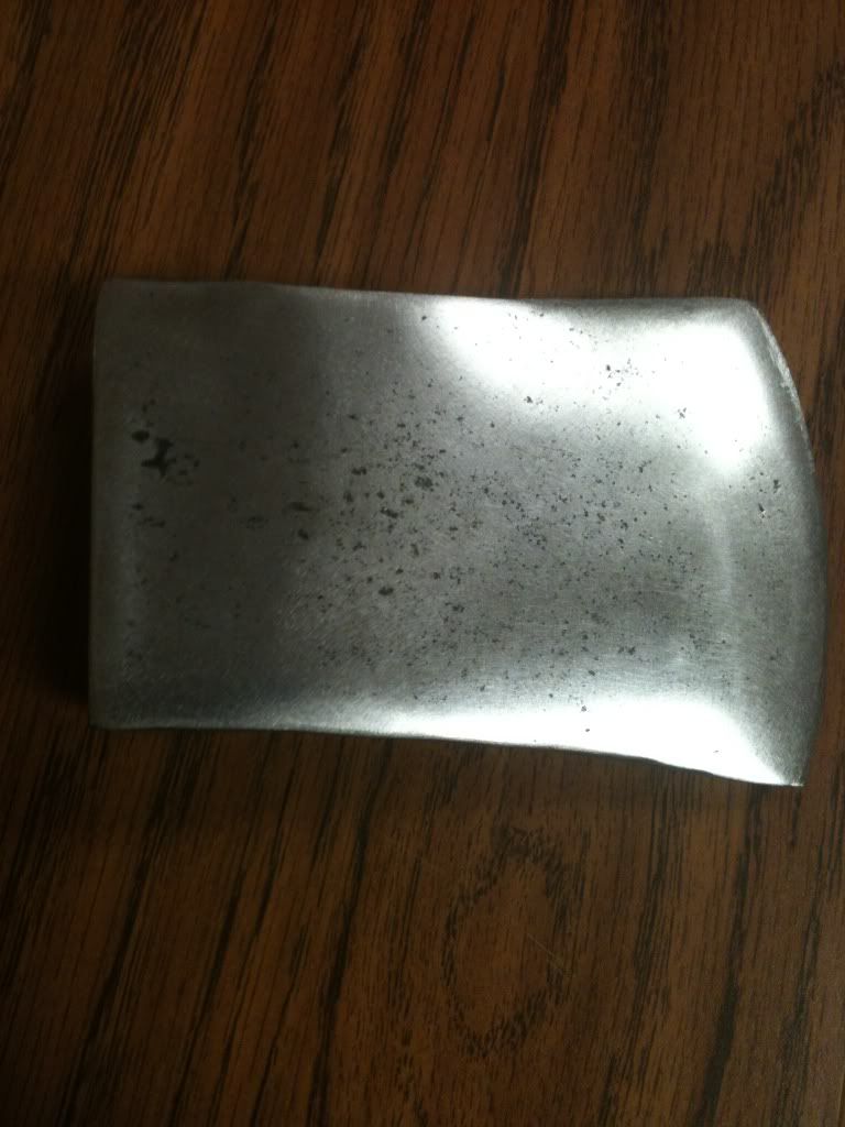

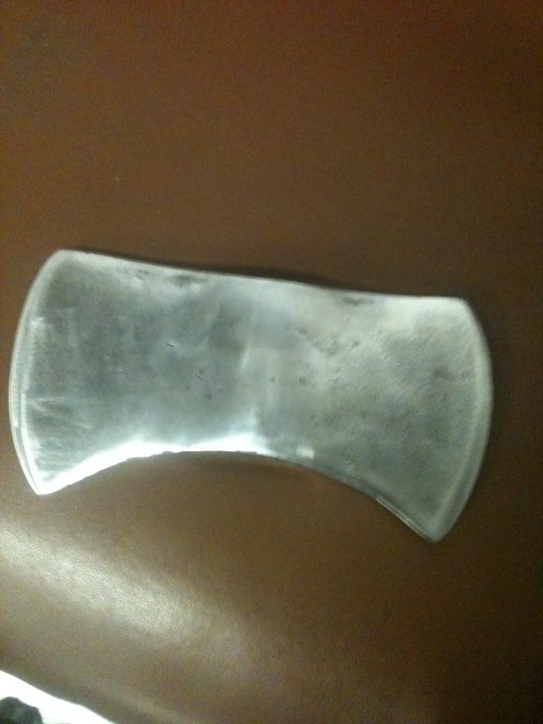

Finally did some work on these. I'm merging the axe thread with the hatchet thread that I started also.
Work was done with a die grinder with
Various grits of sandpaper.

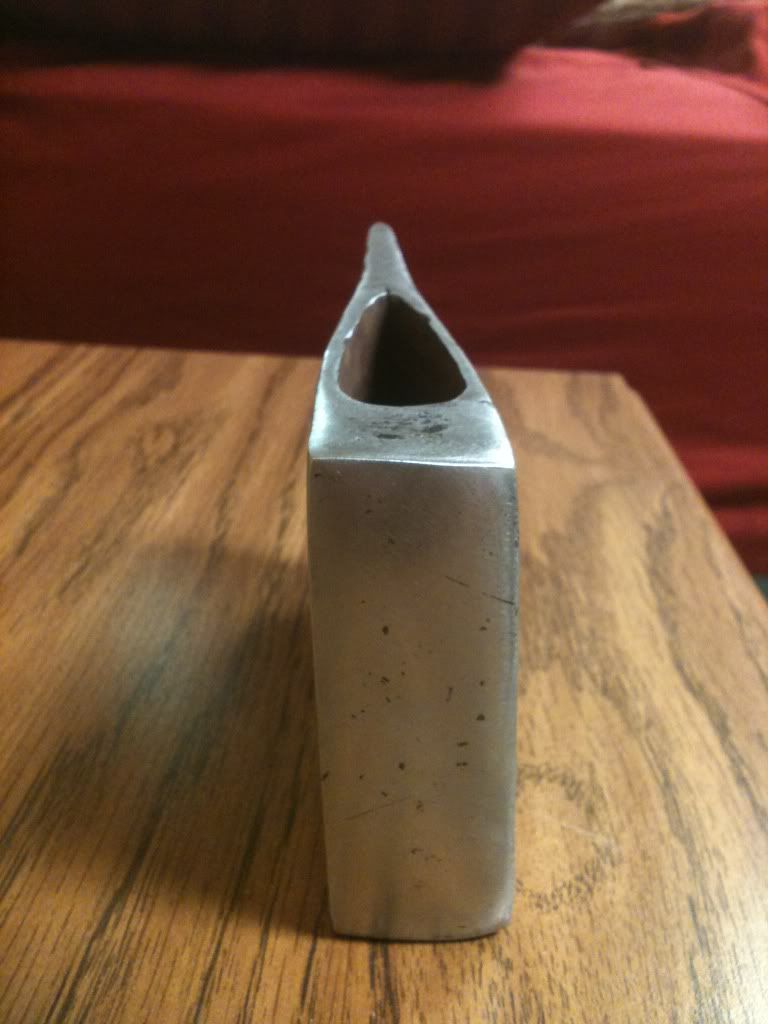

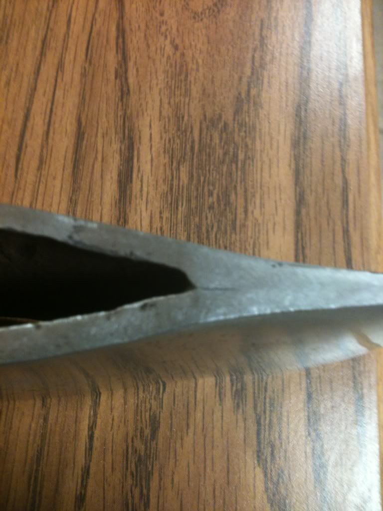

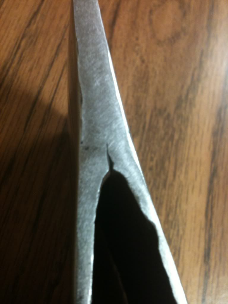

Took the notches out of the edges and cleaned everything up. Notice the crack in the boys axe.
I still plan on soaking these in vinegar. I have another hatchet head and two true temper double bits left to do. If one of them can be cleaned up with no pitting left, I may leave it shiny
With no patina.
Nice job, Dude. Keep up the good work. The crack in the boy's axe is no problem. That is where the forge weld met. It's pretty common even on brand new axes like wetterlings and GB's.

I agree with you. My thoughts there are incomplete and confusing. I should have thought through it more. I believe what happens on the GB's, Wetterlings, etc is that they punch the eye, then draw out the bit further with the drop hammers. As they draw out the steel into the bit, it pulls the two sides from around the eye. These pieces of converging steel don't always fully adhere which is okay. Here's a quick and dirty drawing of my theory:

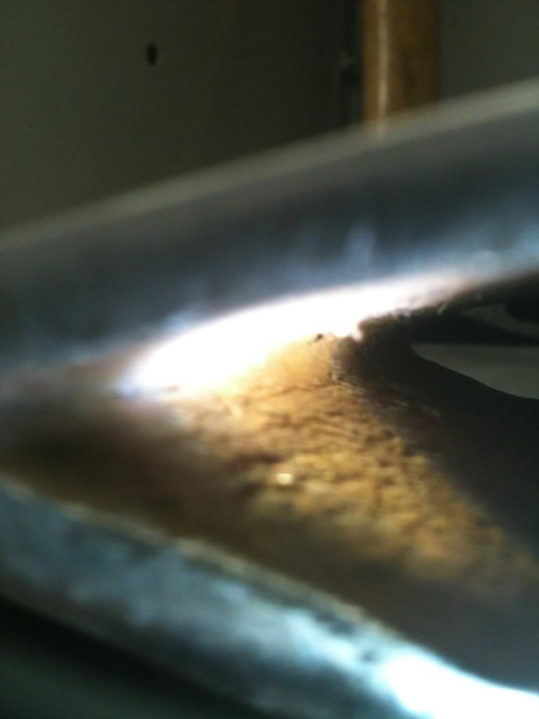

That's possible. But I think the axe shown in this thread is indeed forge welded as you first suggested. I just think it's an older axe. A forge welded axe will sometimes have a slight cavity in the bit side of the eye. Maybe Tote could take a closer look at that one for us.
Looks like there's at least a seam visible in that eye. I still think it's forge welded but I can't be certain.
