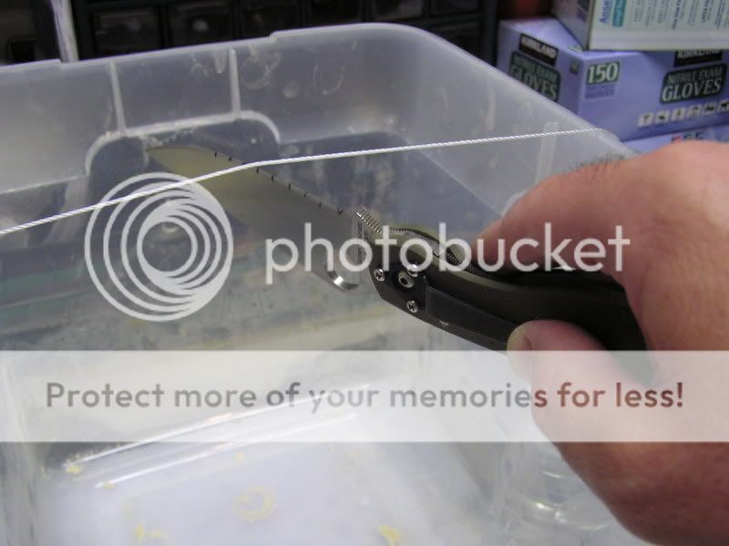

What is thread testing?

Thread testing: Not exactly sure, but I recall something about some people using thread (like you sew clothes with) to test their edges. Something about trying to slice a free hanging thread or something.

I've used and posted some results on thread testing. Basically, you have a thread under tension, and run your edge along it to see how much edge you need to cut it. Let's see if I can't dig up some old pictures to illustrate. I'm going to test a couple of Spyderco Mules in M4 and S90V soon to see how they stack up, at the request of a fellow forumite, and I'll use the thread to measure my results.
