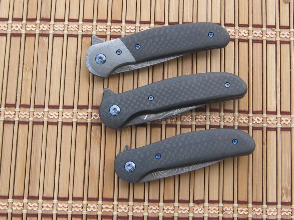

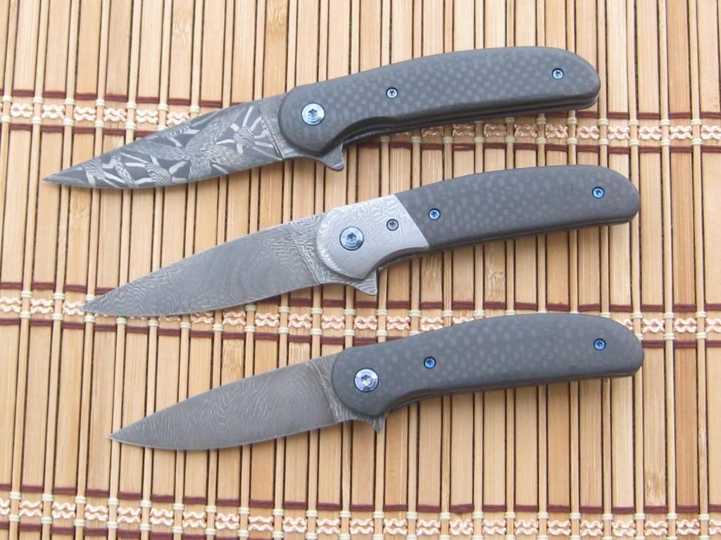

3 of my Chiron's are going to Blade. All with 3/16" pivots and caged bearings. Ti liners and hardware. Carbon fiber scales. Carbon fiber pocket clips. Damascus was forged by me. These are the 3rd ,4th and 5th flippers I have done. These are not tanks the blades are .118 thick. the bottom one is about 1/2" shorter version. All are comfortable in the pocket
Critique always welcome

David it was nice chatting with you as well. Lengths on the smaller one 4-1/8" closed 7-1/8" open. The 2 larger ones are 4-1/2" closed 7-3/4" open.

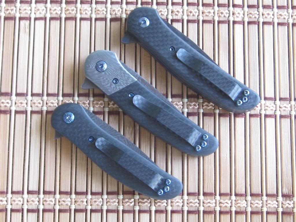

Very nice. How about pics of the other side?
Pic of back added.

I assume these are all furnished with hidden stop pins?

Yes hidden pins, I don't know how to do it any other way:eek:
