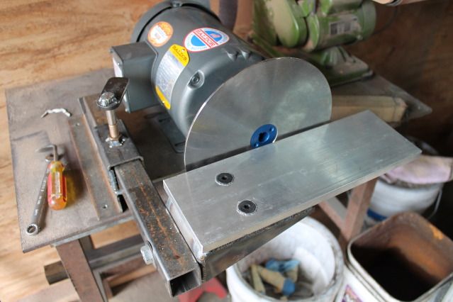

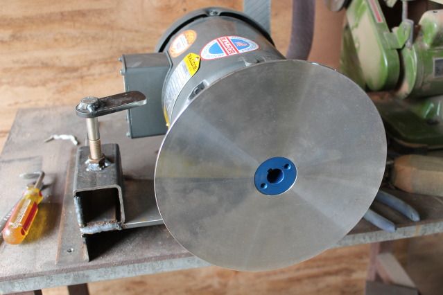

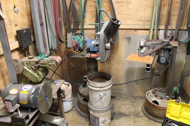

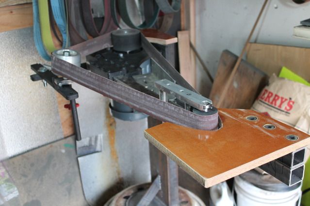

I Finally got around finishing building the frames and wiring my newest grinders. A disc and a horizontal.

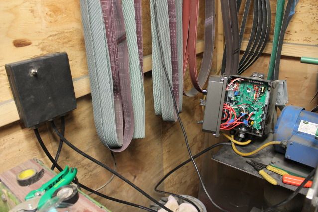

I wanted to run all of them with speed controllers, but didn't want to shell out the cash for another 2 VFD's. So with a little creative wiring I was able to hook them all up to through the same vfd. The horizontal should be the cats meow for profiling and the disc will be awesome for flat grinding and handle fit up. I just need to finish the other 2 work rests on horizontal and they will be all done.
Here are some pics and a short video.

A triple pole, double throw toggle switch.
230 VAC
2 HP should do it.
I also think that "center off" position makes sense
You can do all that wiring inside that VFD case, there is lots of room for that and enough punchouts to run the wiring for 2 motors out the holes too, 3 motors, you would want to drill another hole but no worries, the front cover comes off pretty easily
Two motors
For 3 motors, you can chain 2 of those switches together.
1, 2, 3 motors ah, ah ah.

What about the ground wires? Do you run each one direct to the VFD or can you connect them all in the switch box and then to the VFD using one ground wire?

Will this 9 terminal switch from McMaster-Carr work ok? (I've seen where others have used an 'ON-ON' switch, but I like the idea of a center off position.)
-3 Off or On On or Off Stays Switched 9 3PDT ON-OFF-ON 25 20 0.69" 8001K42 15.60

Here is the part number: 8001K42
I read in another post where Salem S. used the K41, which seems to be the same type switch but is On-On vs. On-Off-On. I like the idea of having an 'Off' position on the switch (not sure why, just seems like a good idea.)
http://www.mcmaster.com/#catalog/118/876/=imv8xa
Seems OK to me.

The wiring really is quite simple once you get started. If I can do it, anyone can!
