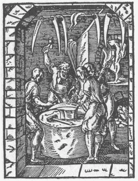

A picture from the 16th century showing 4 men hammering a scythe blade.
I guess that with thin blades like that, they want to get as much deformation as they can for each heating of the steel.
