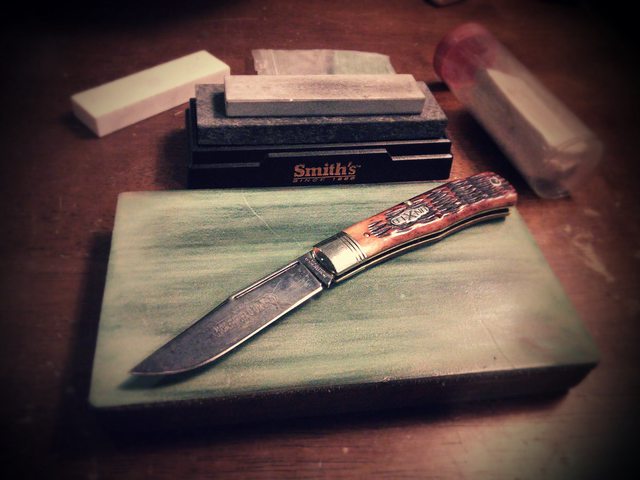

I realized today that I've used a Spyderco Sharpmaker for all but my convex ground knives for so long now, that I didn't even know where my other sharpeners were anymore. So down to the basement I went, and after rummaging through a few old boxes, I found my various bench stones and whatnot. I even made a project out of it, grabbing some old wood out of the garage, hitting up the leather working box for a piece of scrap, and making myself a nice new 4X7 bench strop. I had my choice of green compound or Yellowstone, and went with the green this time. If I have time next week, I may make up a separate strop and load it with Yellowstone for comparison.
I think that I'm going to challenge myself for the next 3 months or so . I'll carry a carbon steel traditional each day, and use only bench stones and my leather strop to maintain the blade edges. For now, the Northfield #72 and the Camillus TL-29 get the nod, but the incoming #15 will probably also get a lot of pocket time. I don't see any other knife purchases on the horizon, so it'll probably be just those three knives in my righthand pocket.
I did a quick run through with my old Smith's medium and hard Arkansas stone kit, and then the new strop. I was surprised to see how quickly I got the edge back, and how nicely the edge polished up. I expected a lot more problems, being without my diamonds and edge guide. I think I'm going to enjoy this challenge. Sharpening was a lot more relaxing this time, in comparison to my usual sharpening sessions.
PS - I've made a few strops over the years, but this was my best strop yet. Instead of trying to use the smooth side of the leather, which stropping compound always has problems sticking to, or trying to use the flesh side, which always has too high a nap to allow the stropping compound to smooth out, I went somewhere in the middle. I went smooth side up, and then put the smooth side on a belt sander for a minute, sanding off the smoothness, leaving a low nap surface. The compound adhered beautifully on the first try. Running the edge across this strop is buttery smooth.

I attempted to give my new GEC #15 it's first sharpening last night. The edge wasn't as bad as many other new slipjoints, but I wanted to reprofile it to 15 degrees on each side. My freehand skills were definitely not up to the task of reprofiling. I left a few marks on the blade, and did a crap job. In the end, I had to break out the Sharpmaker to establish the initial profile.
So I think I need to amend my challenge to sharpening, but no reprofiling. At least until I can make myself up a 15-degree edge guide. Does anybody else ever use an edge angle block with their freehand stones? If so, do you use it directly on the blade, or do you place it under the stone? I've never used an edge guide, but I could see it being quite handy for reprofiling.
The new bench strop is working out famously. I can't believe that I suffered with just a narrow strip of leather for all these years. Having a 4.5" X 7" strop is quite a luxury. Tons of room to work my blades. Even my fixed blades. I could strop all day and all night, and be a happy man. To tell you the truth, with regular stropping on the green polishing compound, the Arkansas stones aren't seeing too much action. The stropping seems to be enough to keep the blades going, as long as I don't wait too long before touching up the edges.
I may have to work on the bench strop next weekend though. I initially just used some MinWax wood stain on the wood base, but that green compound is messy and really gets into the wood. I think I'll sand down the base, stain it again, and then put on a coat or two of spar varnish to repel the green compound. I did hit up Walmart for some thin rubber adhesive-backed feet for the base, so no more slipping and sliding around the table.
