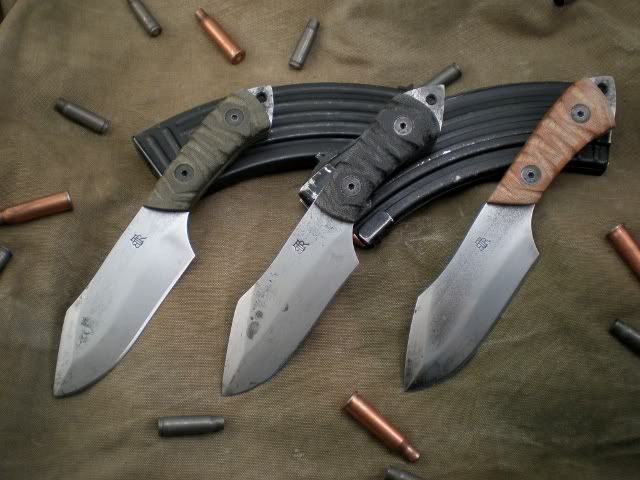

Here are 3 new hard use knives I am calling my Mini Tac Bowies.
Thay have a hand rubbed scotchbrite forge finish that should be very easy to maitain.
The canvas micarta scales are hand carved for tons of grip.
The sheaths are drying right now. let me know what you think.:D
Those are very interesting, looks like a great all around rough use knife. Could you give us some measurements and steel type?

They specs are appx.
OAL 9 3/4"
Blade 5"
.214" 5160 blades

Awesome those look great! Are they for sale? Or already claimed? What did you use to texture the micarta?

Those are all long gone, email me if you are interested in another one. The scales are all textured by hand, with files.
I think the only thing that this knife might need is some jimping on the spine. Either way, I can't wait to get mine!
