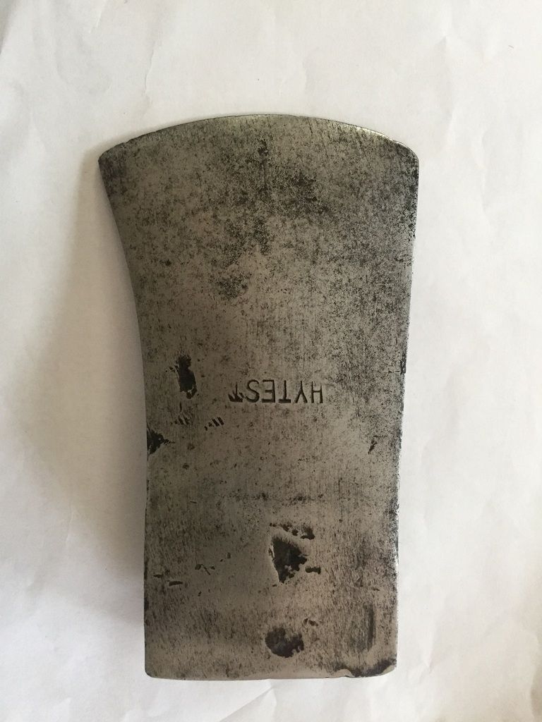

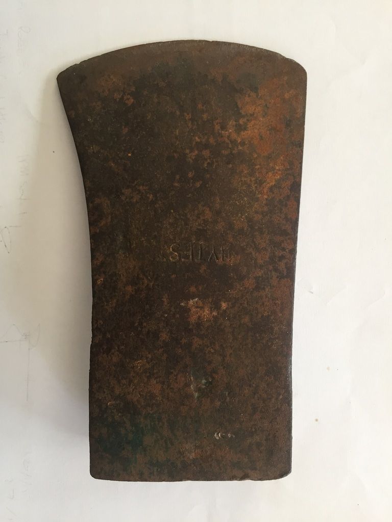

This set me on a long search for a 3 pound head. I was lucky to find a Hytest head that fit the bill, for $2 at a garage sale recently. It is a generous 2 ¾ or lean 3 pound head, depending on your outlook. I cleaned it up with wet and dry paper, revealing the remains of a number 2 on one side (2 ¾ mark maybe – Cyclone/Hytest made a boy’s axe in this size, from what I understand?).

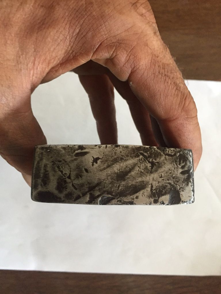

On the brand side there are 3 deep pits, which have old Cyclone green paint in them. Suggests that they are a manufacturing defect, rather than corrosion or abuse. The green paint and the good resistance I got filing and honing this head encourages me that it has never been burned or put on a grinder. The poll shows a lot of abuse though.

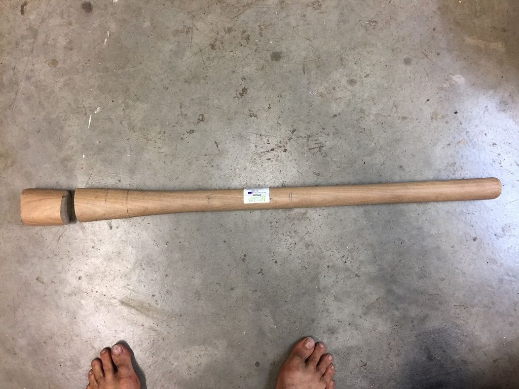

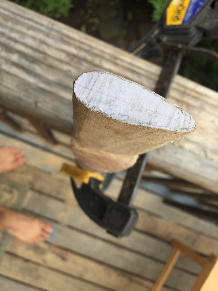

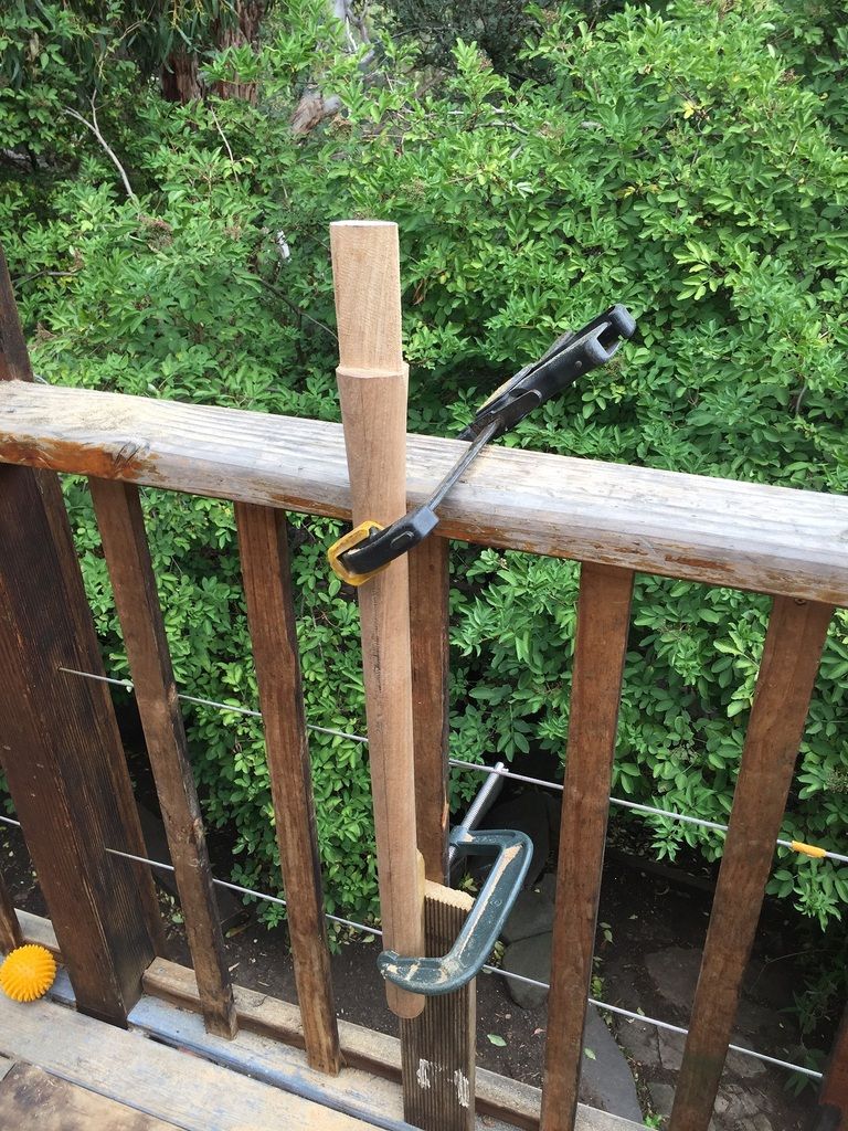

I bought a spotted gum mattock handle and cut it down to size, so that could get something straight and hard. This took ages. I used one of the offcuts to cut a wedge. I rubbed through paper to make a template for the eye-size of the axe, then glued this onto the head-end of the handle, as a guide for me to work to. This worked very well for me. Clamping the handle to a rail in an upright position made it easier to do the final shaping on the head-end , and also got me around the problem of not having a useful vise. I used Cook’s table of straight-handle dimensions to size the handle. Lots of hard labour with a rasp to get there.

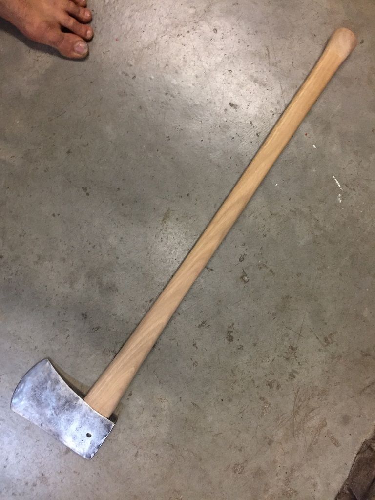

The final product (yet to be tested) is kind of Cook’s ideal axe for a lightweight/casual – 3 pound head on a straight 32 inch (80cm) handle. Looking forward to cutting something down and up with it. (But more likely, using it to rescue the chainsaw).

Looks great man! good job. Great idea re-purposing the mattock handle. and the poll isn't in bad shape at all, in fact, I'd say its way better than average we would see over here on an older head. love the bare feet also. took me a second to realize its summer where you are.
Nice job! I have two straight handled axes that are about the same size/weight that I absolutely love. Both were picked from garage sales too!
  • Like
Reactions: A17
I also have one set up similar, and think you'll like it a lot.
Great job making that handle work, took some effort!
  • Like
Reactions: A17
Looks great! 32" straight haft and that weight will make for a very handy axe.
Thanks FLINT77. Good to know that the head is in ok shape. I promise I'll put shoes on when I use the axe...
