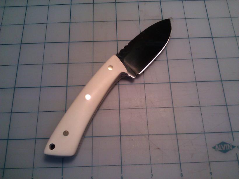

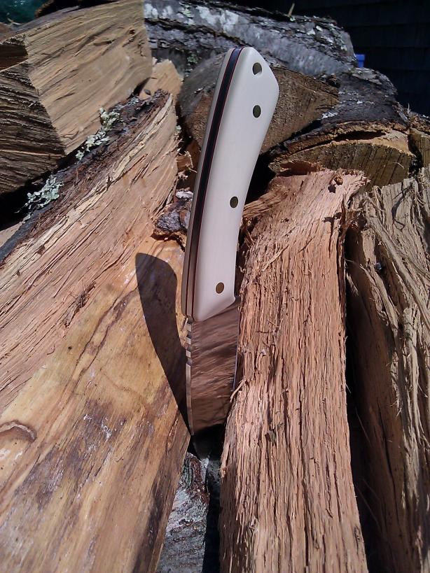

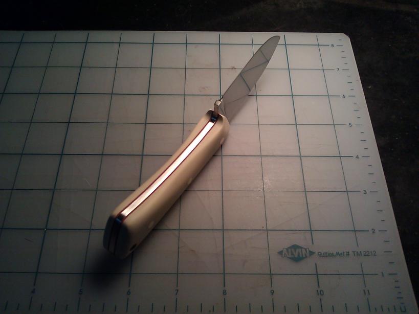

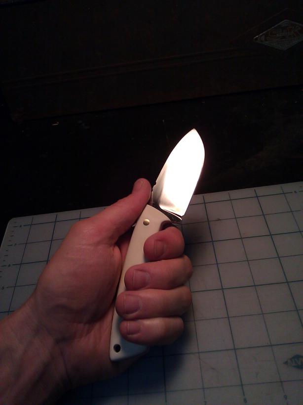

I've just completed this one for a friend, and will likely send it out for pro kydex.
It's my "standard" 3" hunter design at 100% scale in O1 with ivory paper micarta scales, red liners, and brass pins. The grind on this one is higher than the one I made for myself and I'm really digging it.
The pictures don't do a good job of showing the handle contours, which are subtle but definitely NOT square. The middle underside is dished to keep the knife in your hand, and there's a very gentle depression between the first and second pins which should give the kydex something to hug securely.
There are a bunch of things I could nit-pick, but mostly the pictures don't expose 'em, so I won't ruin the show. :-D
Thanks for looking.
