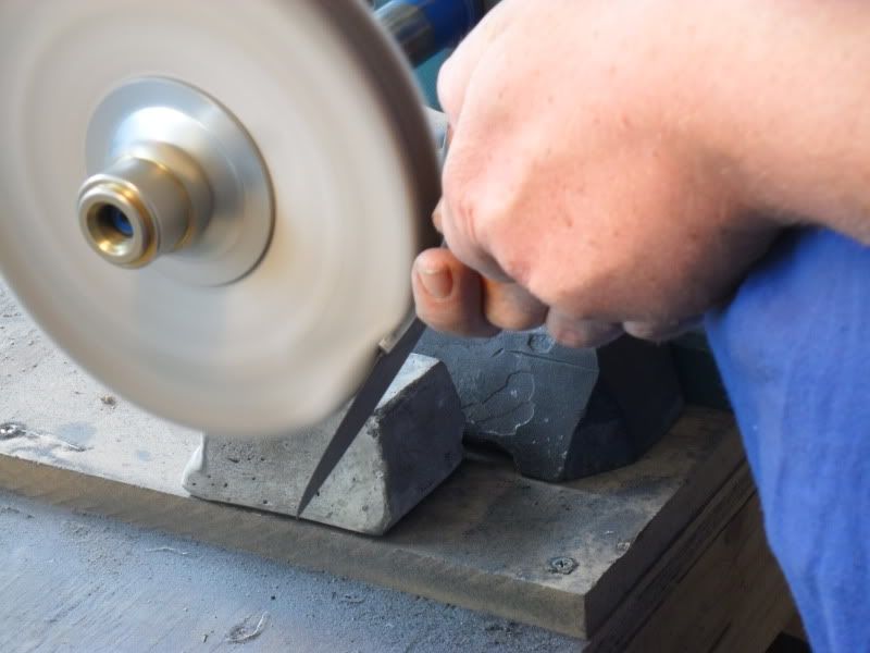

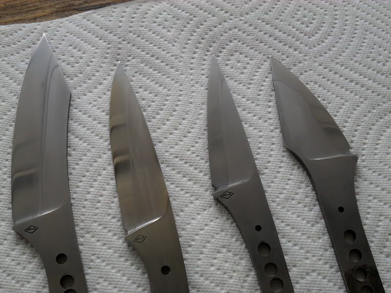

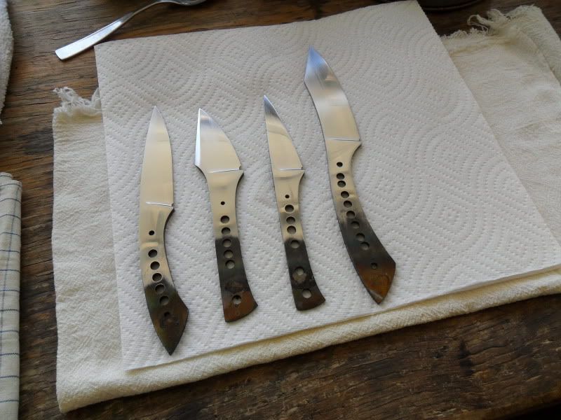

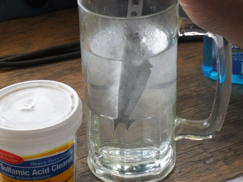

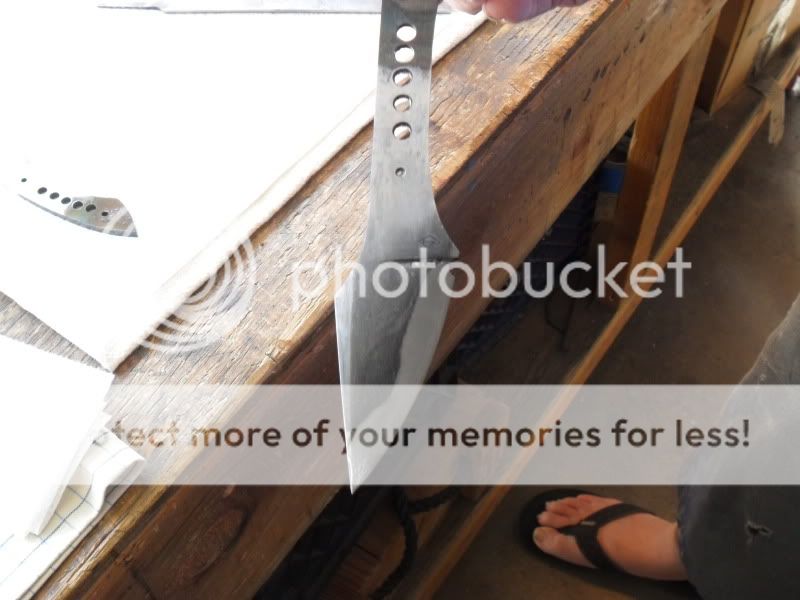

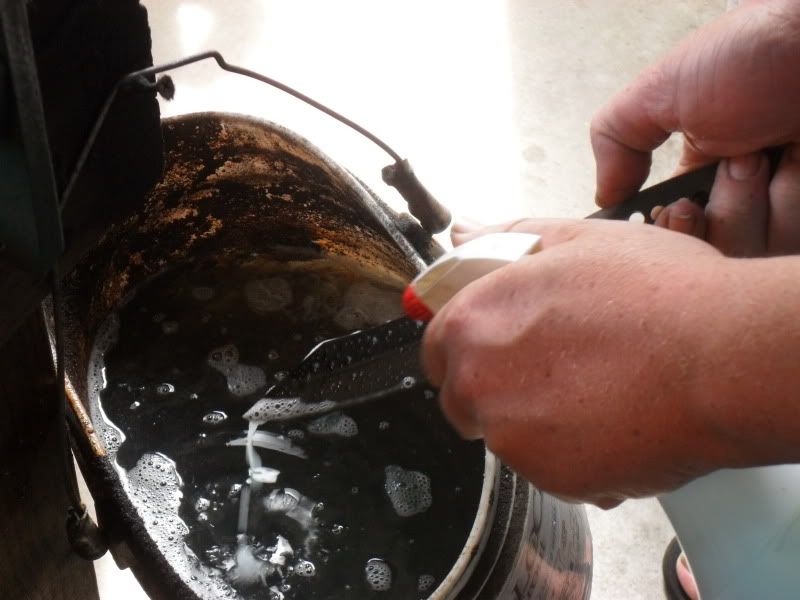

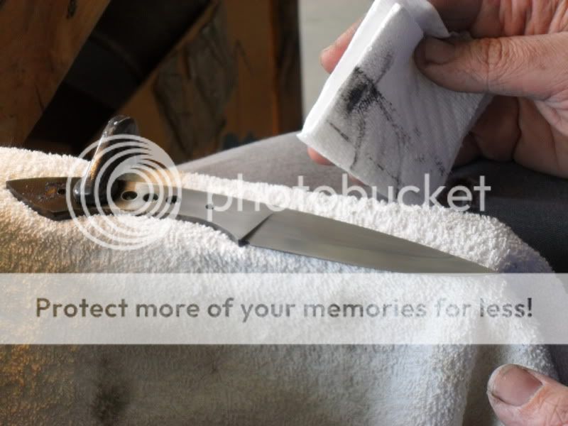

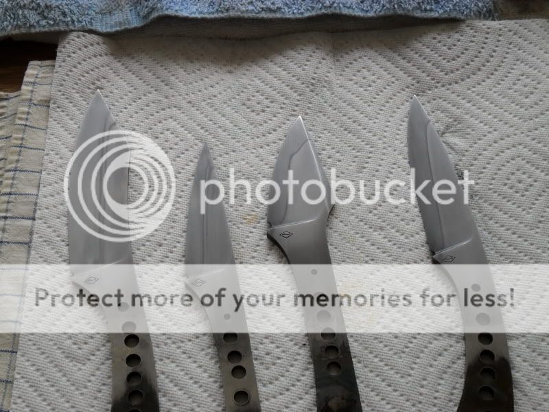

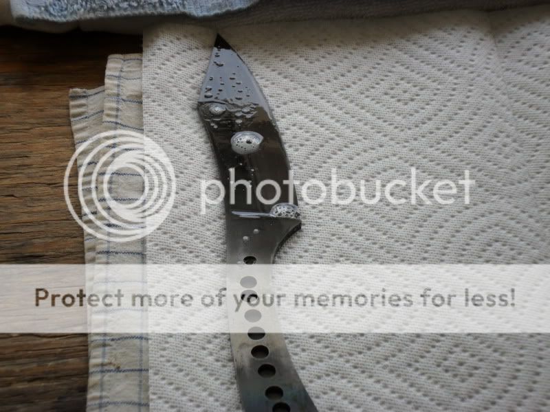

Ok, so being inspired by some awesome WIP’s lately, I thought I’d show a mini WIP of our etch process. I’ll do an entire WIP someday...
CAUTION! This is hot acid, be careful! Do not breath the fumes, work in a well ventilated area. This is a very fast etch, no you don't have time to go grab a beer...

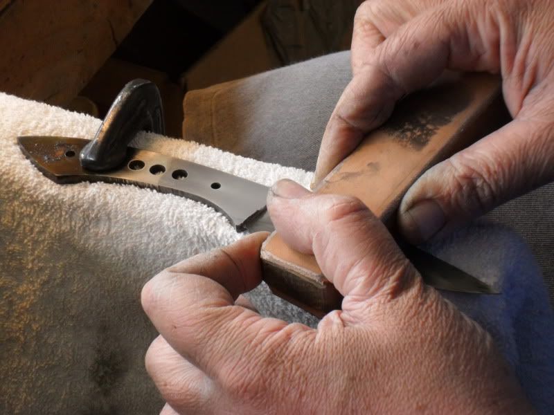

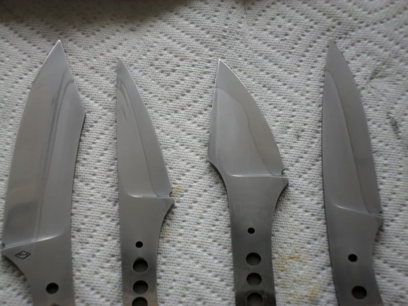

After heat treat, we hand sand our knives to 800 grit before etch.

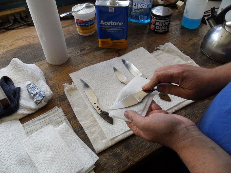

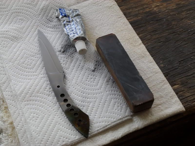

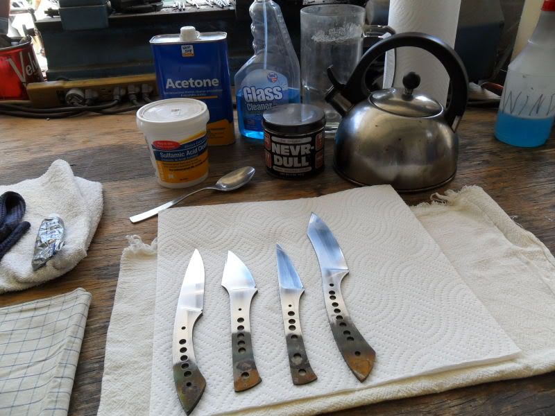

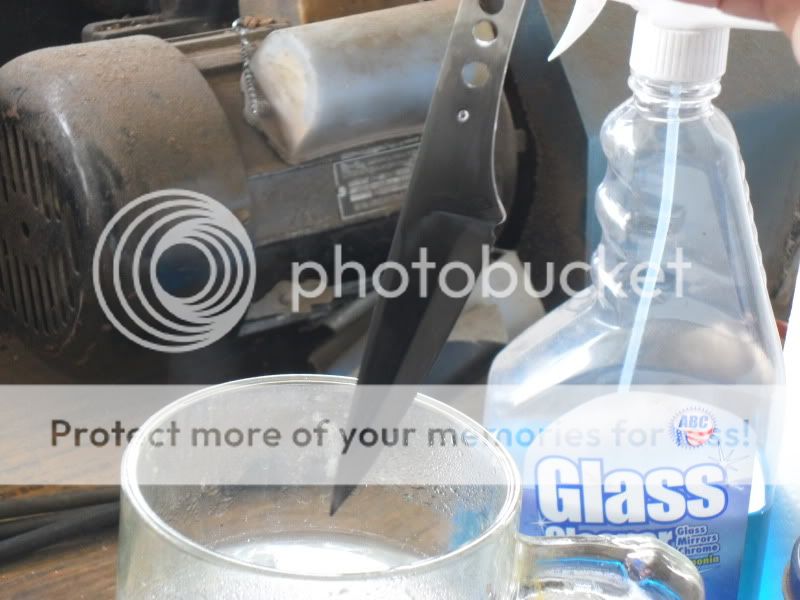

Then we wipe the knives down with acetone to degrease or the etch wont be even...
