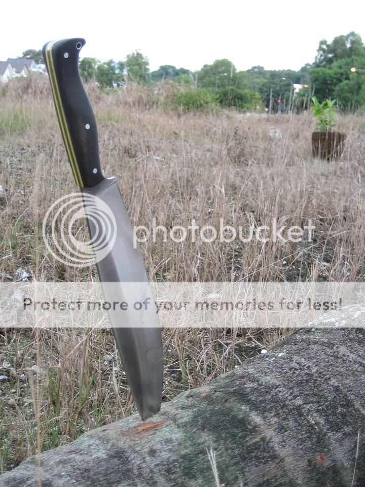

Big Chris Barong, 18" of sheer madness-
I, too, have a Big Chris bolo (some call it a barong, but I think it's more a bolo) in 3V. It's an amazing knife. Chris sent it to me with a very sharp 30-degree (inclusive) edge. I've been using it to cut back the woody brush along my mile-long driveway. Absolutely wonderful. When I come to 3- or 4-inch alder branches, I can chop through them in a snap, using the lower part of the edge and letting the forward part of the blade generate power.
