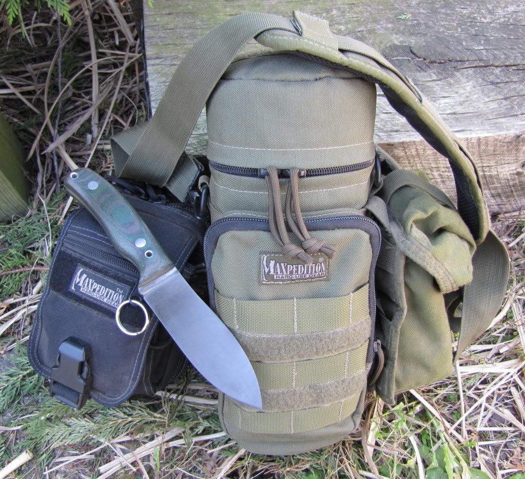

Here's mine with my water bottle holder.
Scott
The scales are turquoise/black canvas micarta. That knife has been used alot and the color has darkened over time. This is what the scales look like new, before it gets used.
