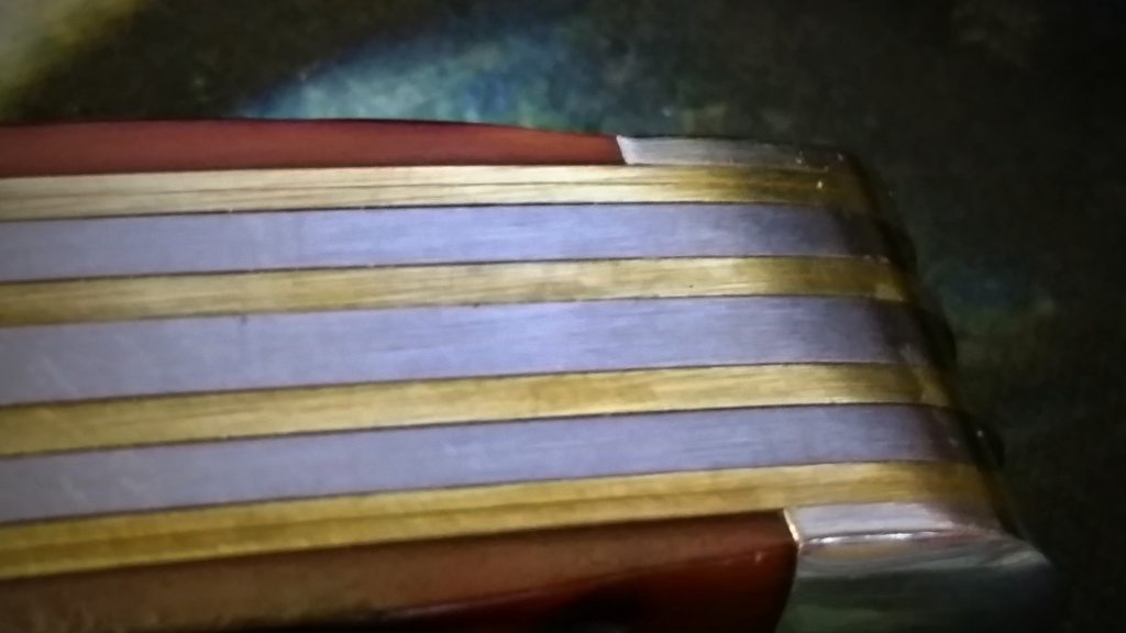

Here's a current GEC #66 Calf-Roper with 4-brass liners. On this knife it prevents the manufacture from having to krink all of the blades as "Obsessed with Edges" (David) said above.
From right to left - two lines laid together, a middle liner and the fourth liner against a cover.

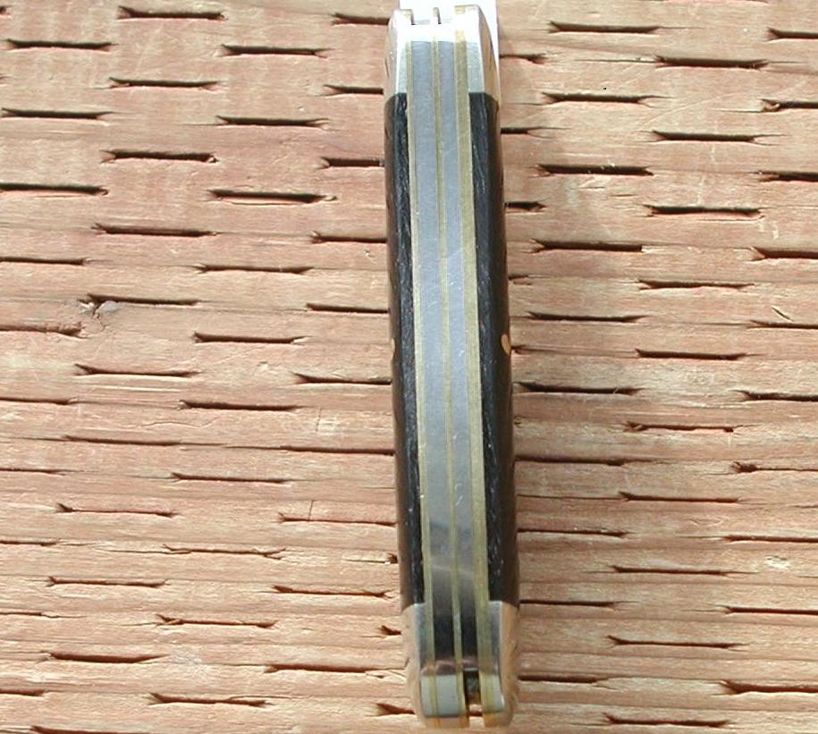

Here's a close-up of the bulky 3-layer Remington R-4 scout knife, made by Camillus, that is in my pocket today. Double brass liners on each bolster.
