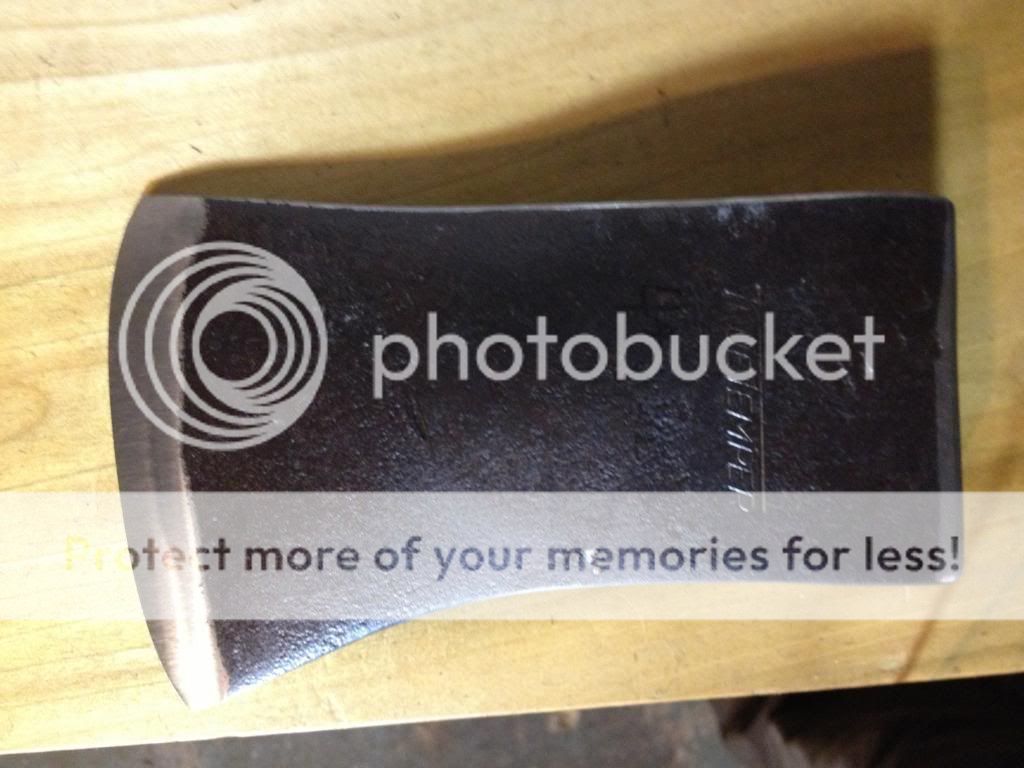

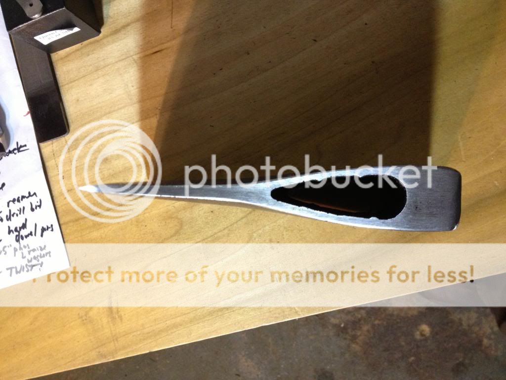

I finally got around to reprofiling and regrinding this True Temper 4 pounder. It has a good overall shape, but it's pretty thick even up near the cutting edge. I was thinking about thinning it out quite a bit, but then realized it might be nice as both a grinding experiment and as a splitter. Here's what I got.

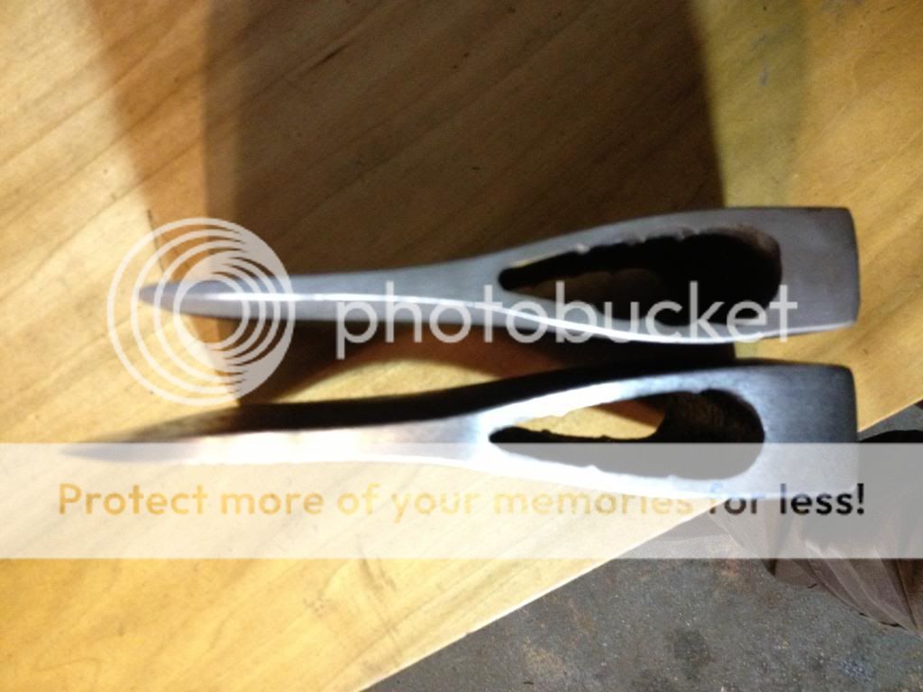

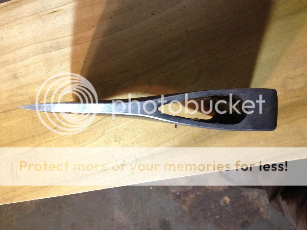

And here is the edge geometry. It's pretty thick at the top, but still has good high cheeks.
Here is the bottom, a bit thinner.

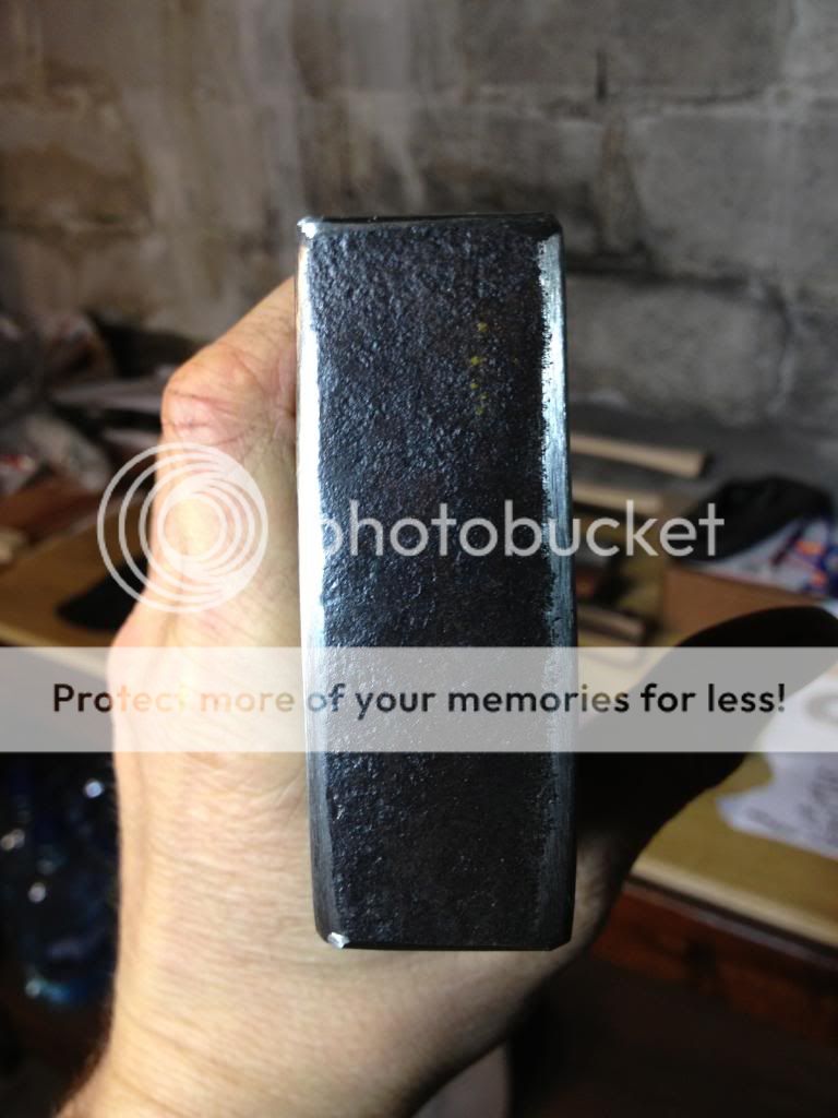

And although it is fairly pitted and did have some slight mushrooming that had to be removed, here is a shot of the poll just to show it wasn't abused, just neglected.
And here is a final one next to a 3+ pound Connecticut, just to show both its thickness and overall size.
Now for some final thoughts on the grinding experiment. I really liked the bevels SkogKniv was laying down on some of his axes, so I asked him about it. He directed me to a video of him slack belt grinding, which is what I did for this axe.
1. Sharpest edge I've ever put on an axe. This thing is a bit thick, but it slices paper and shaves hair no problem. Will make a good combination splitter/chopper.
2. Difficult to get the thin edge geometry I wanted without grinding a lot of patina off the back of the axe.
3. I messed up the profile a bit, shortening the top and bottom of the edge (see first photo). I knew this might happen, but i wanted to see what would happen if I took a dinged up edge and ground it only with the slack belt. Next time I will reprofile first, true up the edges, rough grind parallel on a wheel, and then only finish on the slack belt to blend everything together.
Thanks for looking and any and all advice/comments appreciated.
I think you're right on the mark as far as using it as a splitter first and a chopper second. 4 lbs. makes a dandy splitter and the edge profile is right. The other place an axe like this is useful is as a knot-buster/limber. The fine profile of a dedicated chopper/feller shouldn't be risked on hard knots. Too easy to fold or chip an edge.
I folded the edge of a Craftsman hatchet last week. I was trying to knock off a few cedar knots. I figured - it's cedar, soft as can be, right? Knot!
The wood might be soft but the knots are still hard.

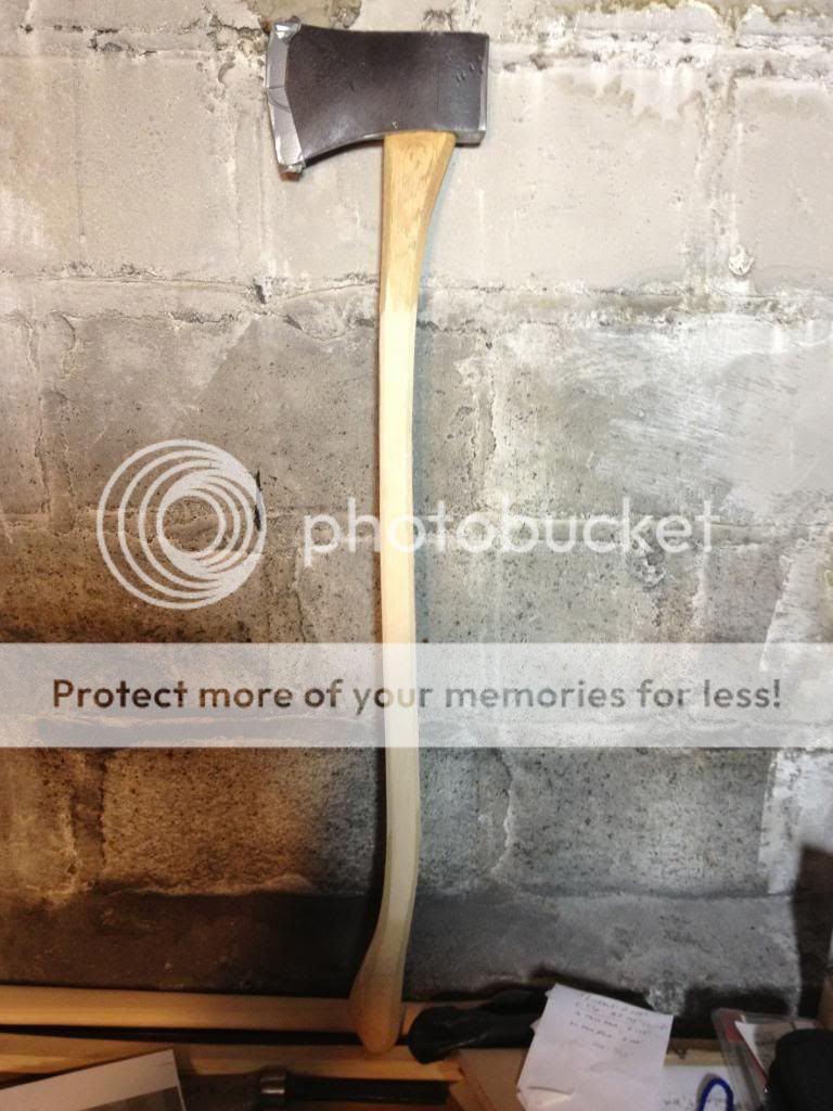

Got this one hung.

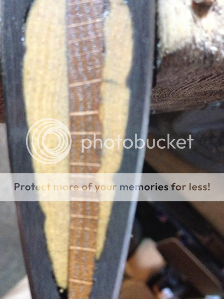

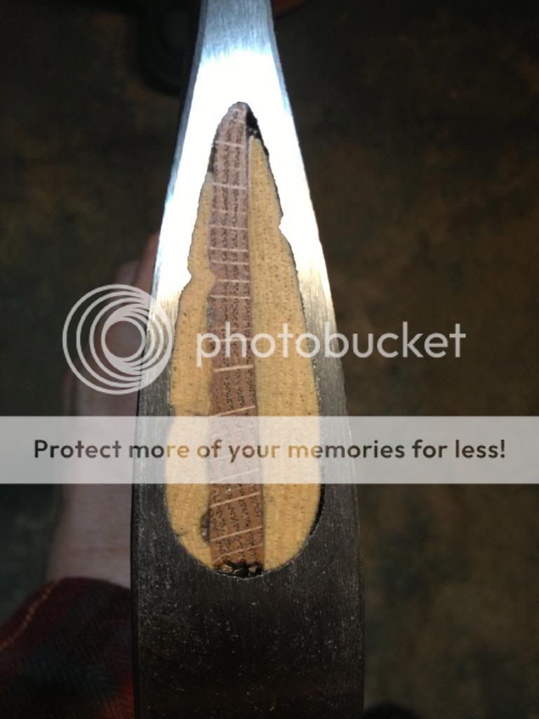

The only handle I had left was in pretty poor condition, uneven/chipped kerf, lopsided grind, overall fat, etc. So I used it as a chance to try a few new things.
1. Shaped a wedge out of quartersawn oak, which deformed in some interesting ways.
I didn't completely fill all the voids, but considering the fairly miserable state of the handle when I started, I'm pretty happy.
Here it is hung, but with a pretty fat and lopsided (not really octagonal, bulging on one side, etc.) handle.
Now here it is after being thinned and trued up on the grinder.

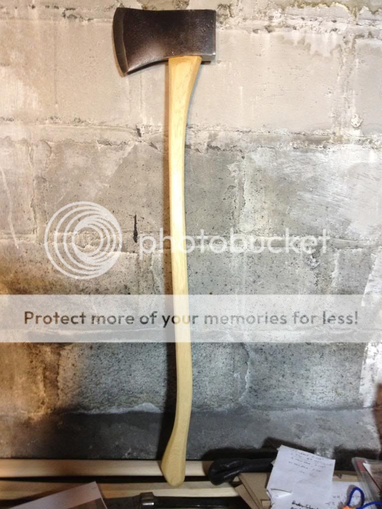

And here filed, sanded, and one light coat of BLO.

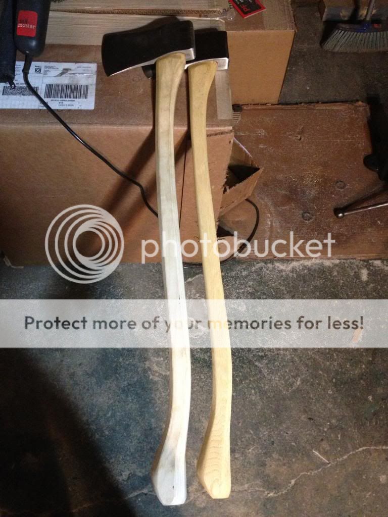

Finally, for comparison, next to another 36" handle from House that I didn't work down at all.
This slimmed down version feels alot better in the hand, and still has plenty of meat left.
That's getting awfully close to the 'too thin' point on that handle. House handles aren't that fat to begin with. And with a splitter a little meatier handle ain't necessarily a bad thing. Just watch the overstrikes.
Thank you. I will be careful, and like I said this was somewhat of an unavoidable experiment with a handle that I was considering not using, so if I have to rehang eventually...
Also, compared to some of the older handles I have, it's not all that thin. They are all about 3/4 of an inch thick. The others range in width from 1.35 to 1.50 inches. This one is 1.25".
