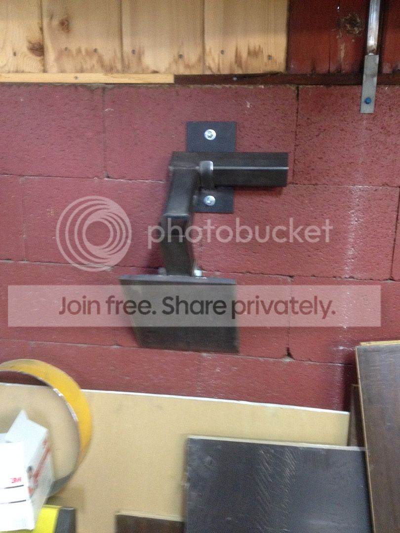

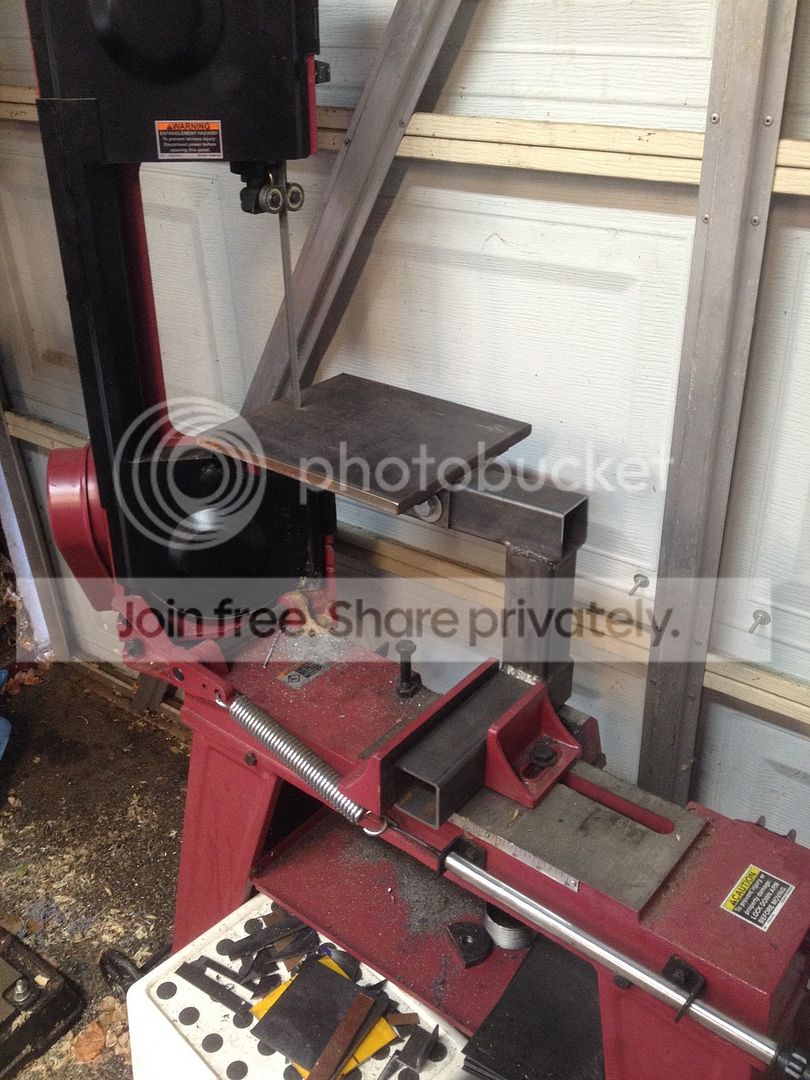

One mod I did to my HF one was to replace the crappy pressed table that needs to be unscrewed every time you need to use it in horizontal mode... Made up a table that mounts in the vise, and just hangs on the wall when not in use.

Now that's a good idea!
