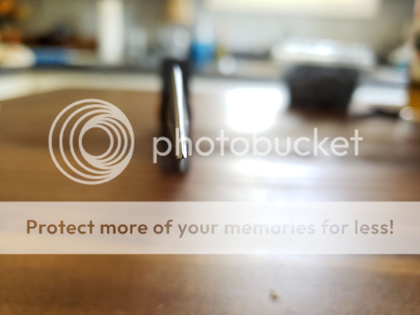

But this 499 (possibly from before tooj)... its bad... really bad. I am curious if this is the experience of others as well.
The edge is THICK, and from belly to tip is as crooked as can be. The knife is not at all sharp.
"Its what you should expect from a $30 knife"- its not what i expect from Ontario, or for any blade that says "madeinusa" on it, i guess i had hoped that the price was due to favorable supply and demand characteristics due to military contracts.
So whats up? Is this the norm, or did i get a freak monday/ friday knife that slipped through qc?

It's a thick blade with a pretty low saber grind so of course it's pretty thick behind the edge. It'll definitely get sharp enough to do some work, but it'll never be super duper razor sharp I imagine. Mine made plenty of fuzz sticks and shavings back in the day.

It will sharpen up just fine, it’s everyone’s favorite 1095 after all. You will need to thin and even the edge, they do come thick and not symmetric. I took mine to 20 degrees / side and then it cut way beyond expectations. The bevels were pretty wide, looked almost like a scandi at the end but it worked. Turned it into a decent field knife.
Off Topic- But why are all pictures posted from Photobucket blurry? Do you have to be a member?
