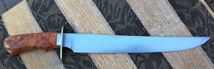

Hi all,
Finished off my first big knife the other day. 18" OAL, Eucalyptus burl handle, blade is O1.
Hidden tangs are hard. I wanted to pin this with a 1/4" mosaic but wasn't confident with the location of the hole in the tang. The hole was oversize, and I used a stencil to determine the hole's location, but I think I left too much slop when I hollowed out the handle.. I just couldn't be sure I was going to drill though the hole and not hit the edge of it and ruin the handle.
...None of it's easy, but I learned a lot for next time. Can't wait to try another and get it right.

Have you tried a larger version of the 3pt straightening jig? Perhaps a couple of 2x4's on the ground and a gentle downward pressure with your hand or foot?
Great looking knife. I still find it hard to make hidden tangs even with the great tutorials on the forums, I struggle.
Rick

Thanks Rick, glad to know I'm not the only one who struggles with the hidden tangs ;)
I'll give your suggestion of using 2x4s a try, going larger makes sense.
Cheers mate
