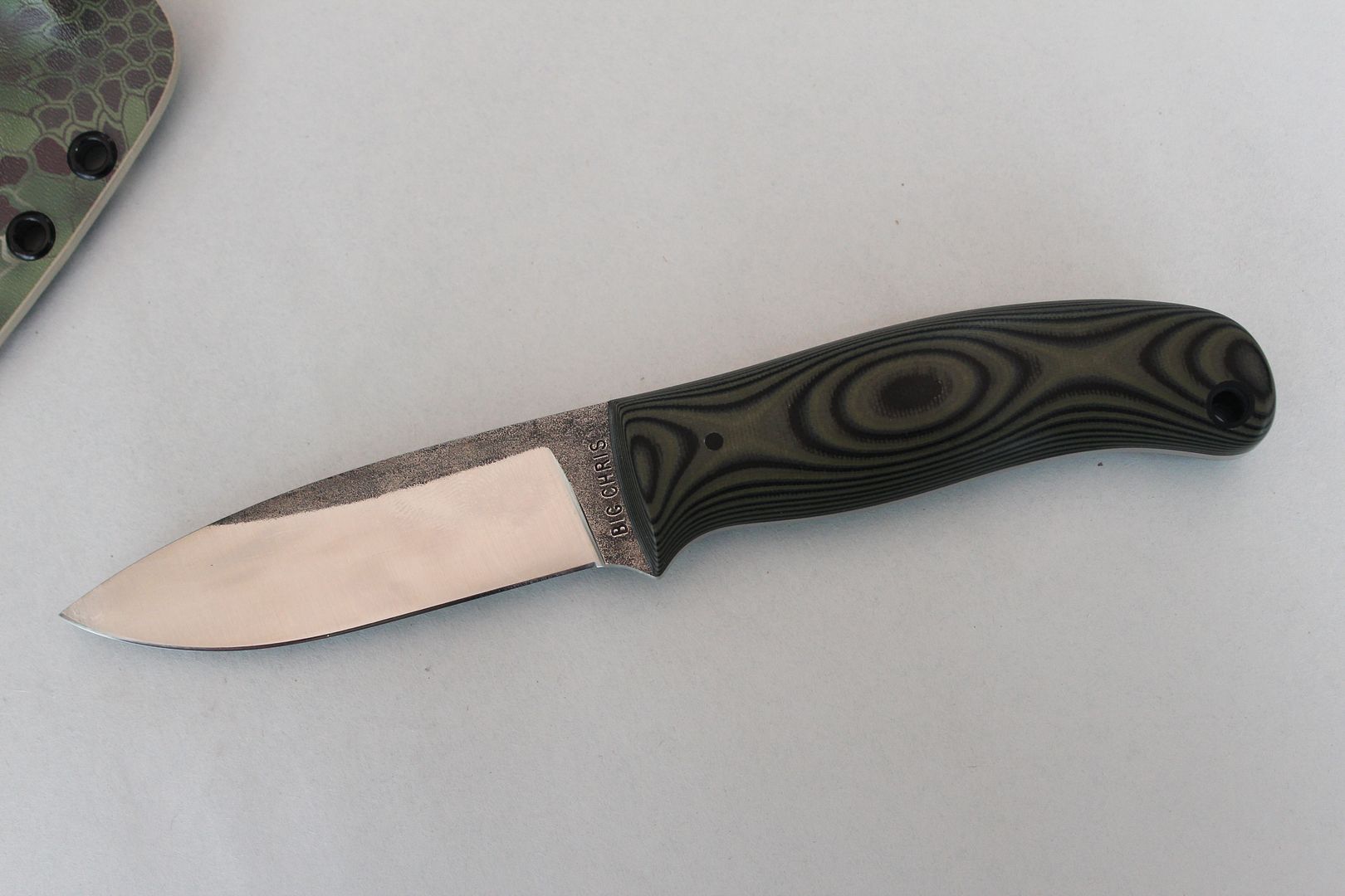

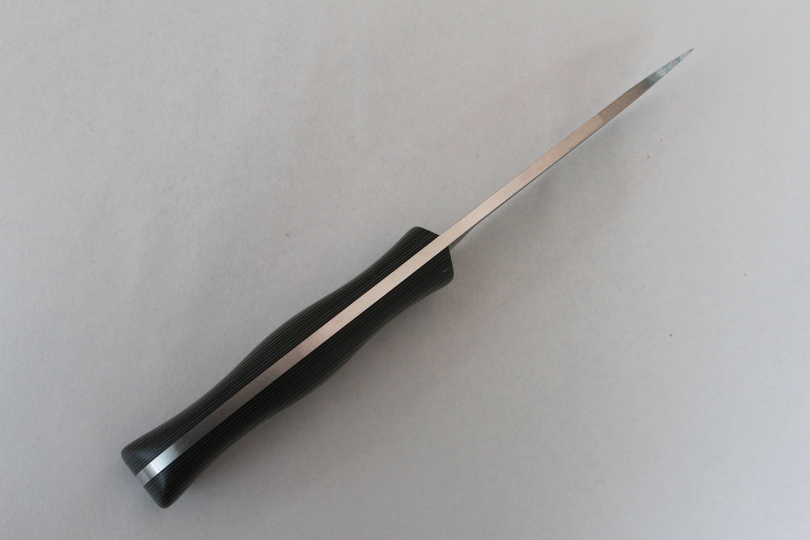

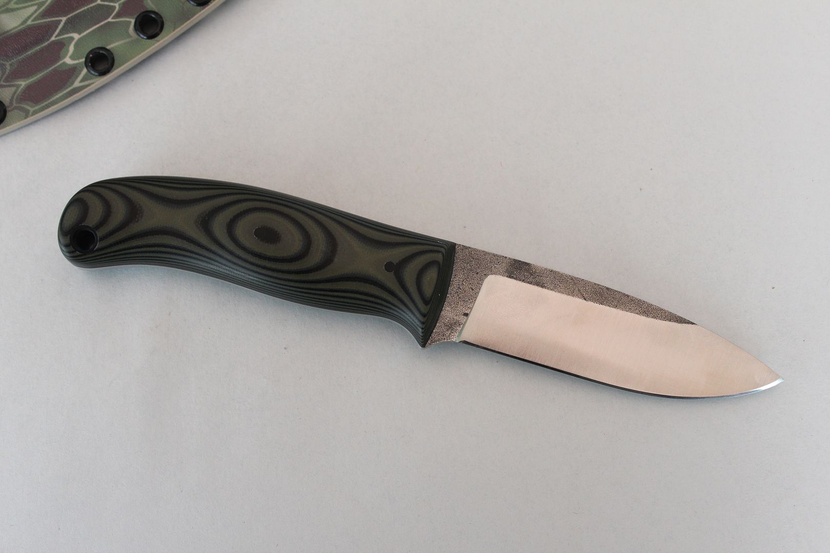

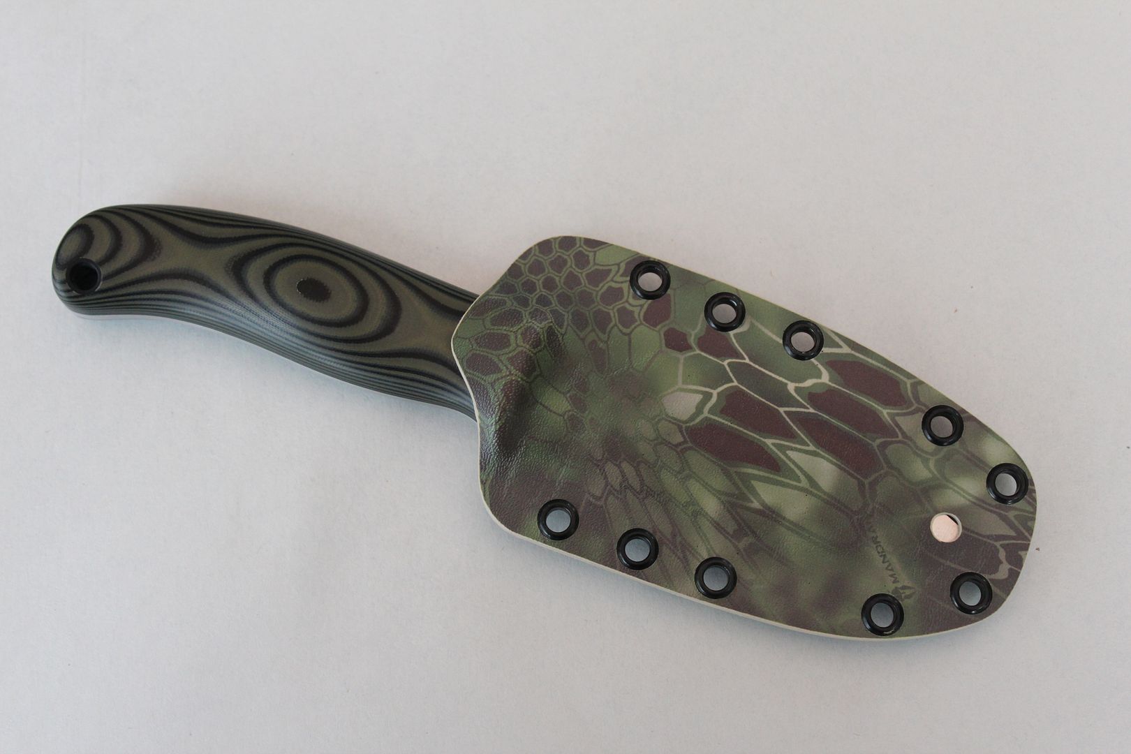

I have expressed some interest to some about the possibility about doing a passaround with a 4V knife. It will be a newer patterned knife that I have only made a few of.
The knife also has a bit of a Bushcraft flair to it.
Here is the completed knife in question:
Specs:
.152" CPM 4V
8.7" OAL
4.15" Blade
Heat Treat by Me to a 63 Rc
High Flat Grind
G10 Scales Highly Sculpted and Contoured
This Handle is Extremely Comfortable
Kryptek Mandrake Camo Kydex Sheath
I will be carrying and using this knife for a couple weeks while I figure out the details of the passaround.
I am using this thread to gauge interest. The actual passaround sign up will be carried out in the Pass Around sub forum. Updates, reviews, thoughts, and progress can be posted in a thread here that Mrs. Big Chris can sticky for us.
If you have any thoughts about the knife or interest in the passaround please feel free to post here.

I am currently working on a dangler belt carry system that will accompany the knife.
I really like kydex due to the retention and that it is not easily cut by a sharp knife. What I do not like is the lack of carry options for larger fellas like me.
I have made a few prototypes previously and am rolling what I have learned from them into this one. I think that the dangler setup is going to be the key on this one working out and making it for the long haul.

If possible, I'd love to try it. I have a bunch of steel in 3V and one of yours in M4. The knife looks great either way. :thumbup:
I'd love to get in on the passaround, the ergos on the scales look really comfortable. The sheath work looks very nice as well.
