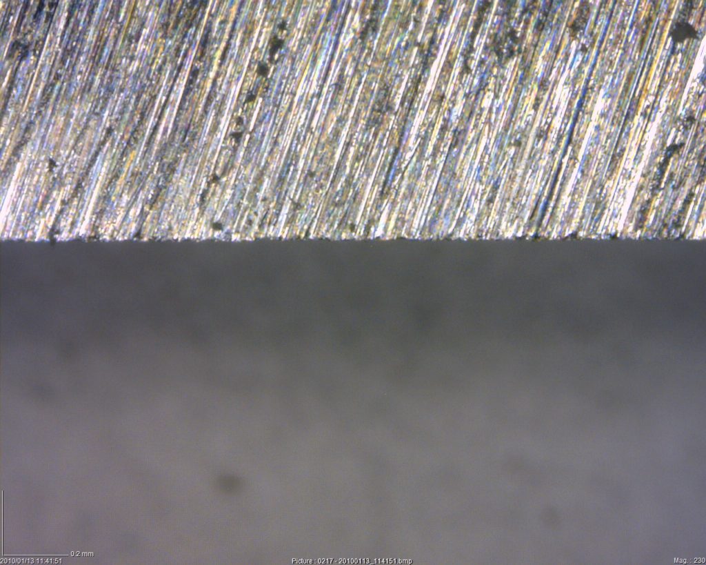

Just to be sure I am understanding you correctly, do your Post 7 photos above show an edge that has been apexed at 330 microns then finished at 22 microns? If so, do you know if there were any stones used between these two or did the sharpening just go from 330 to 22? Thank you....
Hi,
No its not what you get by skipping grits.
Its just the pictures from earlier ,
one on top of another to show the difference in "serrations".
See the full progression
https://support.wickededgeusa.com/portal/kb/articles/grit-comparison-table
It goes
330.50
50 Grit
165.00
80 Grit
122.00
100 Grit
69.50
200 Grit
22.00
400 Grit
