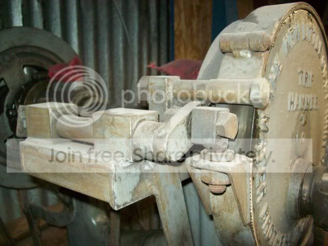

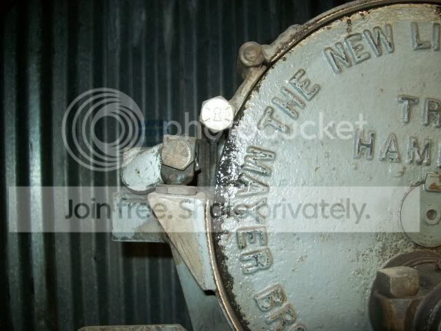

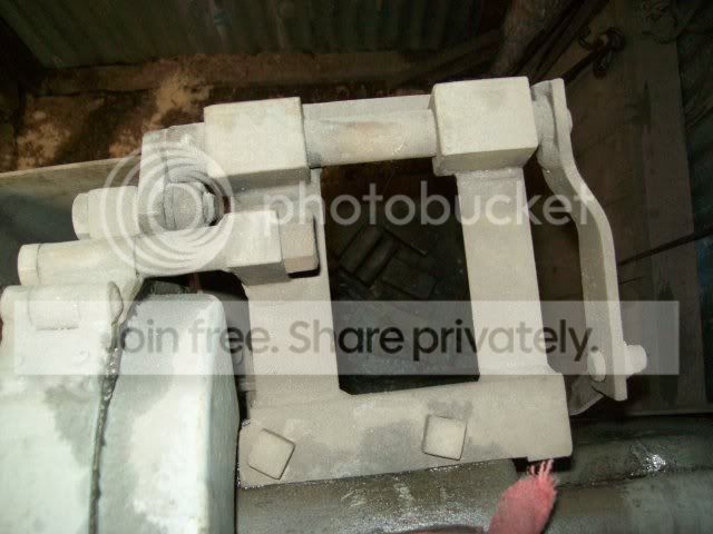

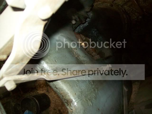

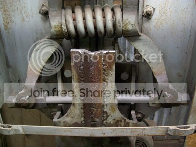

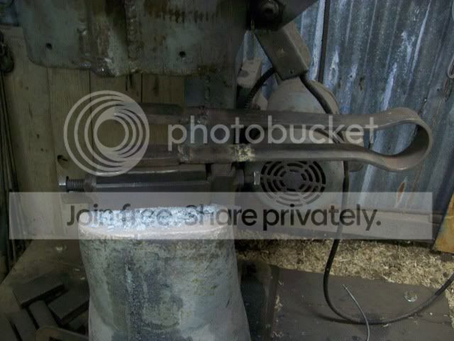

These pics were requested by a couple forum members so I thought I would do a new thread..maybe they will help someone..This brake was made by Danny Downs out of Louisville,Ky..Hes an industrial Blacksmith and a fine fellow..Poor guy has to live with a #200 Beaudry and a #200 Erie steam hammer now :rolleyes: But anyway :D Heres the pics..Also the last pic is of the toggle links he forged and made to replace the factory ones.He machines those ram guides new too. The air hose inside the spring Im guessing was there before the cage..
Now that brake looks solid, and pretty easy to understand. Thanks for the pics. I do have a few questions if you don't mind.
Is the brake connected to a hand, or foot control?
When braking for a single blow, can one have both hands free?
Did he turn the outside of the crankplate smooth, or not?
Is that leather lining the brake, and is it bonded on with barge or something?
Any idea why the hinge on top of the brake? Seems like it could be made without?
Would I be correct in assuming your hammer runs clockwise?

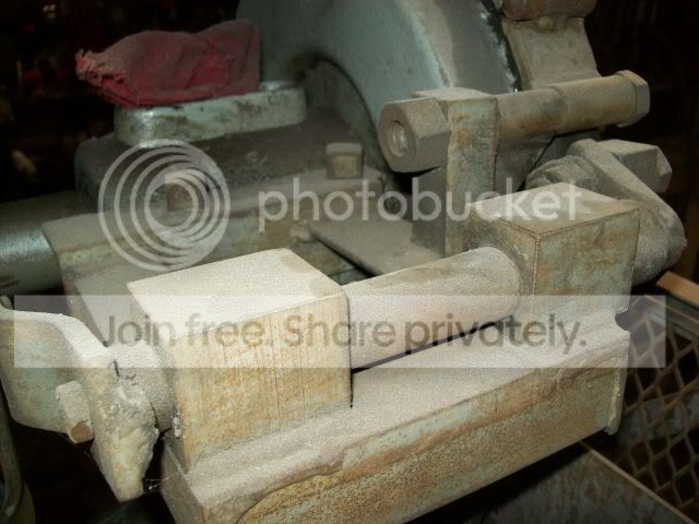

Here are some photos of the brake set up Sid uses. The material he uses is just brake banding, which is used on older tractors. The fly wheel doesn't have to be turned for them to work properly. The rough surface helps them bite better.

I just noticed on Kentucky's hammer. The arms are forged. You'll find this on older hammers. Their kind of neat.
Dave from Diller
Another really cool brake. I like the simplicity of how it's combined with the clutch linkage. I may try to build one like that.

* The brake is connected to the foot control***If you look in the 4th pic down thats the brake control rod attached to the foot control..Both were made by Danny for adjustment and less play..
* You can have both hands free..Works very well for top tools.
* No the crank face is left "As is"
* It looks like a type of conveyor belt, yes glued on..
* I dont know why the hinge is there Salem but I really dont think it has to be..It all moves as one piece anyway..
* Yes you are correct. Clockwise
Hope this helped..

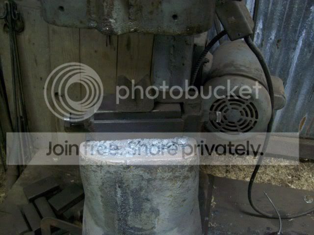

Regular ol' Blacksmithing is where it will make a big difference..I wa lucky enough for this to come with a couple of anvil saddles and some tools..heres a couple..Basically a hardy hole fore your hammer..Danny had an entire wall covered with these tools for his Beaudry..

Dave- I know beggars can't be choosers, but any chance you could please post those pics at a higher resolution? They are really clear as thumbnails, but when I click on them, they are so grainy it's hard to make out any detail. I have Sid and Kari's video and love their rebuild process, so I'd sure like to get a better look at the brake system they prefer. Thanks Dave! :)
Sure thing Nick, I was worried about that when I posted them. I'll slip out to the shop and a couple of better photos.
Dave from Diller
Here they are Matt, hopefully of better quality. These aren't really grainy, my hammers just that dirty.
Also a bracket could be made to attach the fixed side to your ram guide bolts, that way it would eliminate the need to drill holes. Same goes for the off side.
