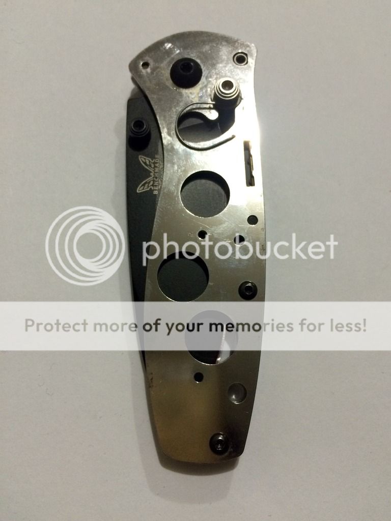

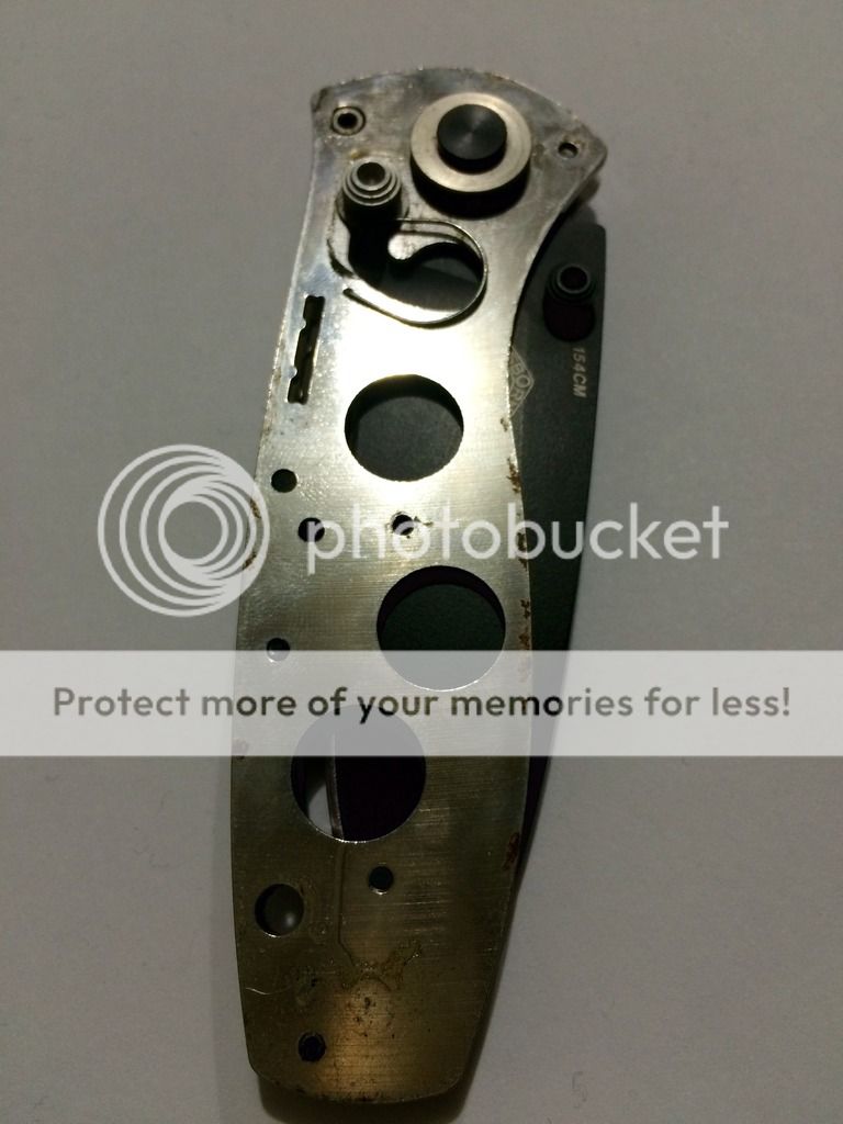

Folks I am pretty bummed out... Took apart my 585 mini barrage to clean and lube to find out both liners have rust spots at the edges... Below are some Pics...
I never thought this is even possible being these are stainless... I then try the magnet test (stainless aren't magnetic) and they stick to the magnet hard so I suspect these liners are probably chromed steel... One side looks cleaner because I use flitz to try and clean up but there are pretty deep pittings... Anyone else come across this?
What should I do? Would BM warranty this? It's a few years old that I got from a trade but I rarely carry it and it still look and feel new. I don't have proof of purchase. I deassisted it and I can't find the spring bar...
Do put the knife back and send it to BM?
Stainless just means it has a minimum of 10-12% chromium. There's no such thing as rust-proof steel, just varying levels or corrosion resistance. Also, not all stainless steels are non-magnetic. In fact most cutlery stainless steels (martensitic) are still magnetic. You can certainly send it to Benchmade with a note that you noticed rust. It's only cosmetic at this point, won't affect the action or function of the knife so I don't know if they'll swap the liners for you. But you don't need proof of purchase or anything so don't worry about that.

As stated above, all steels can rust. Perhaps the previous owner exposed it to unfavorable conditions, perhaps not. Either way, rust spots under the scales of a modified used knife is not what I would personally presume to be a warranty issue.

Having had many different knives apart from more than a few different companies, I can assure you that this isn't limited to benchmade. Unless a knife's liners are titanium they can develop rust. Usually I just see small spots of discoloration but some level of corrosion on the liners is fairly common on users.
Coat the liners with eezox or a similar rust inhibitor once in a while and it won't come back.

I've had rusted liners on a Buck Vantage which I had clipped to a first aid kit in the game pouch of my bird vest. Those are 420J2 liners, I think, but wet environment and there you go ... liners are going to be prone to rust because water can wick under the scales and unlike water on the blade, it sits there and works on the steel.

As an owner of a 585,I have found rust on the 420 SS liners which happen to be surface rust which easily wipe of with a bit of oil and a rag.There is another option,you could get one of those 1" round Dremel SS or carbon steel brushes for a rotary tool to remove the rust that was not easily removed.
That poor folder fell victim to a previous owner with sweaty mitts. However, it looks as though the knife was well-used as intended.
Benchmade used 410 stainless for liners back in the day, switched to 420J2 sometime in the 2000's, and has recently (in the past 2 years) switched back to 410. Some liners are black oxide coated and some are not, and both can develop rust. I've always noticed a light layer of a thin lube between the G10 scales and the liners from the factory on BM's, and as such I try to maintain this when I service my carry blades once or twice a year. That light layer of lube definitely helps prevent the oxidation that acidic exposures can cause.
Sorry she's got some rust, but as with methods mentioned, it can be cleaned up. I'd try removing all hardware, laying the naked liner flat on some 600 grit sandpaper, and going to town laterally, applying a satin finish until the rust is abraded away. Then applying light lube and re-assembling.
