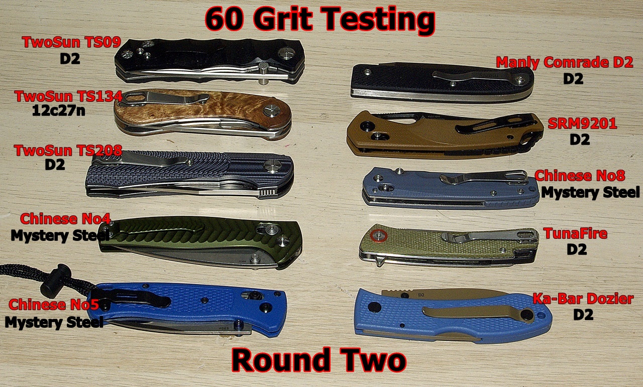

Yeah , time for round two ..
And we already have a result for the Ka-Bar Dozier @ 18 degrees ( 60 grit )
Another some what random choice of very disappointing knives .. Knives that have simply failed to live up to expectation in regards to edge holding ( for what ever reason ) .
550 slices , this is only a 250 slice increase on it's previous best .
Doser's Taiwan contractor knows D2, and your results prove that, as 550 slice results are not bad for ~30 bucks, though the 60 grit did not play well with the apex.

I find a great Variance in blade steel ..
It matters not what's printed on the blade .. Like that old saying goes ( oils aint oils ) And blade steel is only as good as it performs .
Not every knife responds to a set formula or method of sharpening .. So those knives that fail or dont do what you want ?
It was just a Lark to begin with ( what would a 60 grit grinder wheel do on my wet stone grinder ) and on disappointing knives the results are , sometimes awesome !
In this series , I have some Hard Steel ( D2 ) that does not perform as expected .. ( No edge holding ) ..
I have seen what the 60 grit can do for softer steels , what can it do for hard steel ?
TwoSun TS09 D2 - Factory 100Fail / 180grit 200Fail / 800grit 150Fail / ground 220grit 250Fail
65HRC file skates = No bite / Blade steel is very hard !
With a ground 60 grit edge :
Not sure what I was expecting ? But the knife returned some 400 slices with the 60 grit edge .
This is up some 150 slices over the 220 grit factory wet stone wheel .
I might have to put this knife to the white 80 grit wheel , since it did wonders for the Ganzo D2 .
Video Soon !

So here are the results to see more easily !
So for those that came along for the ride , I hope you got something out of it .
So some knives gave fantastic results , whilst others were more conservative ..
But no result is in the negatve , except for the one knife that rolled it's edge like a rollin champ .. ( Null and void test )
And some knives remained disappointing .. Well , when you buy a junk knife hu ?
