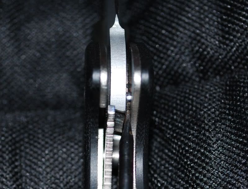

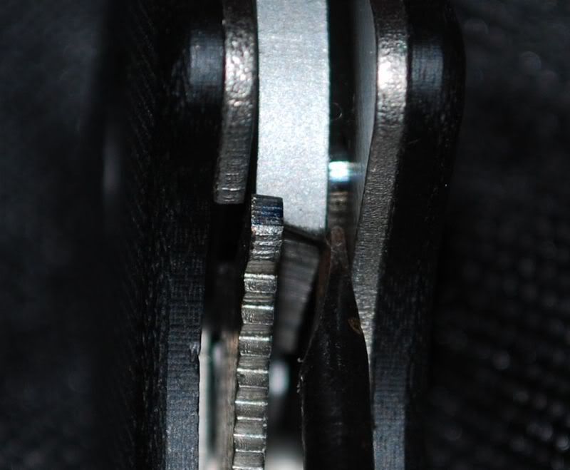

On all three of my Emerson knives there's a ball detent on the liner lock and there is an upper ball detent on the opposite liner ( a tab near the pivot). I think it's easier to see with the blade open.
I'm at work but when I get home tonight I'll see if I can photograph the upper detent.

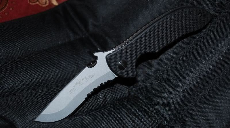

Here's a picture of my mini com and two views of the pivot/lock area.
The screwdriver blade is pointing to the upper ball detent.
