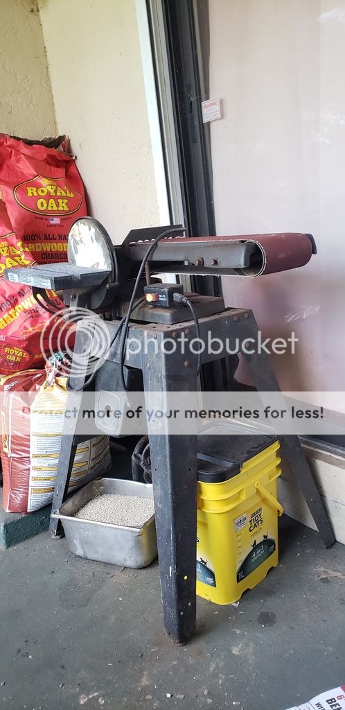

Hey guys, i just had someone give me an old and perfectly functioning craftsman 6x48 belt grinder with a 9 inch disk grinder built onto the side. Does anyone use one of these in knifemaking or find them useful?
Im pretty new to knifemaking still and currently use a HF 1X30 and was thinking that this 6x48 might help me atleast grind my knives down flat after my terrible forging.
Heres a pic for reference just in case.
I started with a craftsman 4x36 and it’s definitely better than not having it.
It will run relatively slow and be underpowered but like I said better than not having it.
Thanks for ur reply 3fifty7! Cool good to know. Didnt realize it would be underpowered.
I made a lot of knives on one until I got my 2x72. The ceramic belts last a long time. Now I just use the disc sander part of it and run it without the belt. The belt robs a lot of power.
They are woodworking machines and you can bog the motor if you get too aggressive. Also be sure blow it clean and free of any wood dust.
Make sure ya read the link lots of good info there. I had one of those old Craftsmen bout a hundred years ago.
Sure, that will definitely be useful. I have ground many blades on a 4x36 grinder with a 3/4 hp motor in that same orientation (belt running horizontally). It's a different way of grinding, but it works. I added a glass platen and a koolmist to mine, which makes things more pleasant, especially since these things are single speed.
Do I want a better grinder? Absolutely. But you can still do decent work on a machine like that.
