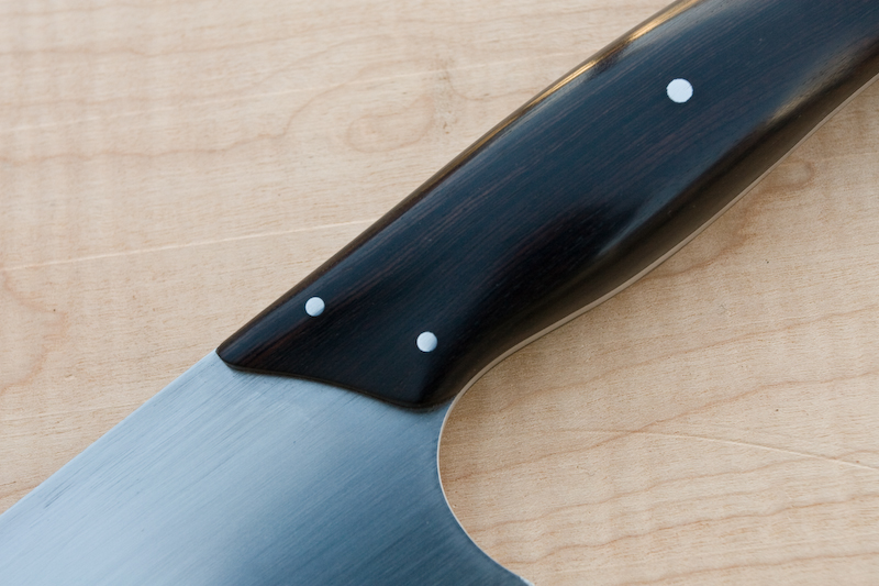

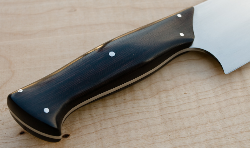

I just finished up my second chef knife. It's a big improvement over my first. Truly enjoyable to use; it has just enough weight behind a thin edge to make cutting a breeze. This knife is going to a culinary arts student, where I hope it will get a lot of use.
The blade is made from 1/8" thick CPM 154 with an edge thickness of .015". I worked this blade with files and sandpaper; it was a real exercise in patience. The handle is some beautiful quatersawn blackwood with very tight grain.
