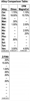

Here are some available steels from Alpha Knife Supply, they only sell quality steels, which means they're not going to sell 9Cr18MoV
Z-finit has less chromium in its chemistry (15% Cr) than Elmax (18% Cr) yet, its significantly more rust resistant than any other available martensitic stainless on the market besides Vanax. The new CPM MagnaCut has only 10.7% chromium in its chemistry yet is also significantly more rust resistant than Elmax at 18% chromium. In fact, Spyderco moved MagnaCut to their Salt water knife line since it did so well in testing.
So, you shouldn't select a steel based only on its chromium content. Thats not how that works.
I recommend getting some more reading about knife steel from a reputable source.
www.knifesteelnerds.com
There is several days worth of reading you can do there that will significantly improve your knowledge and understanding.

That's awesome info. I really appreciate the explanation! I was confused and thought that more chromium = more corrosion resistance. I called AKS and spoke to a guy who told me about the Magnacut. I think I'm going with that steel. I know 9Cr18MoV is cheap, possibly sketchy, stainless, but I bought a knife made with it and it doesn't rust easily at all.
But, I'm going to go with the Magnacut. I want to use quality steel and not have to worry about what might happen down the road to my knives.
