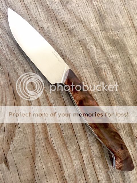

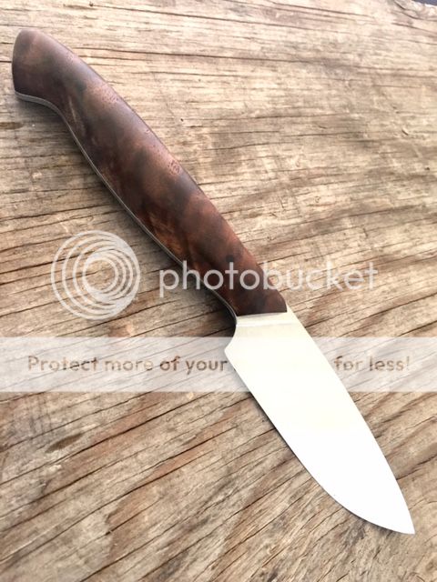

A big THANK YOU to John Gambino!!! I have lost track of how many of my knives he has in his collection. This is the 2nd of the Walnut hunters he ordered. This was my first knife using A2 tool steel and I enjoyed working it and heat treating it. Seemed extremely stable during HT, oil quenched from 1750F without issue, dry ice/den alcohol sub zero, 400F tempers. ~62-63HRC. Just a simple hunter, but thanks for looking!
