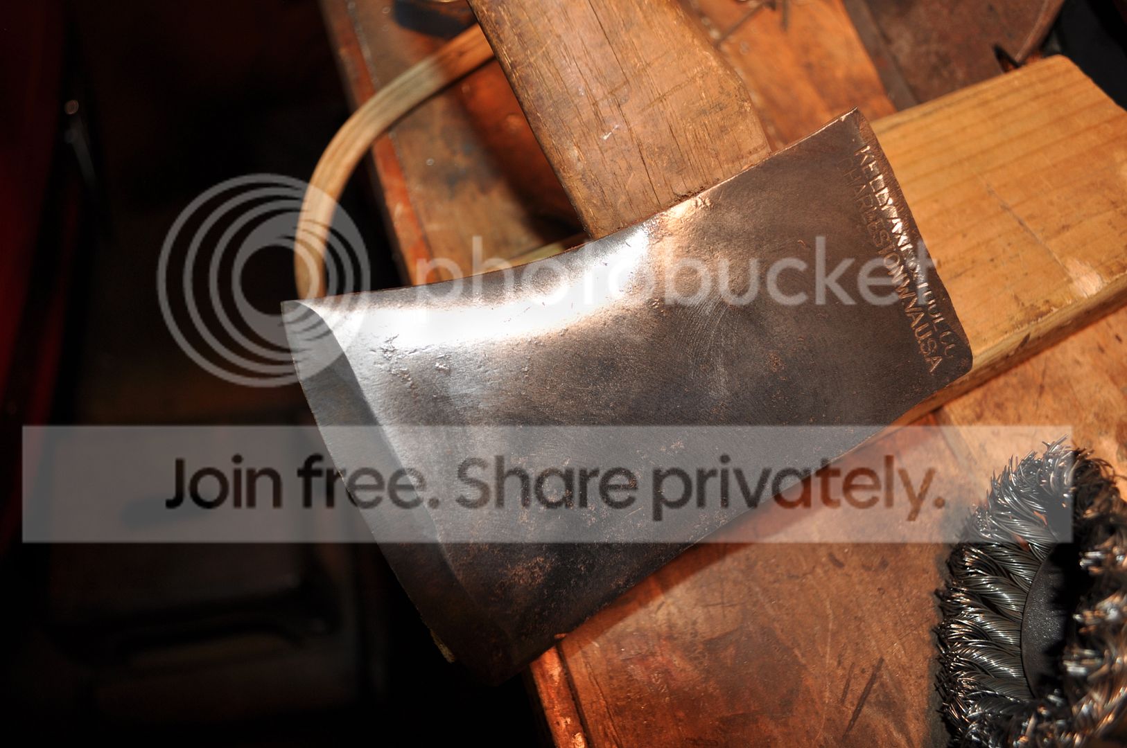

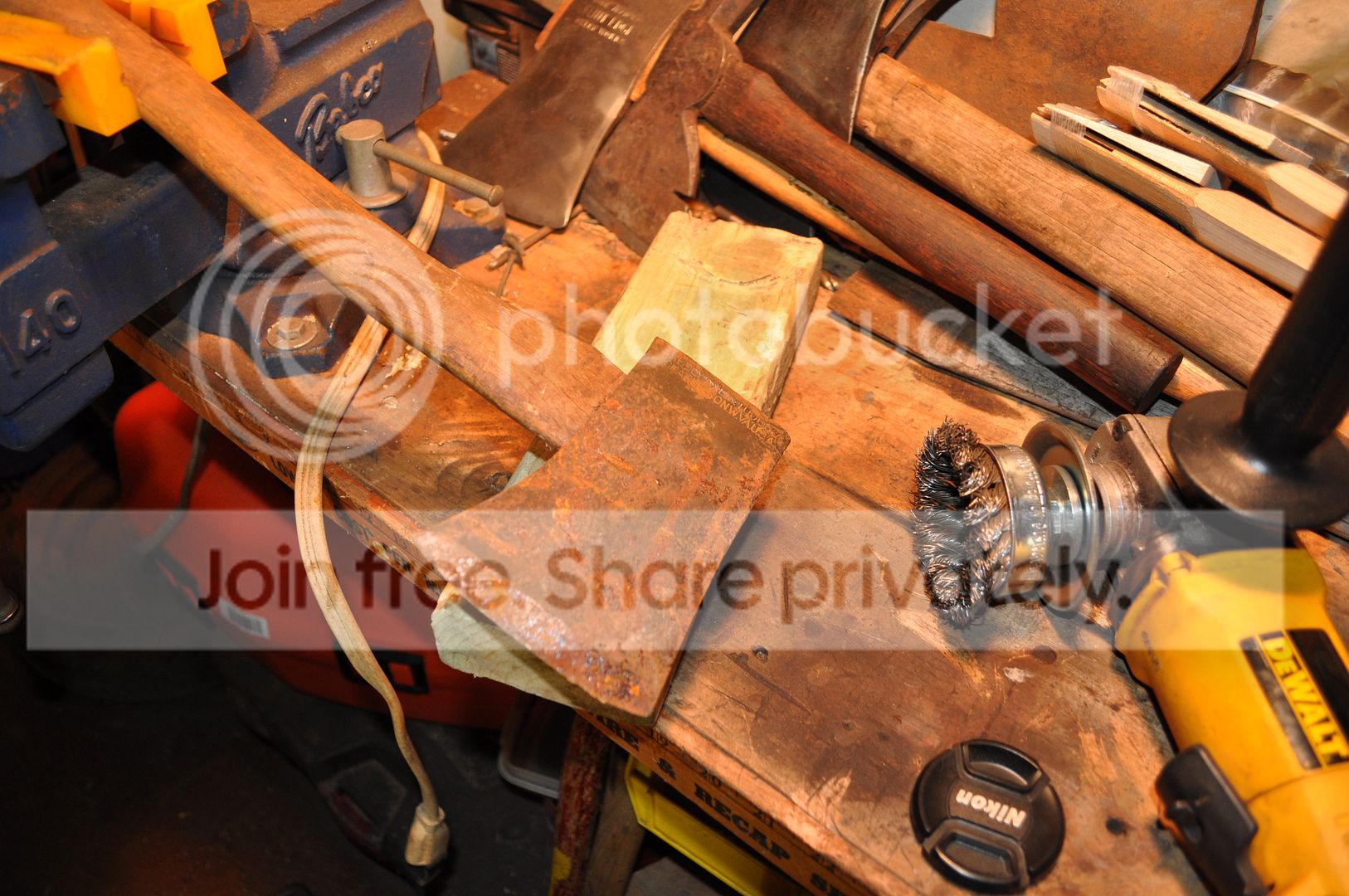

I've been hitting garage sales this summer and I've picked up 10+ axes and hatchets so far this summer. Here's a Kelly hatchet that I paid $3 for a few weeks ago. I got motivated and I've put her back in working condition.
How she came home
Initial clean-up w/ an angle grinder & course wire cup

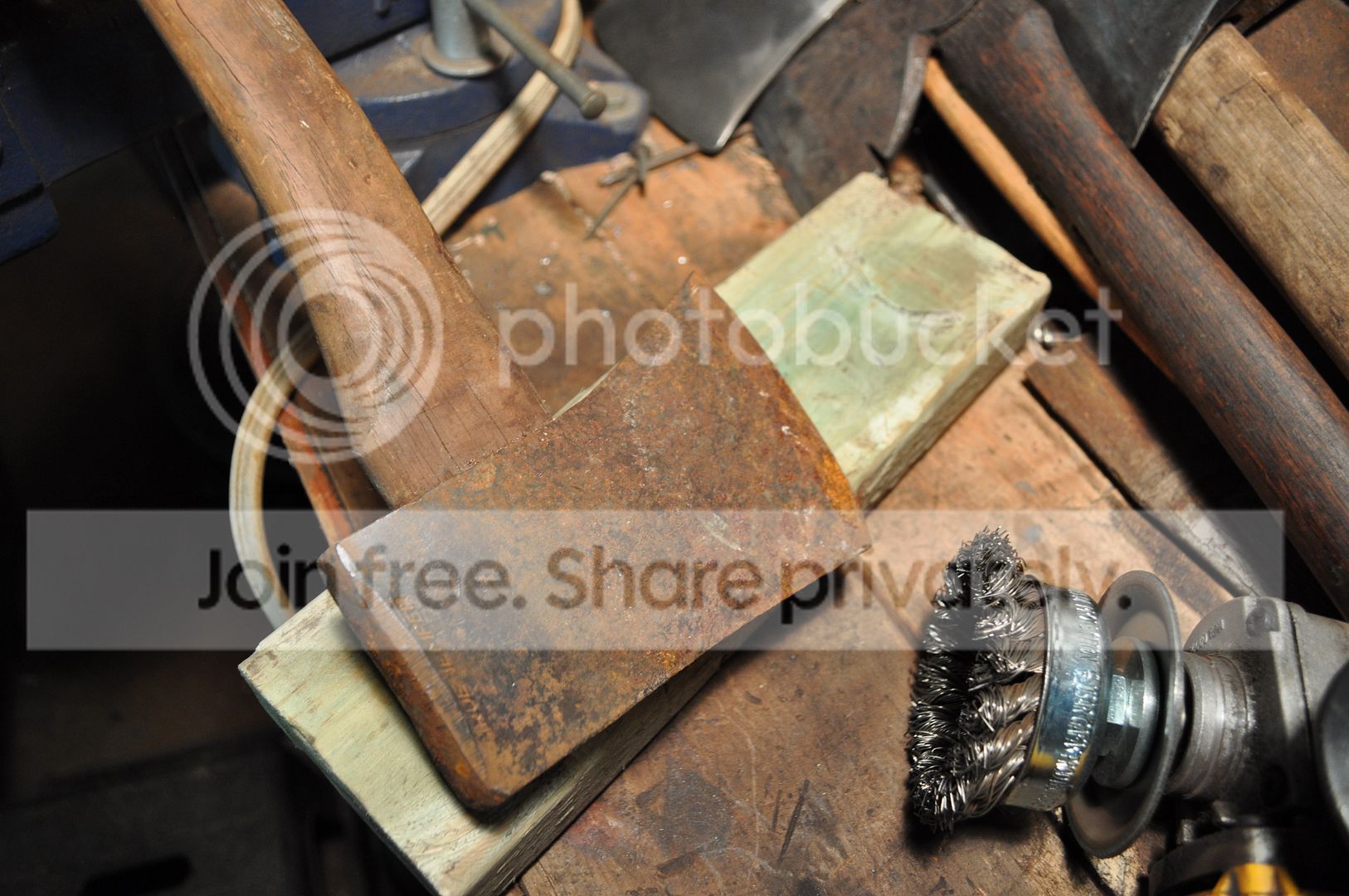

Flip side as found

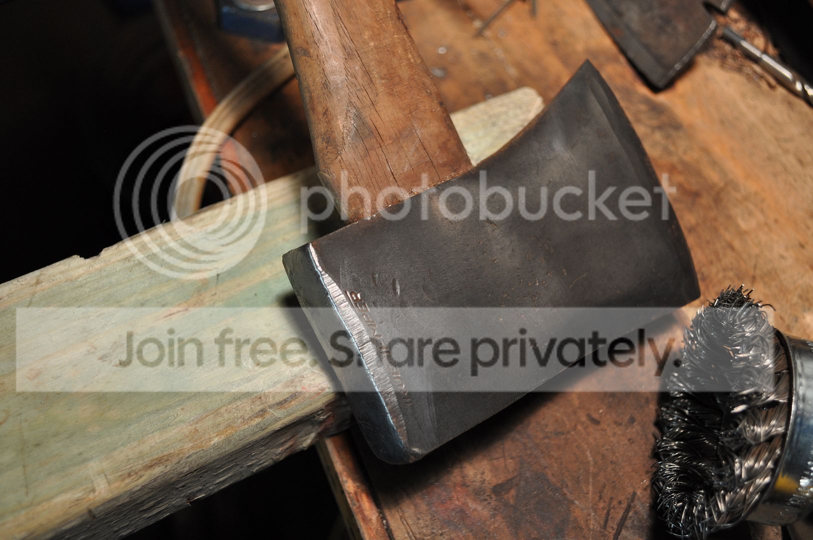

Some more angle grinder work to remove all the rust. The grinder leaves a nice patina on the head. No vinegar bath needed.

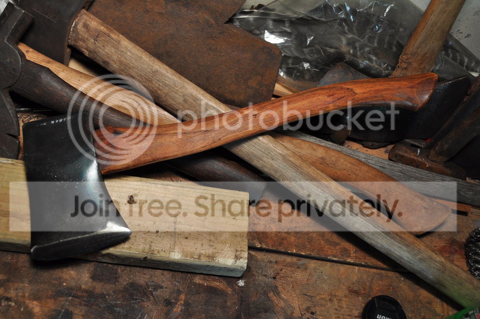

Haft sanded and treated w/ BLO, she will get a few more coats.
Specs: 5.5" bit to poll, 3.75" on the bit, 17.5" overall length, approximately 2 Lbs. 14 Oz. total wt.

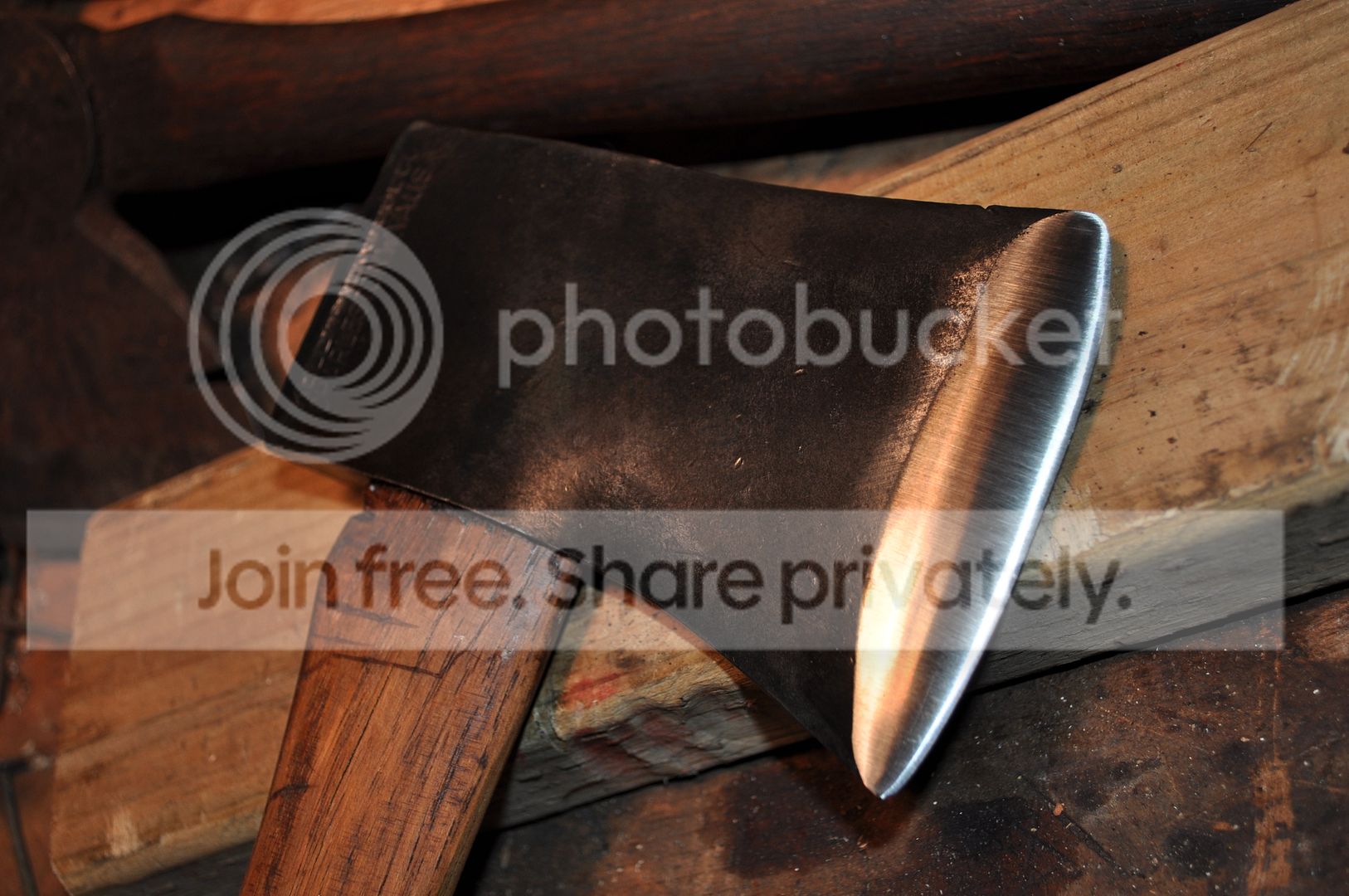

After more work with the angle grinder to remove all the rust, i did the final work and re-profiled her edge. Do to the hack job that was done on the bit, I used a 1 X 30" 180 grit belt to profile her. Shes ready for some work now
Not to shabby for a $3 hatchet. Beats the heck out of a hardware store hatchet and she has a pedigree. I really enjoyed working on her, saving vintage steel.

Really nice work. You using a belt grinder?
Another winner, Tom! Good on yer for saving another vintage piece! (Credit to Frank for the phrase "good on yer")
Mphis, Yes I did use a 1 X 30" Delta grinder on her, used a 180 grit belt. She had a hack job on the bit that really needed some TLC. I have a small bucket of water on the floor and cooled her down when she got warm. Slow and easy did it. I edited my post to clarify it.
