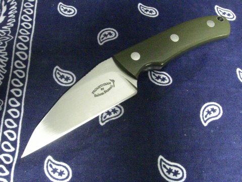

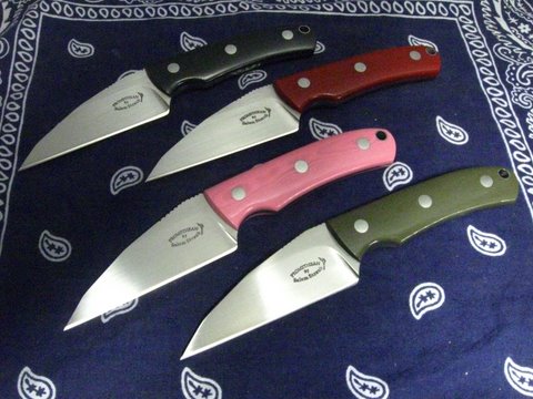

A batch of four wharncliffe utilities in S90V, G10. A bit different for me.
Oct 20, 2008
5,547
This ain't my usual style - but I try to be versatile. So, these have straight edges, thumb jimping, techy stainless, and pink G10!
Anyway, that's the latest off my bench. Hope you like.

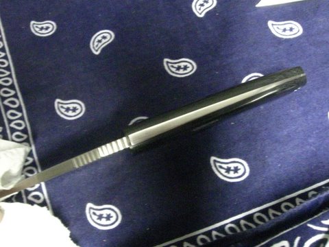

They have a pretty flat handle profile which suits them nicely. What thickness G10 did you start with?
I have a piece of 1/8" by mistake and amn't sure how much shaping room there is with such a thin piece.

Thanks for looking, guys. Daizee, most of these started with G10 in the neighborhood of .250. The black one is actually canvas micarta, and started as a block. 1/8" G10 is a little thin for larger fixed blades, but can be fine on a non-tapered, fairly thick full tang. Or, you can put spacers in to thicken the scales a little.

Great work, Salem! What are the dimensions? That looks like a radical taper on the tangs. Well done.
