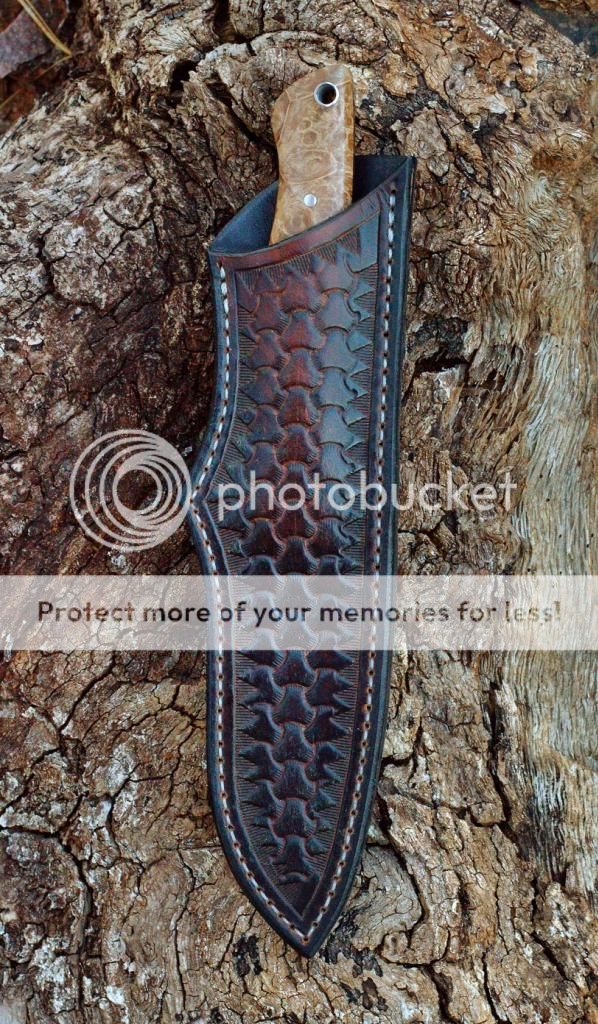

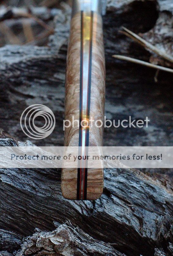

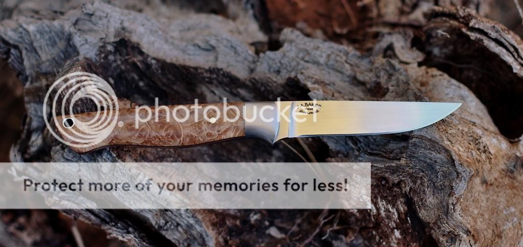

Bird and Trout
3 7/8" ATS34 blade, cryo hardened to 61RC
8 3/8" overall
1/8" thick at ricasso
tapered tang
Stabilized curly maple scales with black and cinnamon spacers

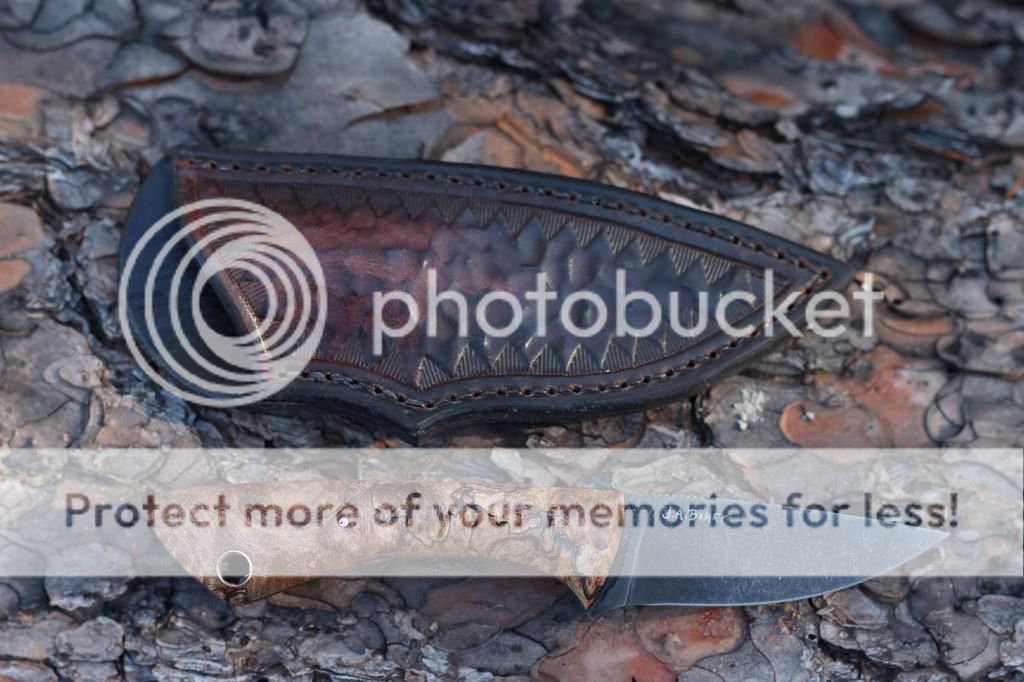

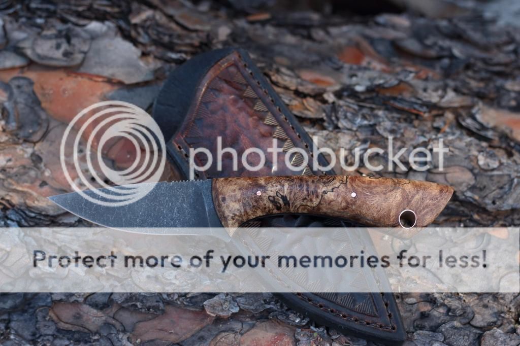

3 Finger Necker
2 1/8" 1095 stonewashed blade
5 1/2" overall
3/32" at ricasso with tapered tang
Stabilized spalted maple scales with black spacers
Tooled leather pocket sheath

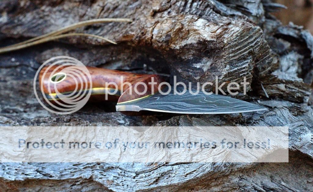

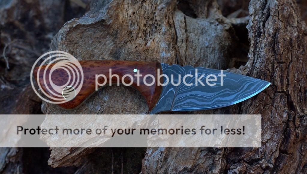

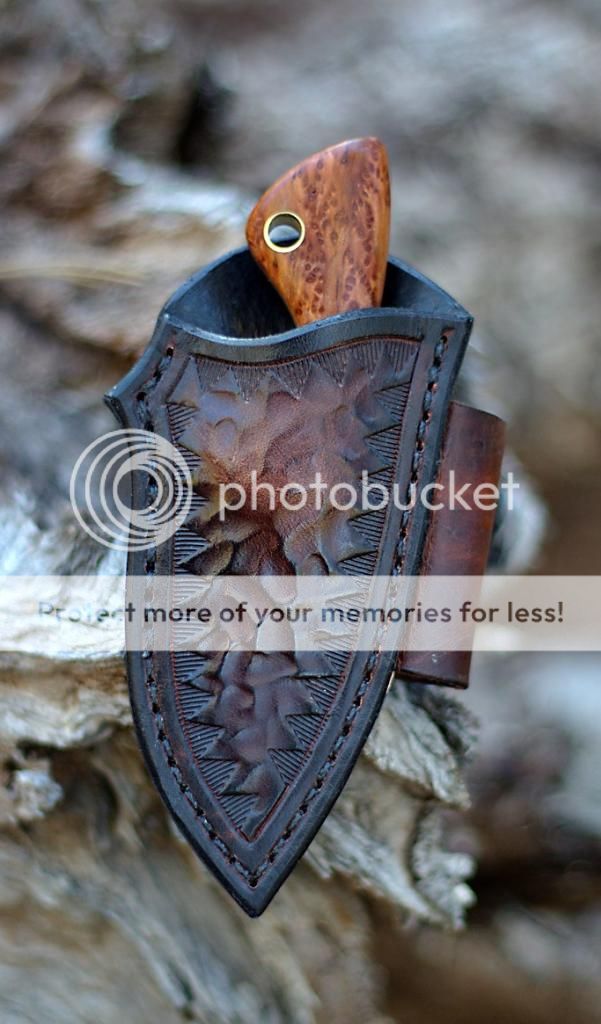

Small Necker
2" Damascus blade
4 3/8" overall
Tapered tang
Stabilized redwood burl with brass spacers and pin/tube
Leather cross draw sheath

Thanks for sharing the pictures all 3 look great especially the Damascus Necker ;) , appreciate your hard work on these knives & for helping us out with texting the wood choices from K&G that was really helpful in choosing the correct combination of materials, you don't get this kind of one on one treatment from many knife makers "if any" !!

Been carrying and using the maple 3 finger all day. Great little knife! Thanks again for your hard work and dedication to your customer!
