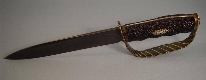

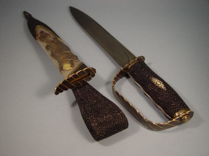

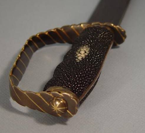

Needless to say I was excited and pleased when my Grandson asked me to make him a knife for his 13th birthday!
Hed liked the first knife Id made with the octopus on the sheath, so we talked about what hed like for his knife. He described a knife of good useable size with a metal sheath, a Damascus blade, some finger grooves on the handle with a trigger-guard sort of guard, and the rest was up to me.
Unfortunately he asked me to do this only a week before his birthday, so he ended up having to wait a bit for slowpoke me to get it finished. He also lives about a thousand miles away, so didnt get to see it til it was finished.

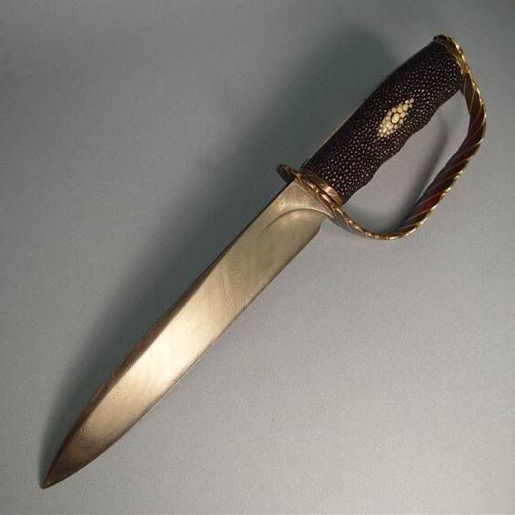

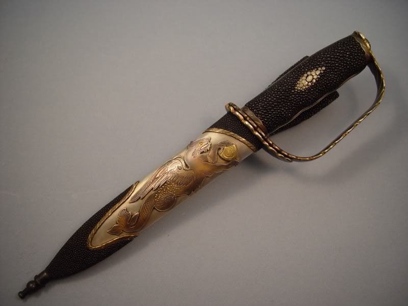

So this is how it turned out. The blade is a ladder pattern Damascus that I ground/filed from a larger blade. The sheath and dragon are sterling silver. The skin covering the handle, part of the sheath and the frog is black stingray skin. The guard I made by twisting three pieces of mild steel round bar together, then brazed the mess together, pounded it flat, and filed and bent it to shape. I made the smaller pieces bordering the skin the same way, using some mild steel wire. On the back of the sheath I soldered on a brass plate and engraved an inscription to him.
This was a departure from my first knife and really fun to make, especially since it was for my grandson!
And yes, hes happy with it.
Comments, critiques are certainly welcome.
Thanks for looking, John
