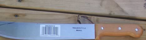

The regulars know that I've been lusting after a bowie, a sheffield bowie, but haven't been able to find one that works for me, and for the credit union.
I was reading and found out that many of the old bowie blades were much thinner than modern knives, under 1/10 of an inch. Certainly not all of them, but many of them were that thin, kinda makes sense when you have to carry everything you need, to make stuff as heavy as they need to be, but not an ounce more.
The knife that made Jim Bowie famous was reportedly a butcher's knife. A knife that grew and changed from there, regardless of which history you choose to believe. Butcher's knives are often thin...
I've got a book by Bagwell, about battle knives and devoured the section where he suggests modding a Great Western bowie. $80 is a little steep for a learning project but I thought about Tramontina's machetes being $6 and Tramontina machetes were reportedly around 1/10 of an inch thick....
Seeing where I'm going?

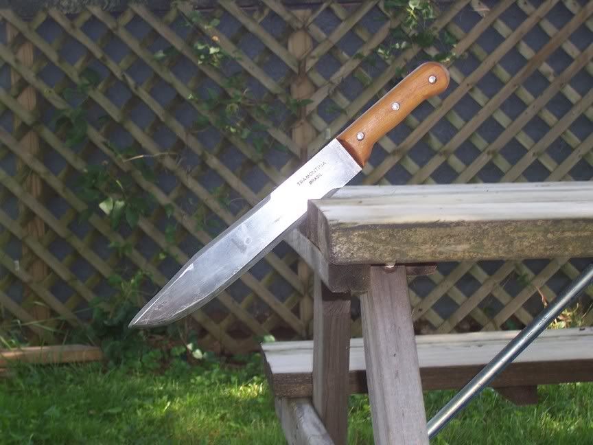

I was looking at the end of the knife, at the tip...
just a clip off there.... Lost about 3/4 inch of blade length, but the tip ends up mid blade width...
Sharpen that clip, and the spine of the blade for aways....
Reshape the handle slightly, and use that can of walosi mix in the garage on it....
Using the belt sander (180 Delta) for all the work, except cutting the clip, and final honing of the edge, I'm contemplating putting a choile in and seeing what that does for me. Prior to working on the handle the knife balanced right on the 'm' in Tramontina, now after all the work is done it has moved forward to balance between the 'a' and 'm'.
The blade is 11 1/4 inches long and 16 1/2 total knife length.
What do you all think ?
