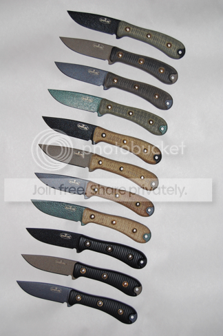

Here are some smaller 3.5" "rodent solution" models in SR101. Did I mention they're purdy and out of stock ;)

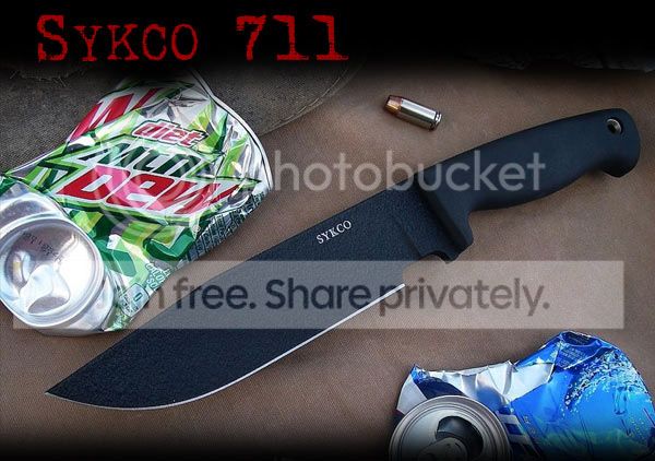

Off the top of my head, it sounds like Scrapyard has you covered with the 711 and 311 models. The only downside is that they do not come with sheaths. However, there are many excellent sheath-makers out there who could accommodate your every need. I would recommend Mashed Cat if you want high-quality kydex.
