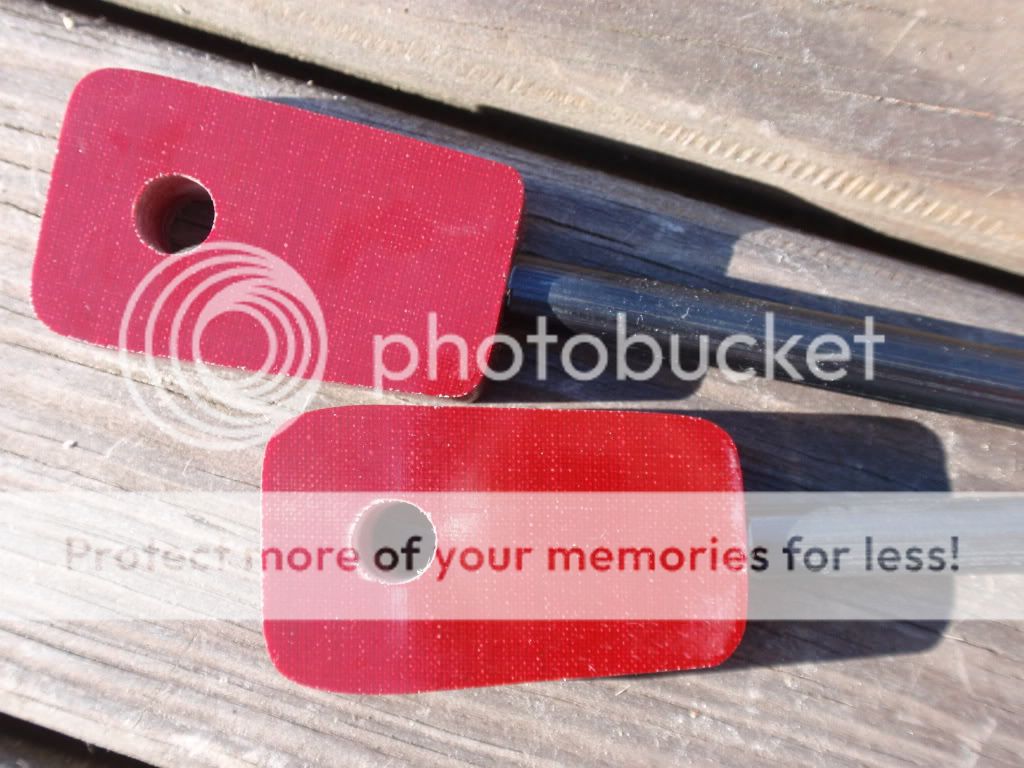

Had to put pants on two of the woodlores I finished, so I knocked up these sheaths this morning, and finished off some firesteels I been meaning to do as well.
Sheaths need dying yet but you get the idea.
The firesteels are burl cores I made and polished up, with 3/8" thick rods. The other two are red canvas micarta handles, with 1/4" thick rods.

The burl cores. Did you put a clear coating on them?
Put the holes on the red ones a bit lower, contour the sides, add a white pick guard and go for the Fender Dreadnaught look ;):D

Burl cores are polished, then soaked in danish oil for several hours, then dried thoroughly and coated several times with hard shellac.
Ill pass on the guitar pick bit though sorry hahahha:p
