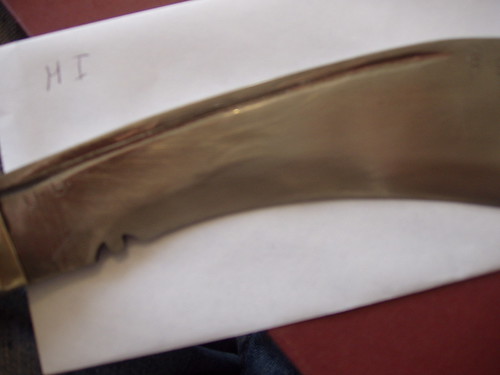

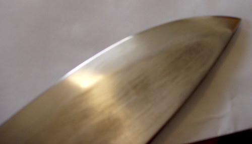

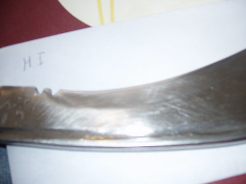

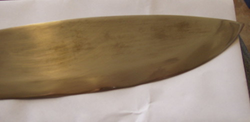

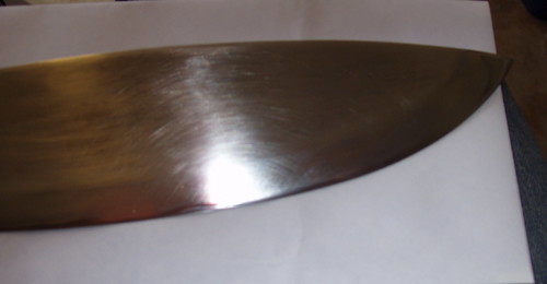

Long, long ago, on a thread that I have not been able to re-acquire in the archives, I got into a discussion about sharpening. I was about to try to convex the edge on my M43, and promised the folks I was talking to (whose names I no longer remember), that I would post some pics. As you may surmise, I forgot to do this.....in part because it took so long to get around to the sharpening task in question!:o
Well, I finally did it. In the few days before Christmas, I simply sat down, and re-sharpened both the kuk and the karda with my Altoid Kit, the task involving several hours' work, and using up a lot of 220-grit sandpaper!
So, here are the pics of what the edge looks like now (replacing the "microbevel" I'd gotten touched up at the sharpening shop):
So, my friends, wherever you are, my promise to you is fulfilled!
Merry Christmas.
I didn't do it all at once (two hours is about the most time that I can concentrate on anything), but I sat through 2 movies on DVD, just in the time it took to use up the 220-grit. Add in the time spent with the finer grits (which didn't take very long, by comparison, thanks to the convexity), I'd say that the entire process took at least 4 hours.
