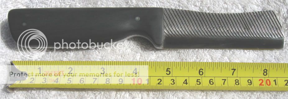

This is one i built as a special order for a customer with Ebony scales.

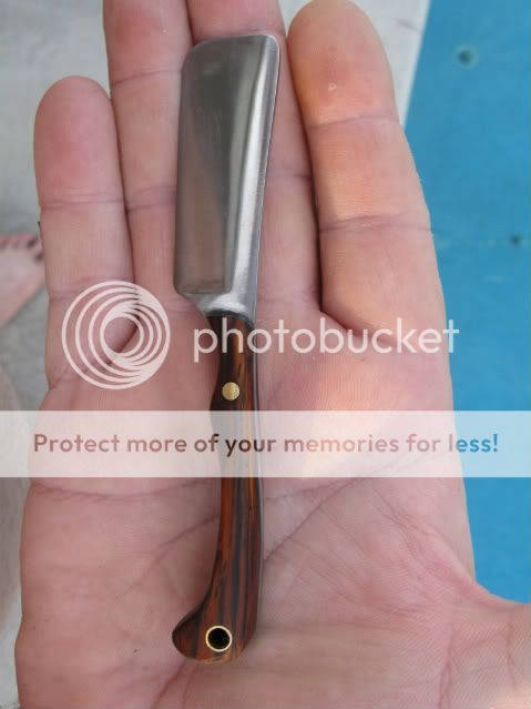

Here is a necker with matching cocobolo sheath and scales for a build off,the blade is 1095. I still need to put the final finish on the blade, its a 800grit belt finish in these pics.

I have seen that last one on another thread ( maybe even a different forum) and I really like it. How did you make the sheath for it? Two peices of wood or one peice drilled out?
David
I agree with an earlier post, the necker reminds me of a straight razor.
Very cool.
In fact the necker was started as a straight razor but i decided the blade would be to short and then the build off came along.
The sheath is 1 piece of wood drilled and carved out.

That top reminds of what people refer to as a "hack knife". They were designed to take a good bit of beating on the spine to hack through materials.
That last one looks like it would make a perfect cheese knife in the kitchen for both cutting and spreading cheese as well as some trimming of fat off cuts of meat. Is the front edge sharpened.

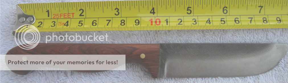

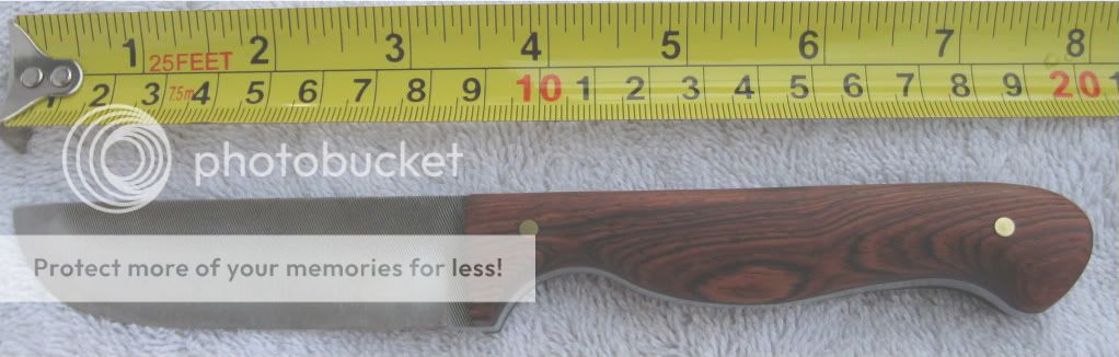

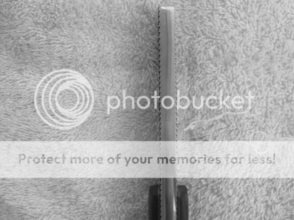

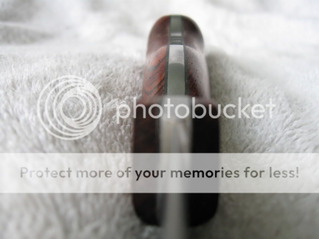

Dip kick the clutter outta your way an go to it.Here,s one thats a bit more traditional.
Made from a Nicholson file it,s 7 3/4 lenght 3/16thick and 15/16 wide with some gorgeous Honduran Rosewood scales and black liners.The width of the blade combined with the high grind made this one a TERRIFIC slicer !
I need to do the final finish on the blade and put her on the block.
I was trying to show the contour of the handle in the last pic.( Limited success)
Thanks for looking !
