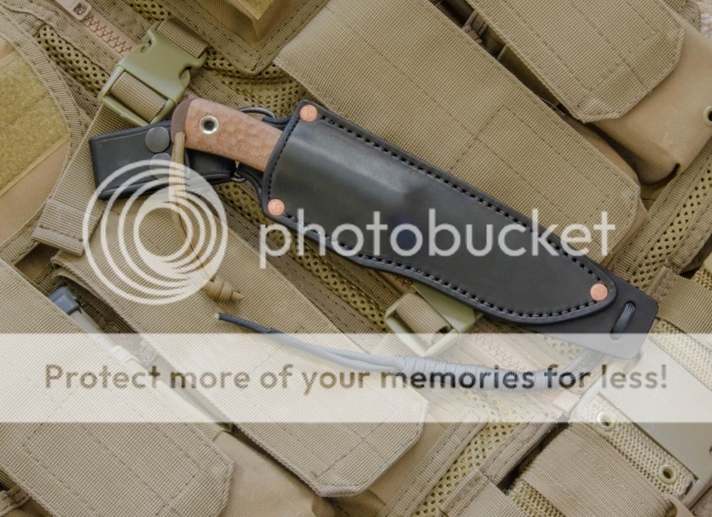

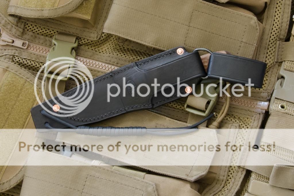

A couple custom leather dangler sheaths for the AMS
knifeleather
Knife/Sheath maker
Jul 14, 2012
424
As always,
- Made from 7-8oz Wickett & Craig leather with 2-3oz leather lining
- Fully lined interior
- Removable dangler loop - Lined as well
- Military grade, US made black hardware
- Copper rivets at high stress points
- 100% natural Beeswax/oil finish
- No rivets or belt loop stitching on inside of sheath
- Integral leg tie-down
What a sweet little knife!
thanks for looking,
Mark
Sheath with genuine Diamondback inlay
Standard sheath
Mark, again Brother you are on step. Man that Rattler Inlay is smoking awesome!!!

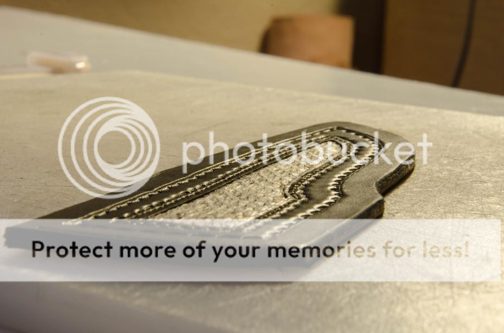

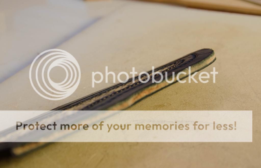

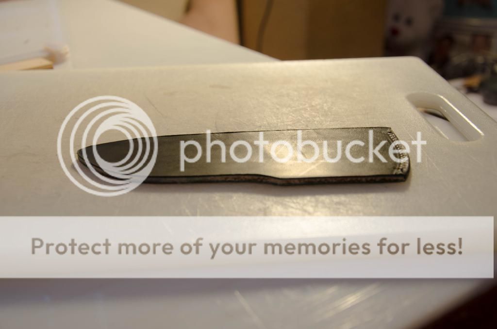

I've had several questions on what's behind the inlays. The inlays are backed by the full 9-10oz of leather, including the lining. The inlays are also raised so they sit relatively flush with top of leather.
Back side of top piece, lined
Edge showing thickness of leather behind inlay
Top showing raised inlay to sit flush with top of leather

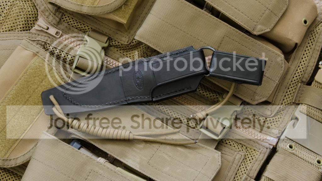

Example of a butterfly pouch, with dangler and firesteel, in chestnut.
thanks for looking!
