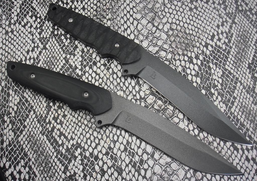

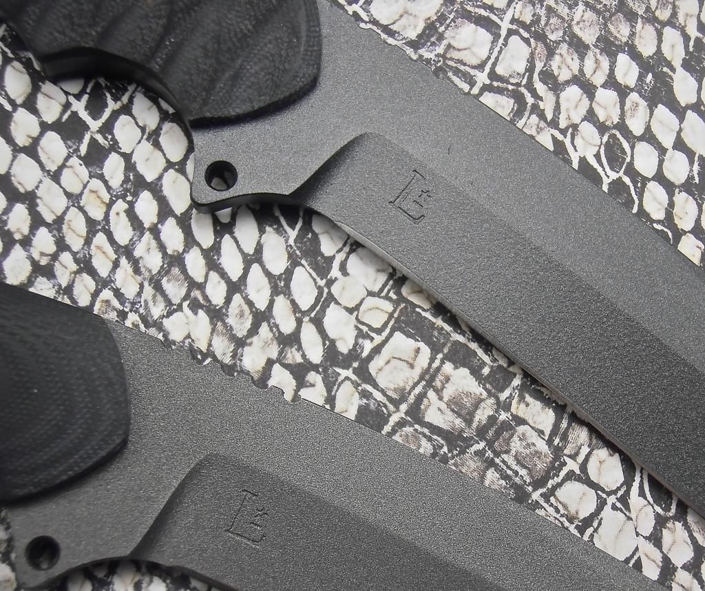

A-2 needs a little care after use. So here's a few I Cerakoted, I had tried some Socom Blue but didn't really like it. I added some Tungsten and it worked out better in my opinion. The top knife is 1/3 Tungsten, 2/3 Socom Blue, the bottom is straight Tungsten. They are made from 3/16" A-2 and are 11" OAL with a 5 1/2" blade, the scales are black G-10.
