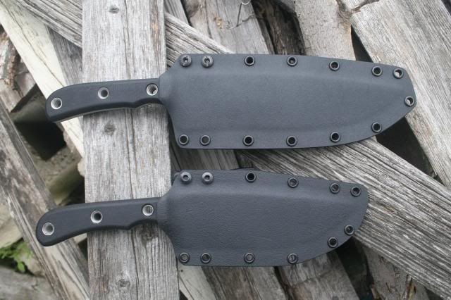

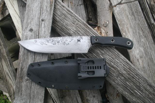

I had a couple of customers who are friends who wanted Benghazi Warfighters from me. The one had already gotten a War Chief tomahawk, and the other wanted the blade on his to be extra long.
Both were forged from 1/4" 5160, both got black canvas Micarta handle slabs.

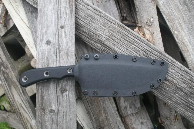

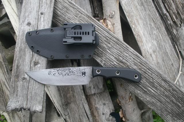

The regular-sized one is 11 1/8" overall with a 6 1/2" blade.
Both also got black Kydex sheaths with TekLoks.

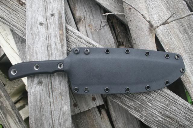

The oversized one has an overall length of 12 3/4" and a blade length of 8 1/8".

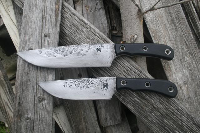

By way of comparison:

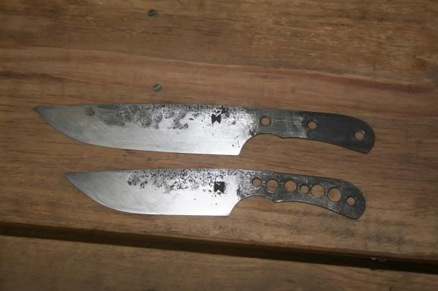

In spite of the significant difference in blade length, they both balance at about the same point at the choil. That's because I left out the lightening holes in the tang of the long one. The new owner commented on how lively it is, "feels like an extension of my hand."
