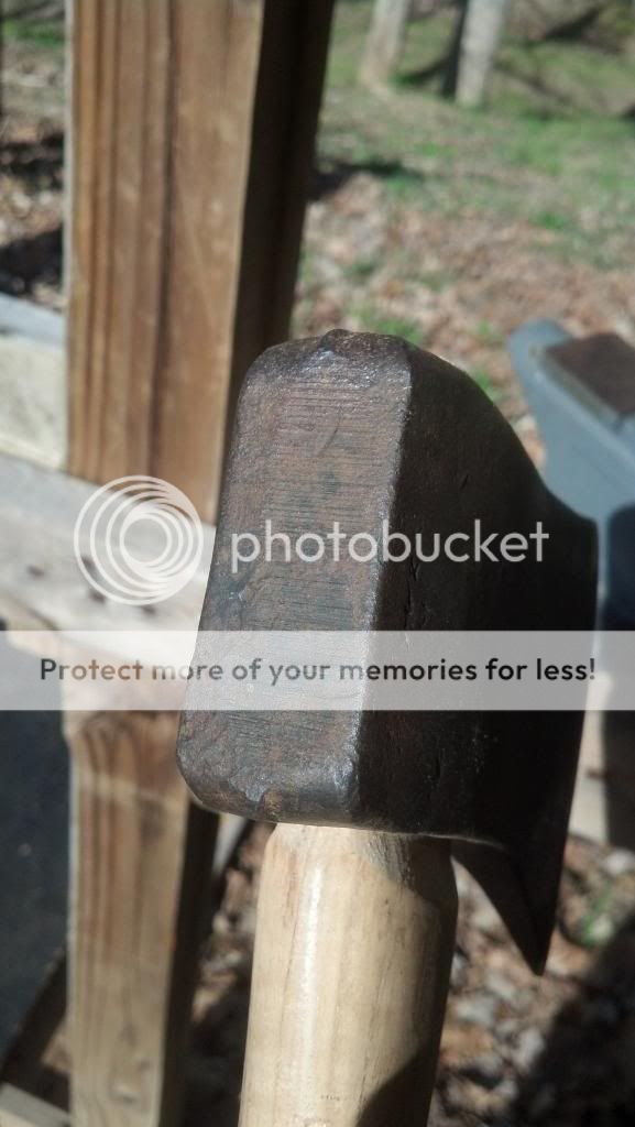

This guy is MUCH harder steel than the Kelly Axe in my other thread...
Also found this guy, the haft is broken and there is one tiny stamp that reads 3 1/2 M

I think what you have there is an old miner's axe. A miners axe was typically a full sized axe (3.5 pounds) hafted with a shorter handle, usually around 20". Made to work in tight spaces, they were expected to pull hammering duty and many have hardened polls just like a rafting axe. The corners of the poll were forged in to reduce chipping.
Yours still has a little chipping. But that's a good sign. If a poll is chipped rather than mushroomed then you know it is made of hardened steel. The body of such an axe is made of better, higher carbon steel than a common axe. That's a keeper.

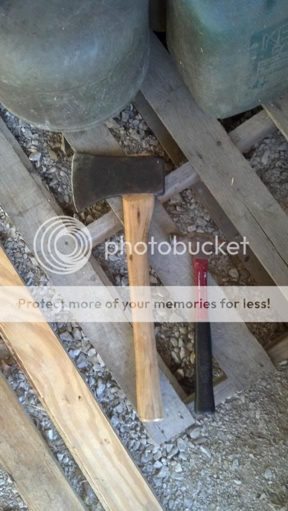

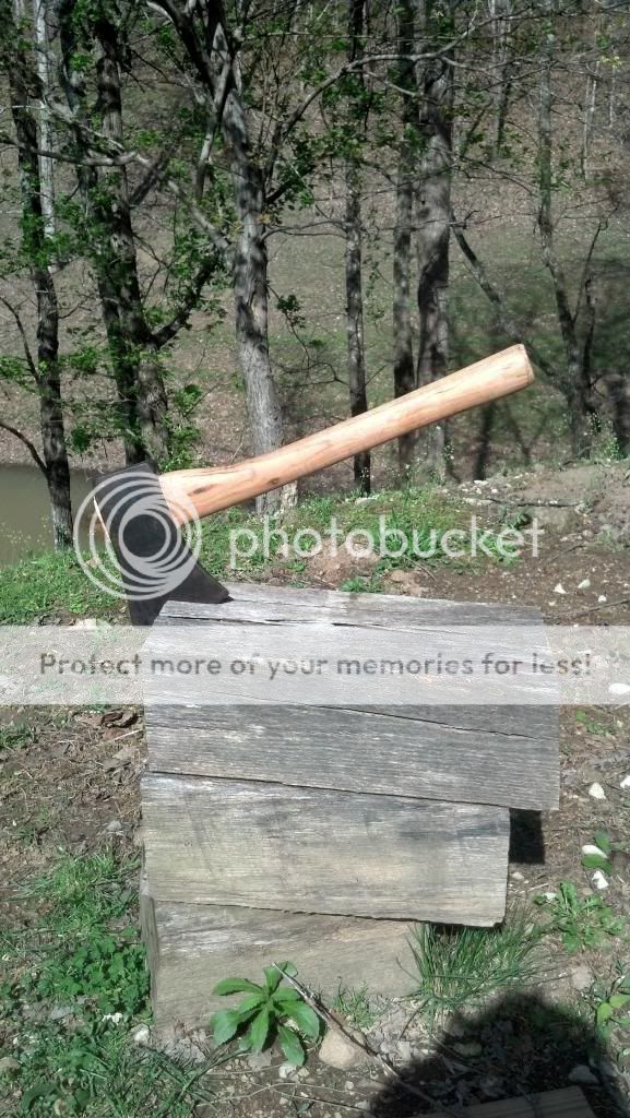

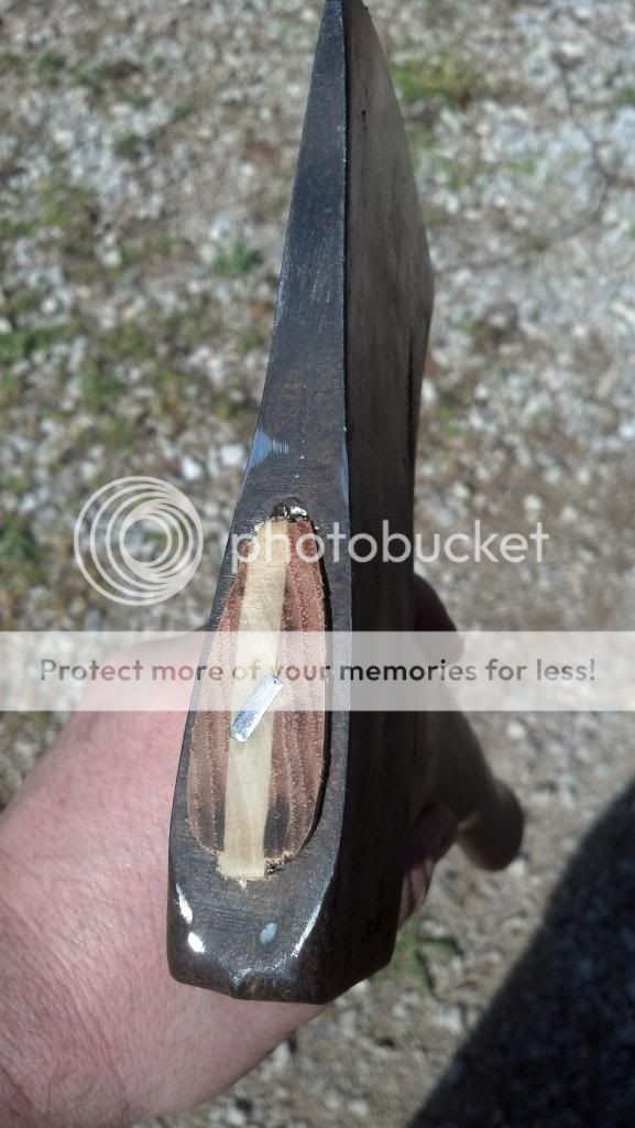

That's really interesting! I picked up a short haft the day I bought the "Kelly" axe and put it on that axe today after reading this :thumbup: I think it turned out ok for my second attempt at hanging an axe.
Hammer for scale
