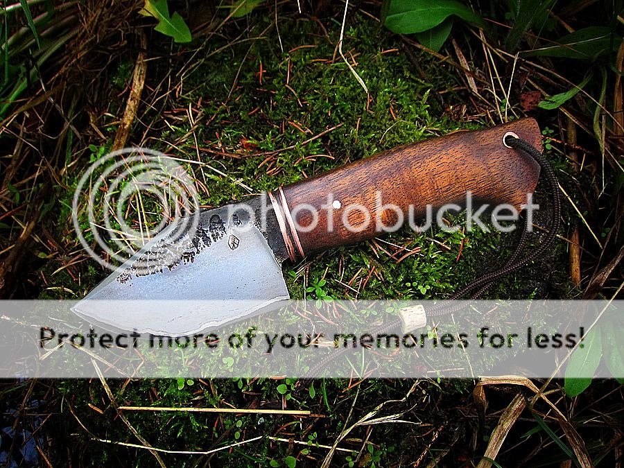

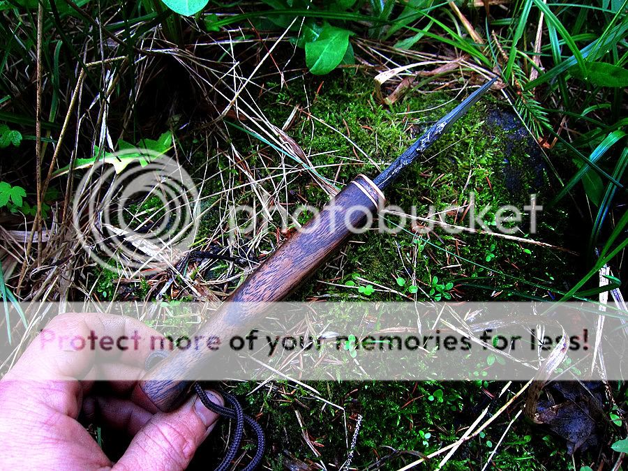

The first is another of my 'bowie-inspired skinners' in wrought iron/nickel/1080 san mai. The wrought iron is salvage from an old grain elevator built by Norwegian immigrants back in the 1800s.. in Northern, Wisconsin. I'm not sure if I've mentioned this before.. but for those not in the know... that nickel layer prevents carbon migration from the 1080 into the wrought iron. This can get bad enough to actually prevent the core from fully hardening. The nickel stops it dead.
Total length is 10" with 5" of that being handle. So this thing feels good to hold. I left weld from my wirefeed on the spine. Might as well not waste good blades steel
Curly Claro walnut?

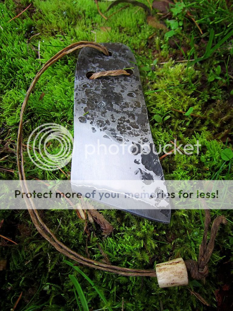

The second represents my first test billet of 416 stainless and 1080. I just did 2 layers to see how the weld would go.. and why not make a kiridashi? After grinding and heat treating it the first time, I had to throw it back in the forge to hammer some character into the weld line and to get some carbon migration pattern! Pretty boring without the hammer!
Anyway... This will now become a new medium for me (in full size knives)...
